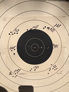

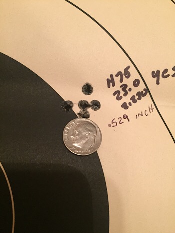

I did a seating depth test when I was running the H75HPBT match in my WOP Kreiger service rifle uppers with wylde chambers
I found as I seated the 75 shorter from 2.25-2.245-2.240-2.35 in LC or PSD brass and 23.2 8208 the groups became smaller and more round to where a dime covered a five shot group
Fired from prone with sling position
Of course your barrel timing or node may be different but the Nosler 77 CC reacts the same while the SMK77 and Lapua 77 doesn’t care.
20” service rifle barrels

Thanks, this is the kind of info I'm looking for. If you were working up a load with 75s for a Wylde chamber where would you start with seating depth? I understand that they are all individuals. I'm right at 2.25 with my load developement rounds. Is it bad to run a already seated bullet back through the seating die to bring the coal back?
