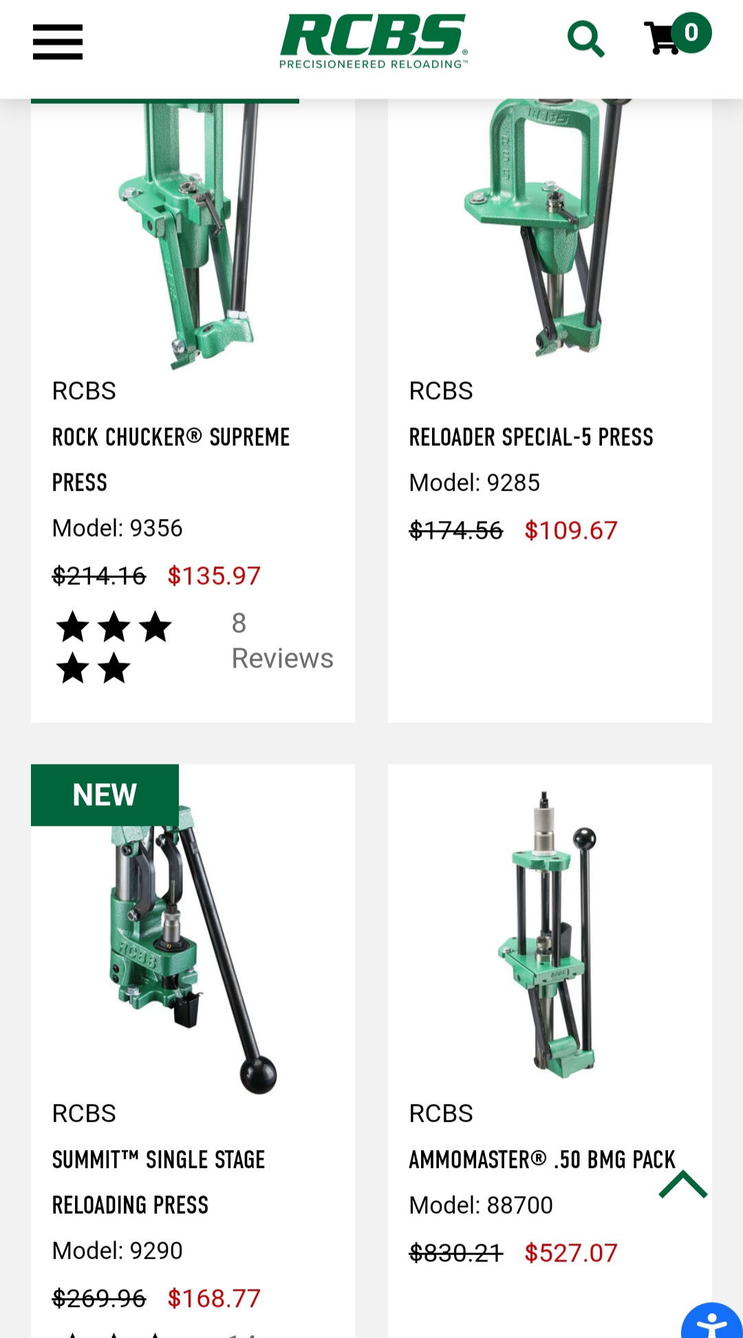

Are you a veteran or civil servant?
Sign up for the VIP program and save a minimum of 40% across the board to start.
If you PM the RCBS rep here I'm sure they'll give you a code to stack even more savings.
The VIP program also follows you throughout all the relative companies too (Bushnell Hoppes etc)

I am and I'm pretty sure the user agreement for the VIP program says you aren't supposed to disclose those prices.

Usually companies don't appreciate their discount program prices being posted. Not sure about RCBS but just say'n.
