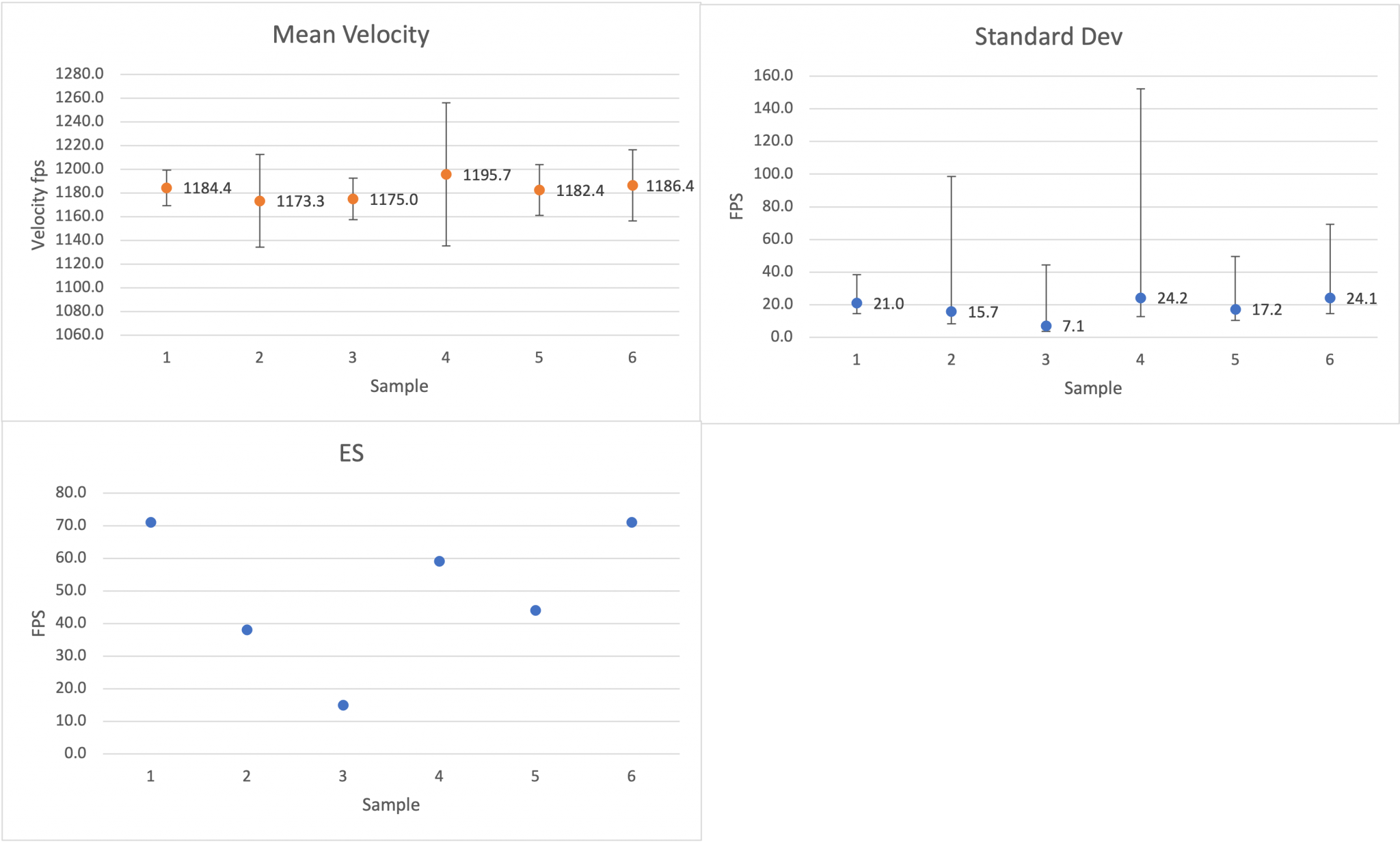

Also, a 5 shot group is likely not enough to know what the rifle/shooter is capable off. That fallacy just hasn’t been debated as much.
Reactions: Doom and Tokay444
@Ledzep will tell you your 5 shot group isn’t indicative of the true performance of that load also. Same as he will for 5 shot ES. The data he presents is also hard to argue.
Agreed, but in the search for something that shoots well once it leaves the barrel actual proof of where the bullet went down range is way more valuable to me than something that scanned one variable on its way out.
The problem w the 5-shot sd is when guys compare the mean and sd of one load to the mean sd of another. For that purpose the 5-shot group is (almost) worthless

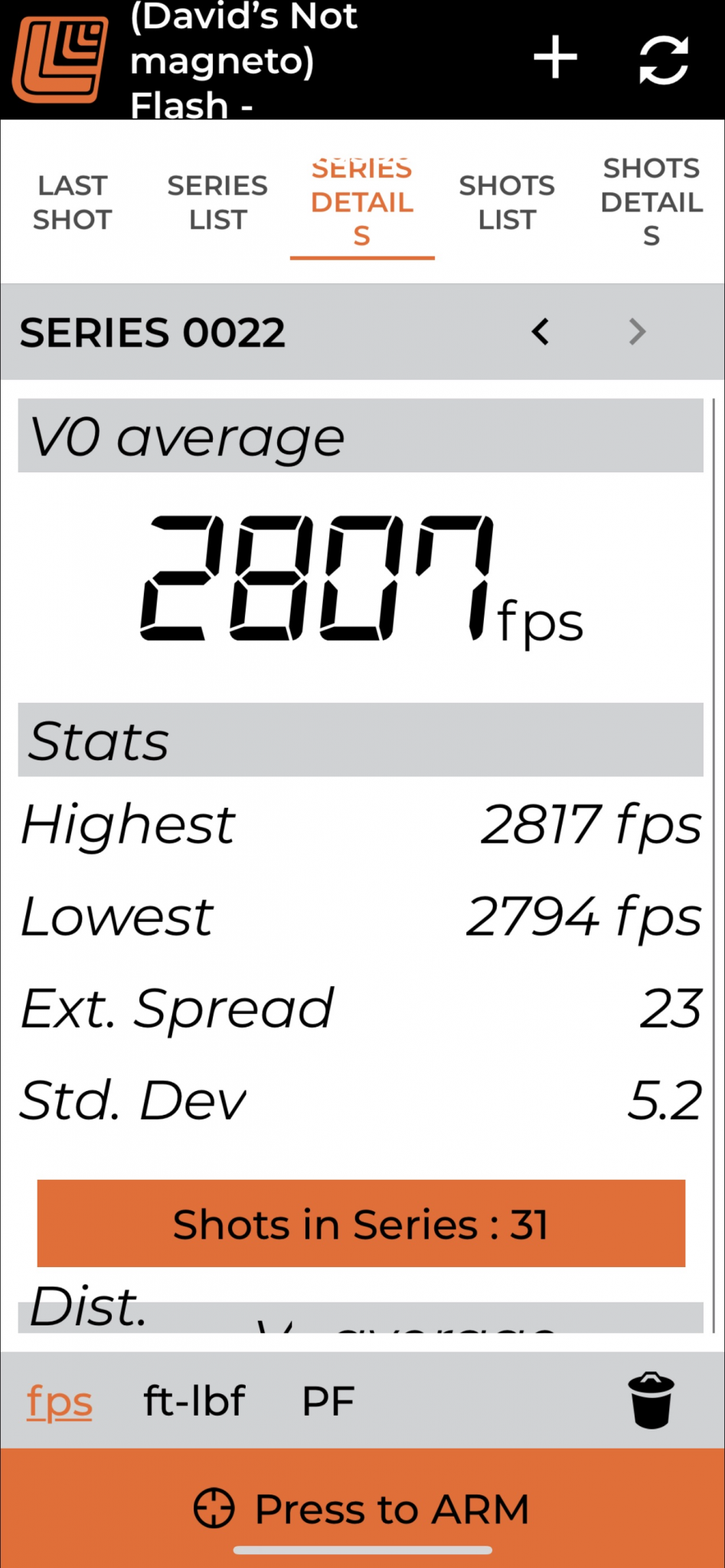

FWIW, I have taken two of my load development’s into the 20+ count range on the chrono, and true enough, I wasn’t sub 10 on the SD, and I never thought I would be based off a couple 5 round groups. I wasn’t far off tho, low teens if I remember right. Barrel temps came into play, and I do remember breaking the data down afterwards into segments. If I remember correctly, the SD numbers in the first part, when the barrel was cool looked awesome, then then they opened up considerably more towards the end as the barrel got hot. In essence one could argue that data was garbage too, bc I didn’t control my barrel temp & shooting pace correctly. Yet, the larger volume data still gave me relative useful info, just like the 5 shot group did. The 20 string told me something. It said I had a decent load with a cooler barrel, & I can expect my SDs to grow as my barrel heats up. Awesome experiment. I loved it.
I was never saying don’t use large volumes of data over small. Ultimately, I do agree that larger volumes of data are statistically more accurate. I also agree with other folks that it’s really important for newbies like me to realize and make the distinction that what we get on a few 5 shot groups is NOT our real SDs. Does that mean I’m gonna shoot 20rounds or more at each varying incremental charge weights during load development? Probably not. Maybe one day I’ll change my process into doing that, but for now, I’ll stick to small volumes of data to save components & barrel life.
I do think I will adopt someone’s suggestion to only use the Chrono in the beginning to verify I’m in the velocity area I’m wanting to load for, but then leave the Chrono out of the picture entirely until I’m at final load verification at the end. This would be to gather data over practical shooting pace to plug into my ballistics app. At that time, 20 rounds or more will be ideal if I’m understanding correctly, and I have no problem with doing that.

I recently put together some data to demonstrate just how small sample sizes can be terribly misleading, and to show how what the data actually predicts.
Understand that 3,5, and even 10 round sample statistics, average and standard deviation, tell you about the samples, not the larger population of rounds that are of interest. Predicting what the sample says about a larger population is a probability problem and requires more analysis that just the mean and standard deviation spit out about the Sample (chronograph data).
The graphs below show an analysis of some chronograph data taken recently. Its Blazer 22LR 40gr ammunition and real data. Sample one is a ten shot group with a average velocity of 1184 fps and a standard deviation of 21 fps. ES was 71. Samples 2, 3, and 4 are random 3 shot samples of the ten rounds of group 1. Samples 5 and 6 are rand 5 shot groups of data from group 1. No data is duplicated in the three different three shot or in the two five shot groups. These are not the only combinations of data possible. The bars reference the confidence intervals for each set of data to give a 95% probability that the true velocity and standard deviation lies within that range. You can see that the three shot groups were not nearly representative of the population they came from and that the confidence intervals are quite large. The five shot groups are closer to the average but the range for the standard deviation are still larger than the population.
So what about the ten shot group? That ten shot group predicts that the true average velocity of a larger population of shots from that lot of ammunition should be between 1170 and 1200 fps with 95% confidence and the standard deviation is between 14.5 and 38.4 fps.
One thing I discovered a when I first started using a chronograph. I can develop a load without it, but even with it I can't develop a load without the target!

Barrel temp typically only affects things if the round is left in the chamber and is allowed to heat up. Otherwise, it doesn’t do much. This is a common misconception people have and lead them to not realize their process is off a little.
As an example, these were shot as fast as I could run them:
That 31 round sample gives a 95% confidence interval for velocity of 2805.1 to 2808.9 fps and a SD confidence interval of 4.2 to 7 fps. Pretty darn good!
