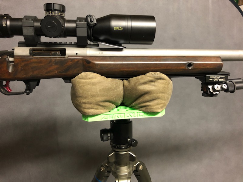

At request, photo of my kit.
I don't recommend running this for a shooter new to the venue. Get a bino LRF or buy my Steiner 10x50 LRF so I can get the Sig's or Vortex.

Using a plate on your tripod is fast and easy. A bag with git lite makes for an extremely lightweight rig that you can put binos or rifles on.
