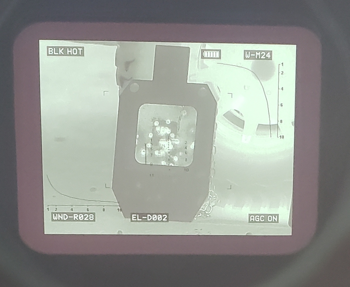

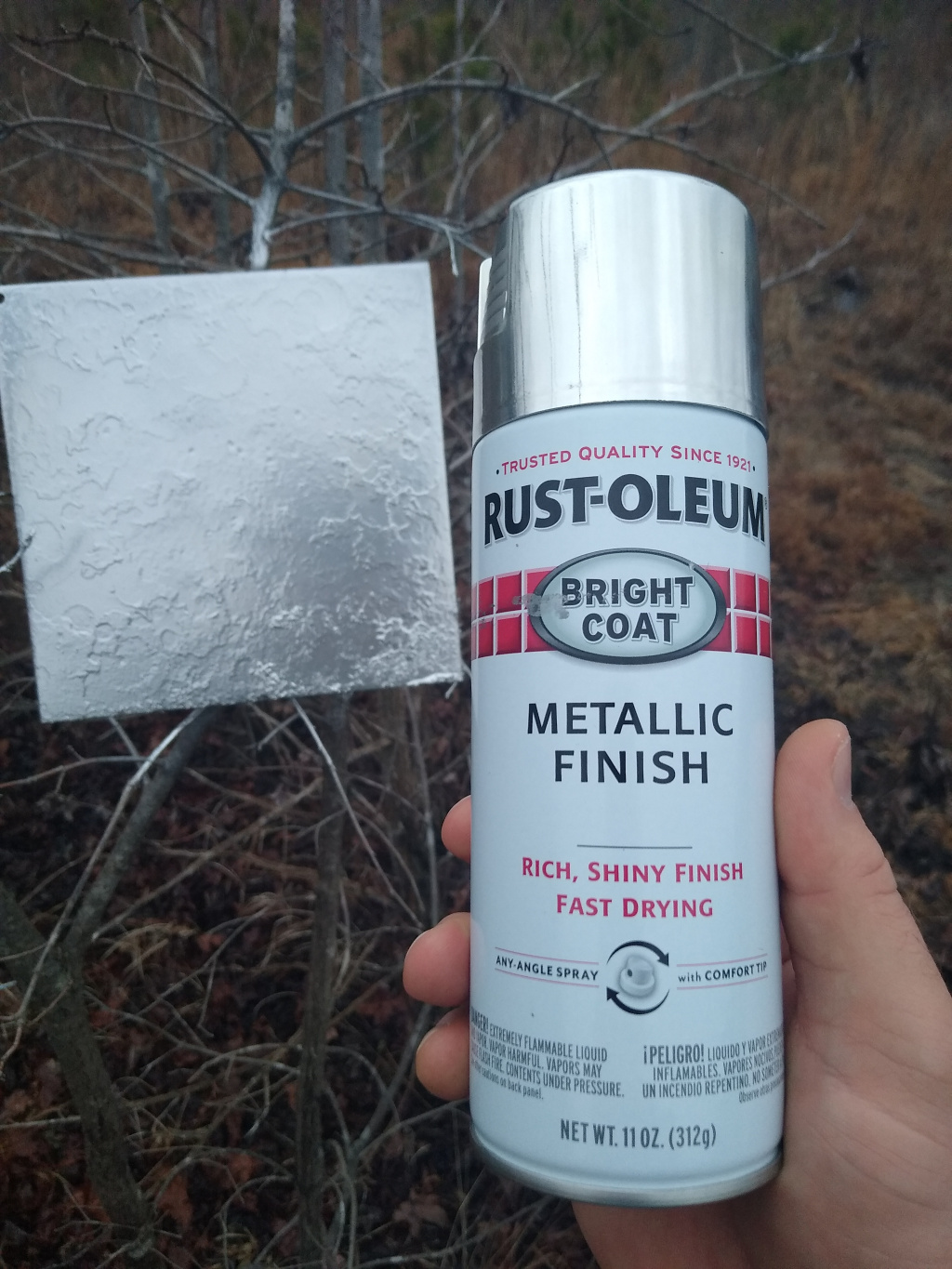

Swapped one of my thermal units back to a gun it was on before, and punched in what I had written down as my zero.
I normally use reflective tape on cardboard to zero my thermals
But.... I had a can of paint... And started thinking...
Wonder what this will look like...
Been raining all day and conditions suck, but I could verify zero no problem
Man nice! Something I figured out one day with a similar 'hmmmm'. I hunt white hot, but went to black hot and used tin foil? Oh man even in middle of the day it stands out like a white boy in Harlem. Nice work on the paint will pass this on to some fellers

I did angle it back to reflect the sky the same way I do my cardboard

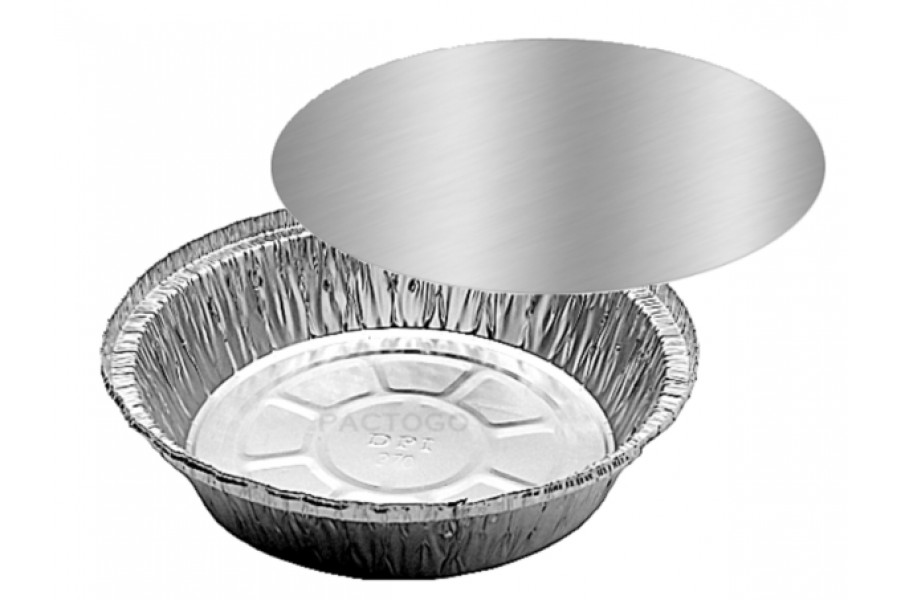

I was using hot hands when I first started and thought there had to be something better. We were having takeout one night and I noticed the lid to the containers are aluminum foil on the bottom and perfect circles in various sizes. Started saving them since then and they work great!

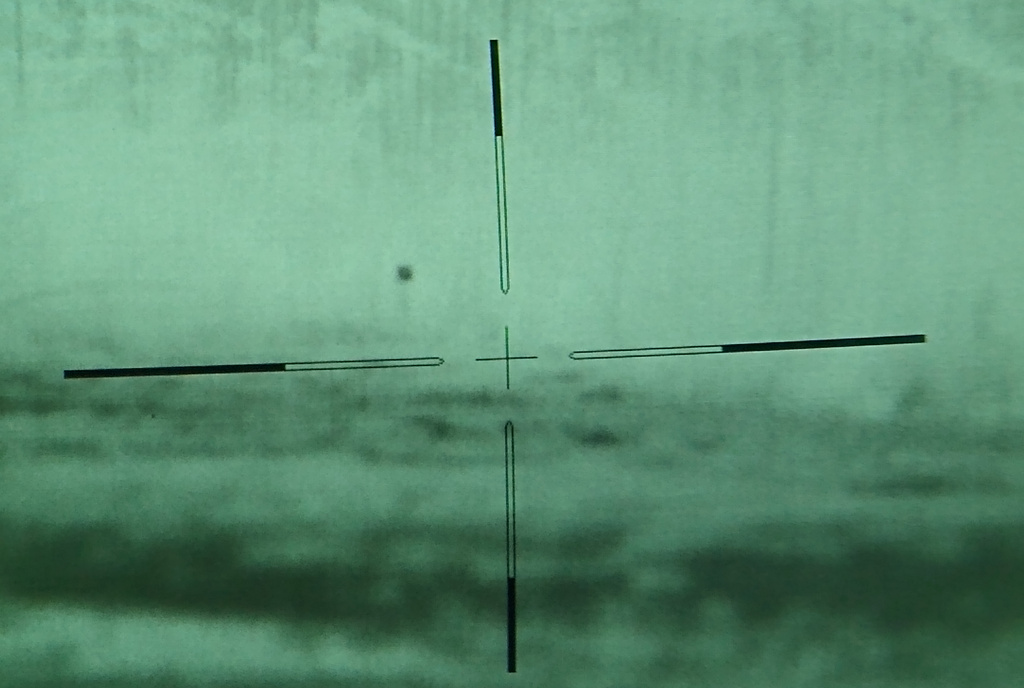

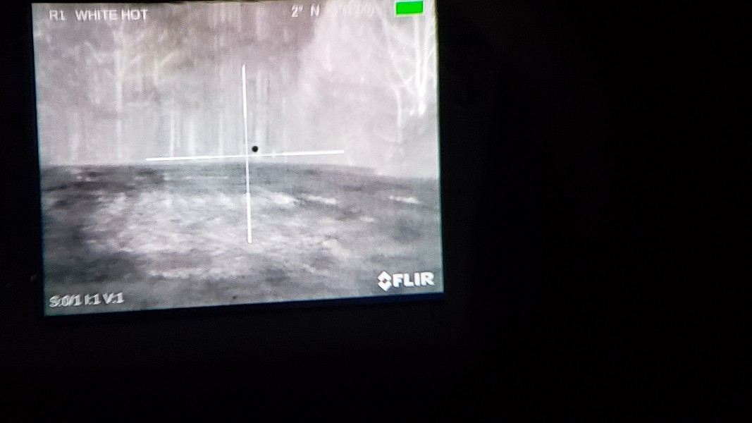

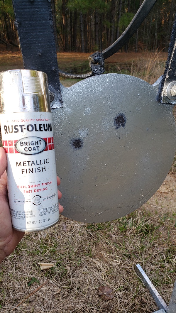

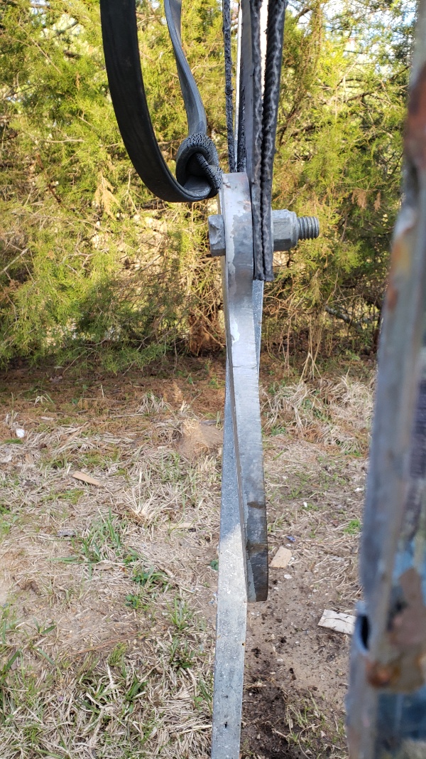

I do this regularly. I leave an 18x18 plate at 100 yds at all times, and I tag it for zero confirmation or to rezero after swapping optics all the time. I’ve zeroed a handful of thermals this way, and confirm zero every time head out to kill this way.
I can definitely say it works. I hang my steel from the front and it angles it up enough to reflect the cold sky. Works way into the night as well. Was around 11pm when I left and I could still see it at 300. The pics here are from my phone at 100. I should have took pics with the unit! I'm thinking it was around 50 degrees that night and dropping.
P.S. I never join discussions here but yall have helped me, so I'm posting this, hopefully it will help others. So yep I'm a creeper....
