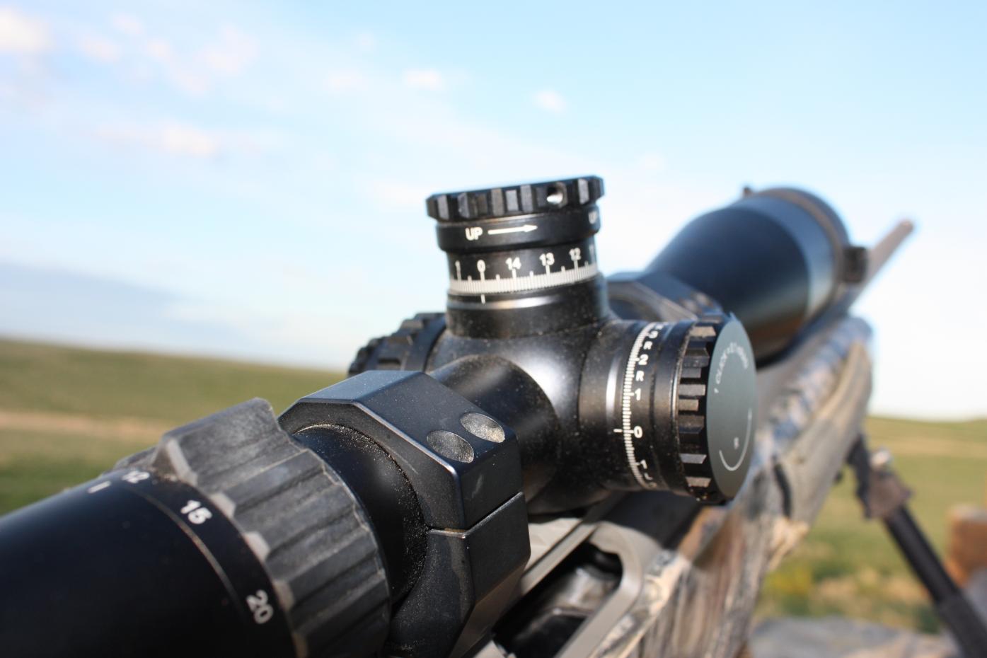

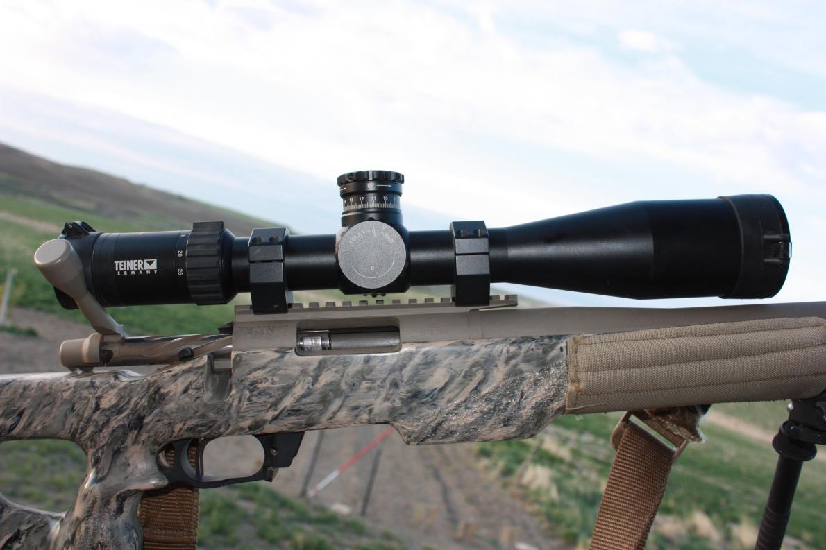

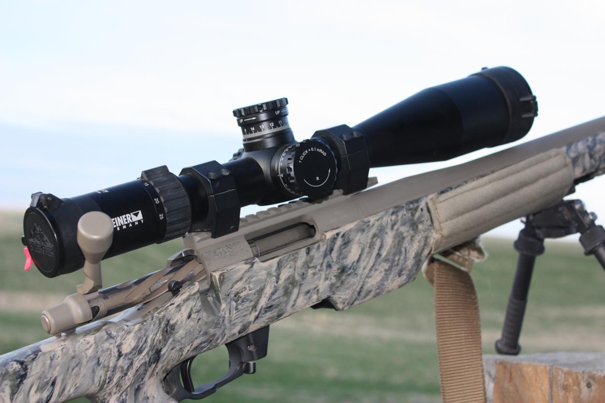

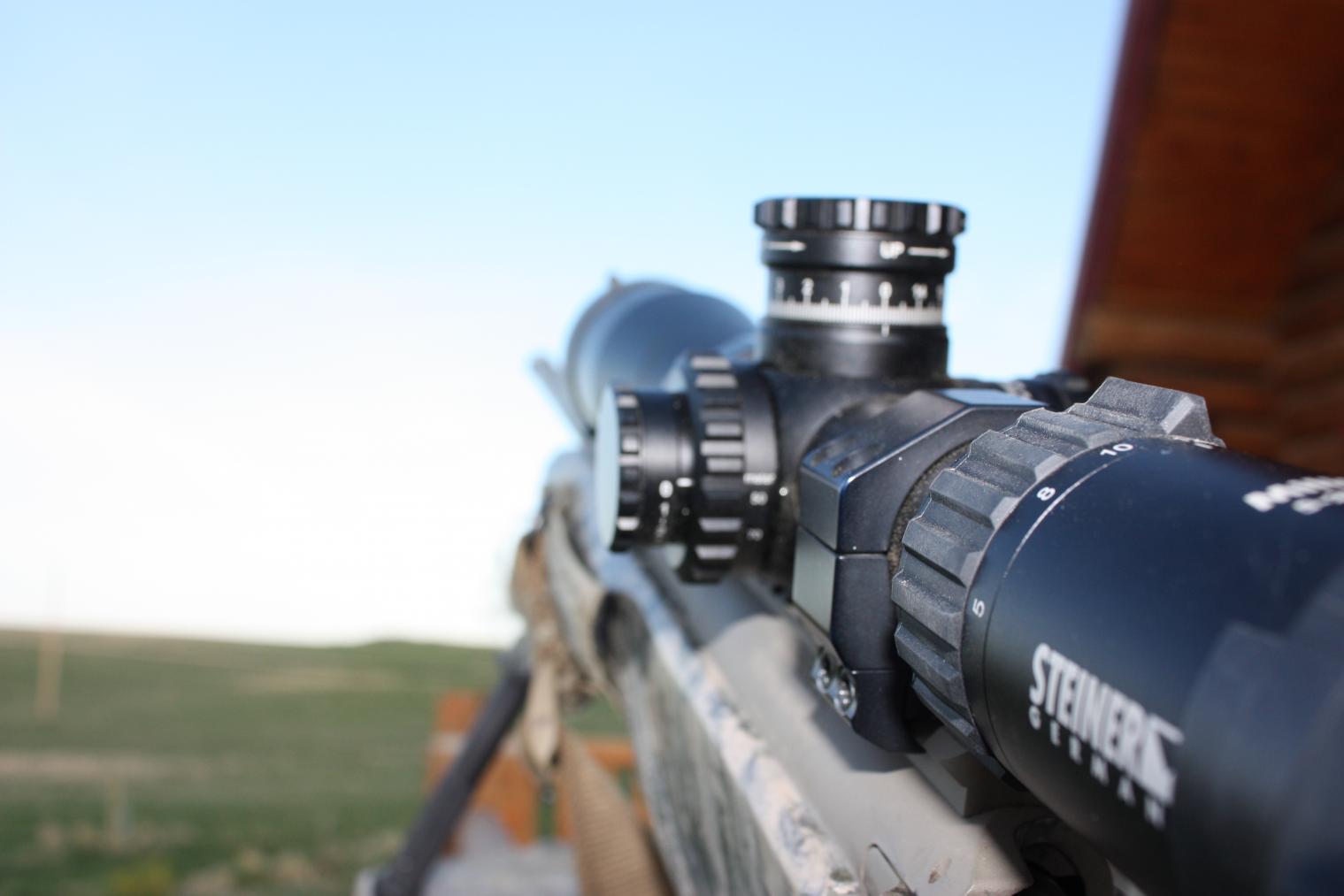

Dont have any pics of it do ya? Id like to see what it looks like in a set of seekins lows with that contour.

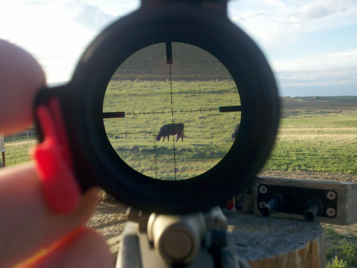

IMG_3864.jpgIMG_3863.jpgIMG_3866.jpg2013-05-15_06-30-09_96.jpgIMG_3860.jpgUntil the AM
What was the range on the cow? I'm guessing around 475 for a 2 mil hold. I'd suggest moving the crosshairs to the left a touch more though, just behind the shoulder ya know. ;) See ya at the cup!
Geb
Deceiving... She is a yearling and actually at 660:p... See you next week!

When I first looked all I saw was the inside shot of the reticle. I did not see the thumbnails. Then I saw the quote above and I thought damn my eyes are so bad I might as well stop shooting and start selling what I have. Then I saw the thumb nails.
You are doing something right OP. Steiner and a log cabin.
Steiner 5-25
Low Seekins rings
Med palma bbl
Sent from my iPhone using Tapatalk
I always do the math before looking down to the answer.
I had 666.48 yards as I estimated Elsie was 48" high and used 2.0MIL
