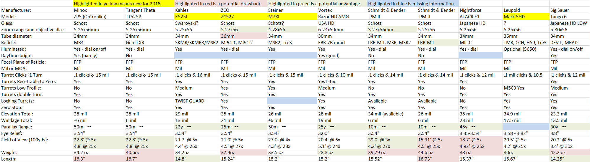

    Here's a comparison chart of a bunch of long range scopes (not all, but a bunch)
    The M7Xi is already available in the European markets. I just received my one two weeks ago. Last weekend I had been able to comapre it side by side with Kahles K525 and the PM 5-25x56. All three scopes are on an excellent optical level, however the M7Xi slightly better on the optical performance. Very clear picture with an extremely good contrast. Together with the very short design and the 7x magnifications, it is really a game changer. In my opinion the best scope on the market!!!

    As an example, in that chart wjm308 posted the TT525P on their own website shows a total adjustment range of 30mils, with a working elevation of 28 mils, meaning on a 20moa mount you'd only have ~21mils available: so why have a turret limiter in the first place?
