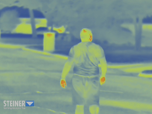

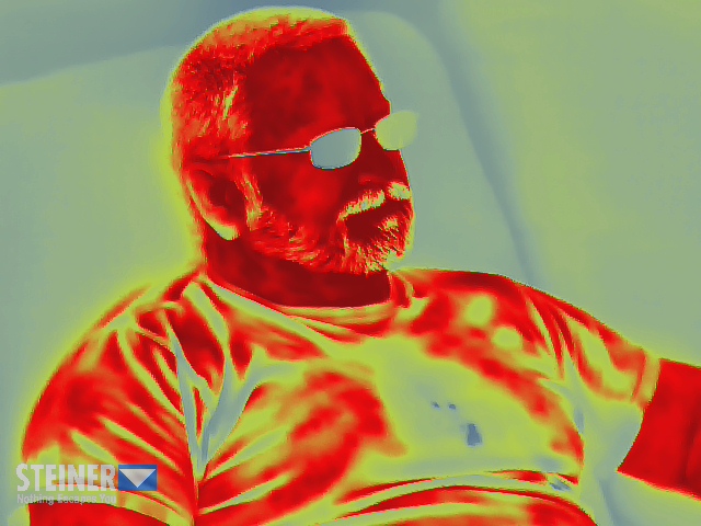

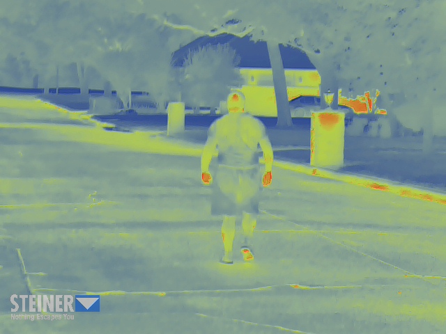

Howdy,

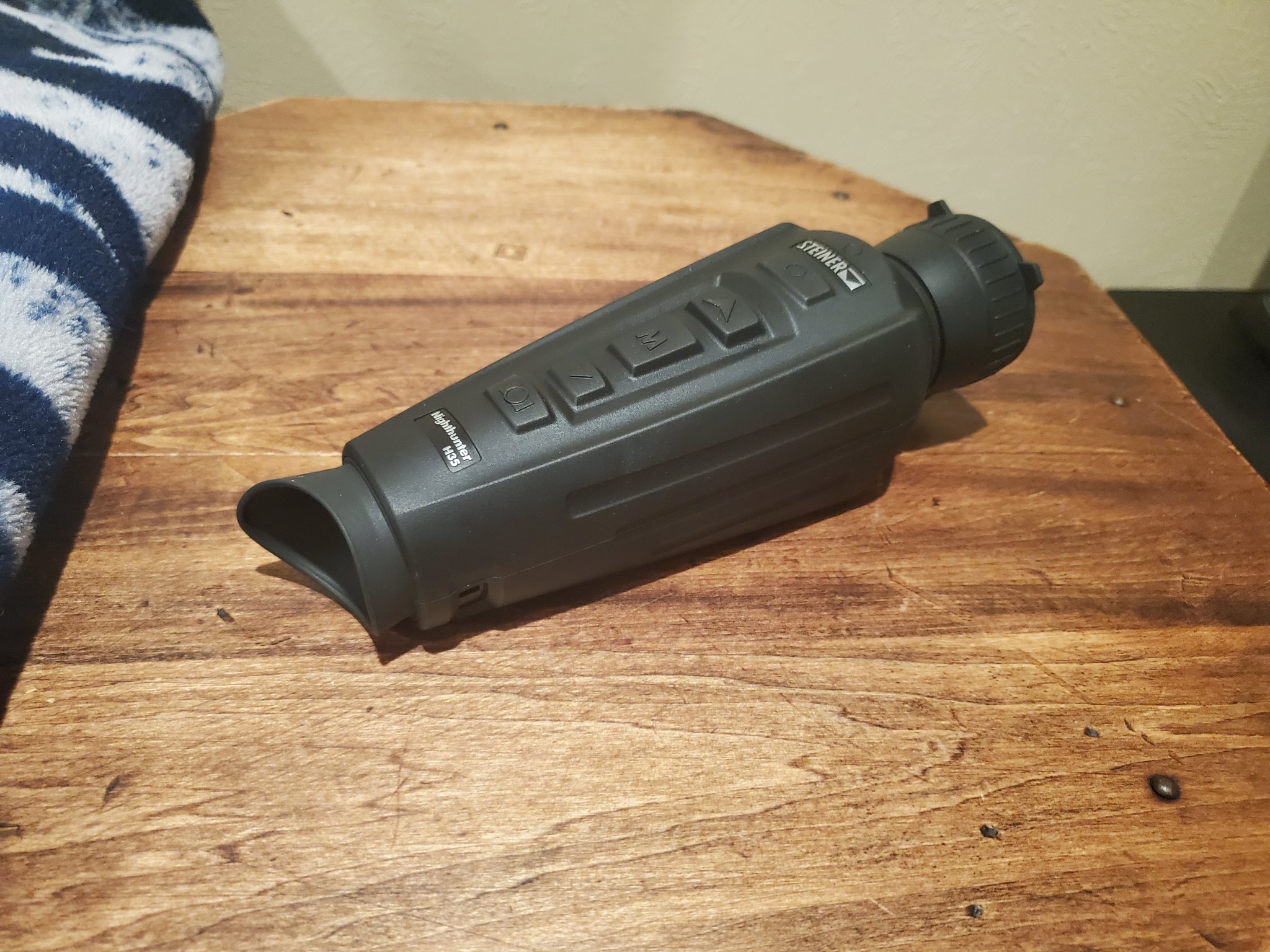

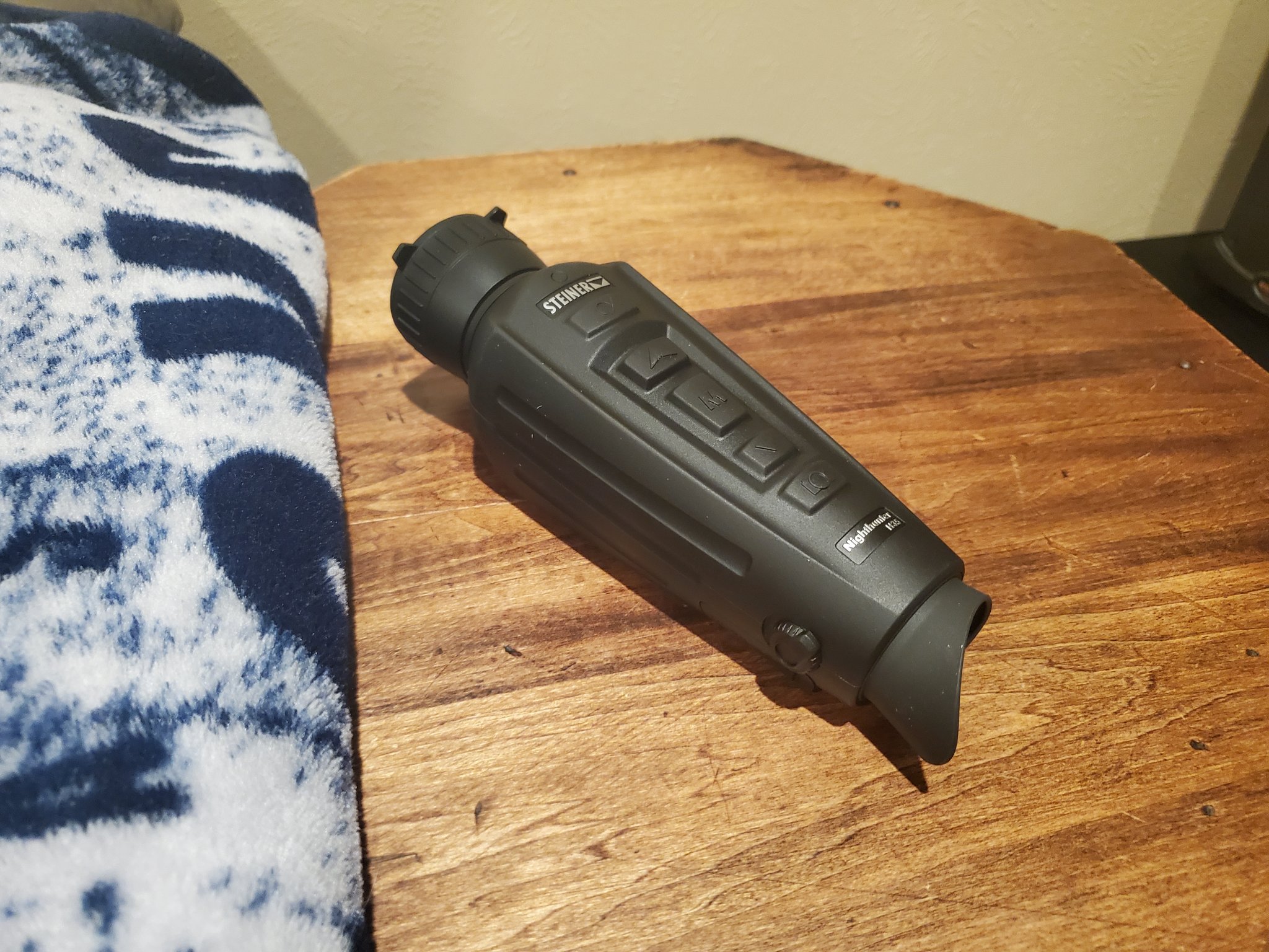

This is my first impression of Steiner's first commercial thermal device. I have attached the spec sheet but BLUF:
MSRP: $4,799.99
MAP: $3,999.99
SH Price: PM Me
Availability: One week to two weeks max
IRay 12 Micron 640
1280x960 LCOS display
Native 2.04x with up to 16x digital zoom
Manual Focus
Same bluetooth interface as Pulsar
Tripod Mount
Waterproof
Similar to DLSS upscaling from 640 to 1280 display
Insanely smooth picture
AUTO NUC (Internal Shutter)
Con: Records at 640 so the photos and videos won't do this monocular justice
Pro: The clip on that will come out in a couple months is going to be amazing as it has the same specs and internals

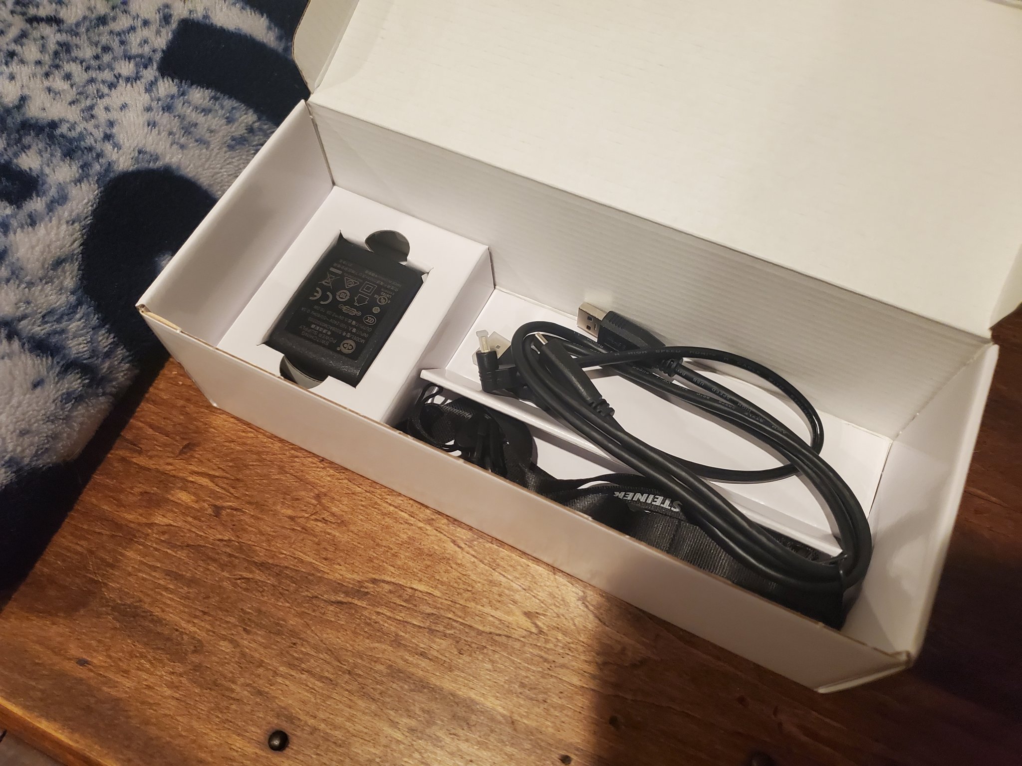

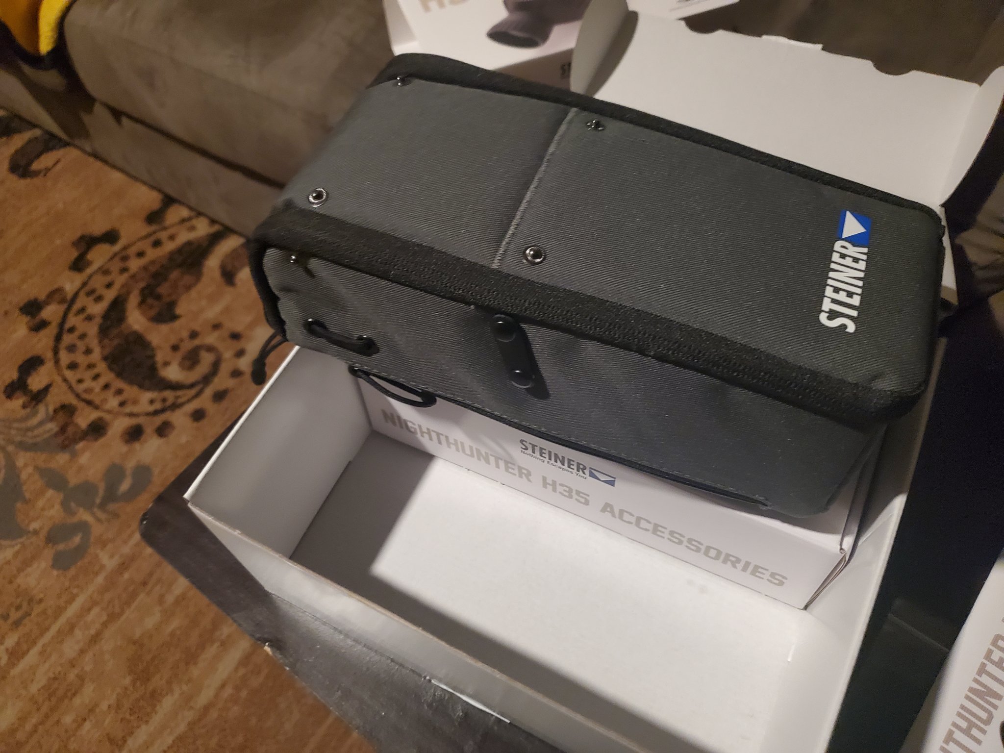

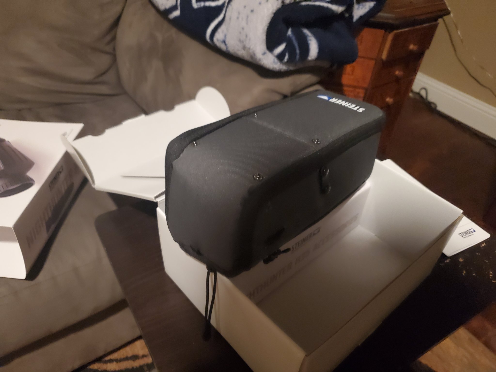

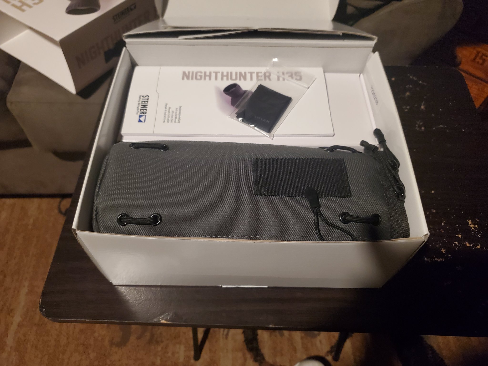

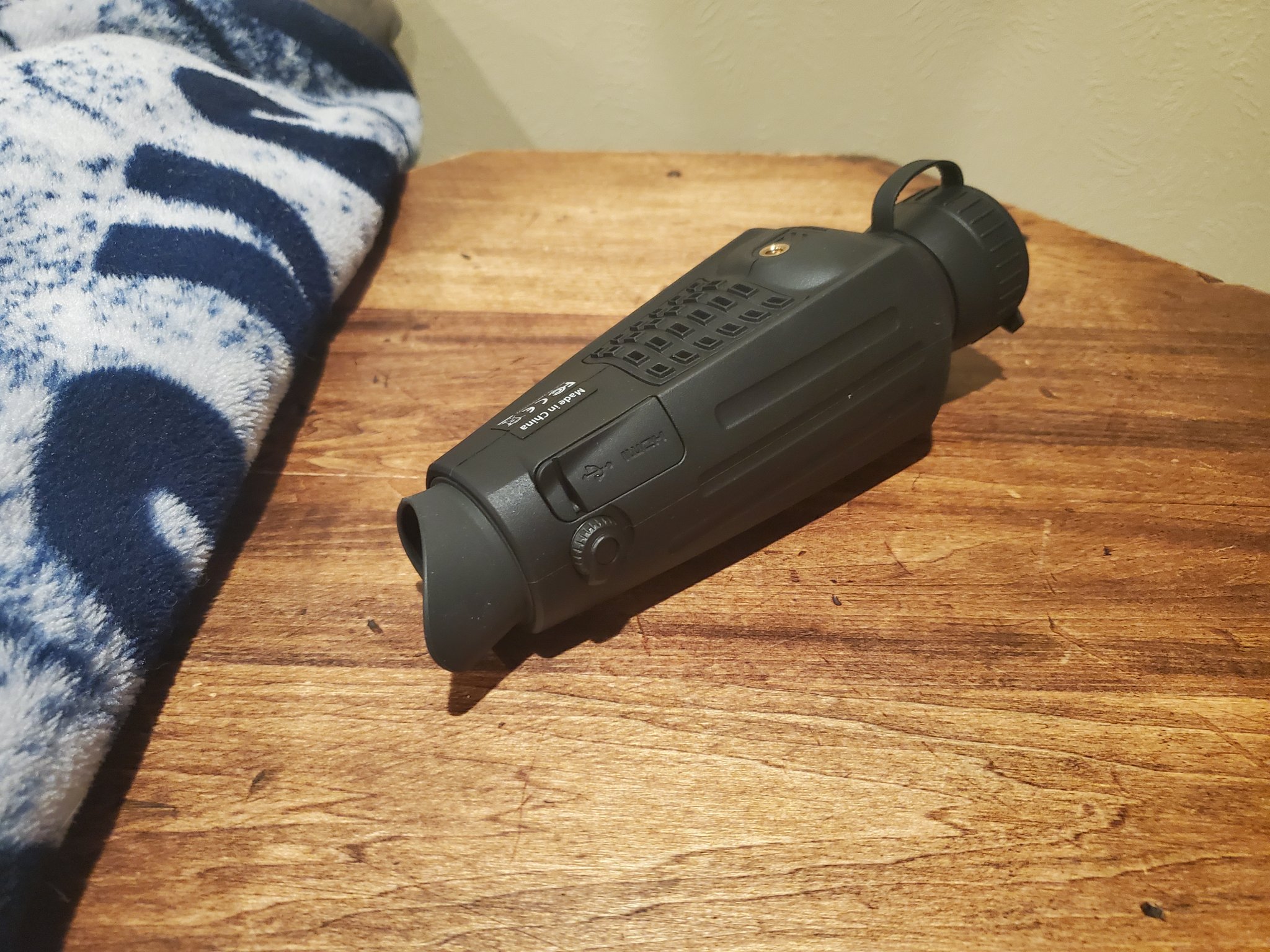

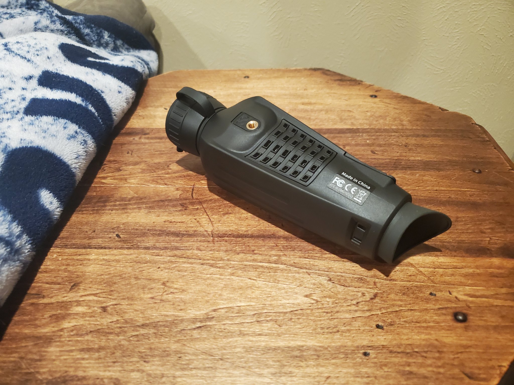

It includes a very nice case with a sling, and the means to wear it around your neck when patrolling, scanning, etc. It includes both the power cord and an HDMI output. You could hook with Handheld thermal on a tripod, connect it to a battery pack, and use the wifi app to view the picture from a distance away (haven't tested how far yet). It includes international power adapters and includes no ITAR warnings. My first thought is that Steiner is new to the thermal game and didn't think of including the ITAR warning like they do with the DBALs. I will clarify when I have time if it is in fact ITAR restricted. Overall, awesome handheld for the price, durable, waterproof, lots of features, and inexpensive compared to what was on the market last year.

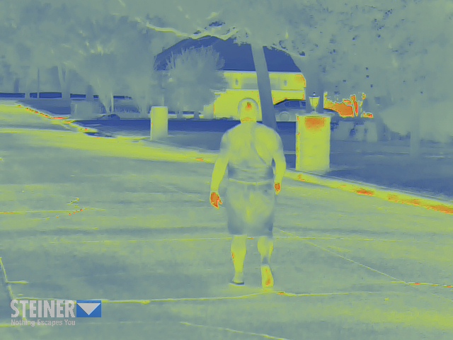

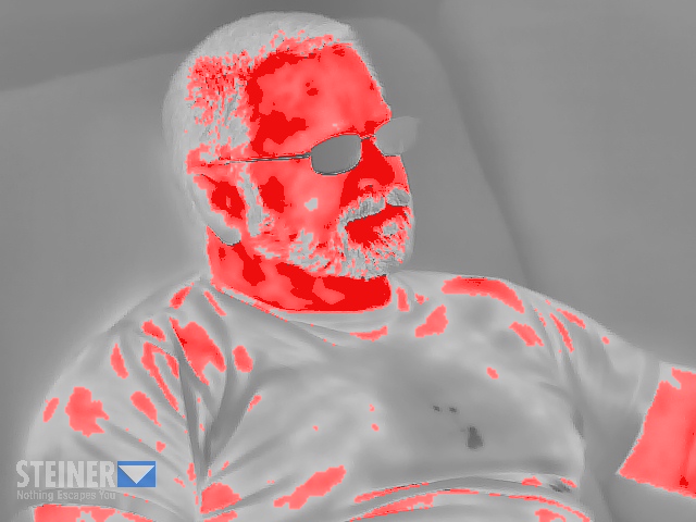

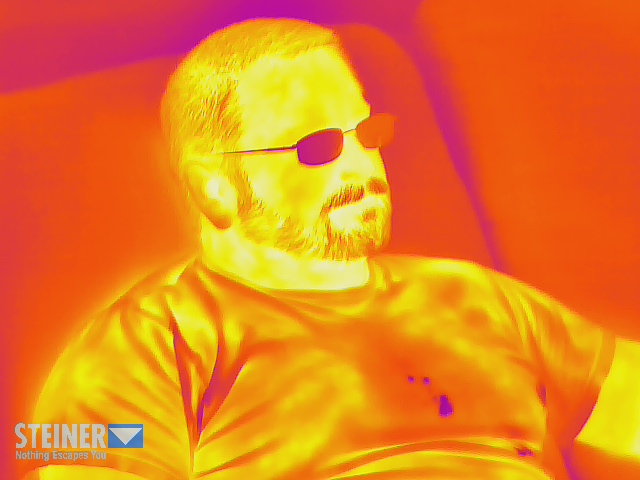

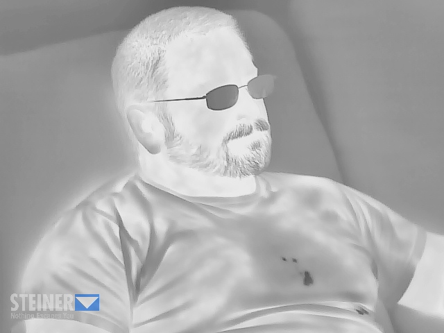

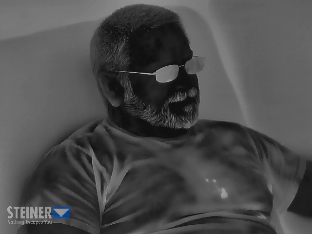

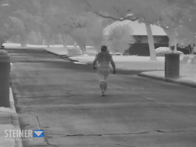

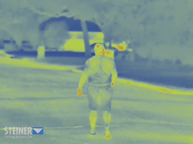

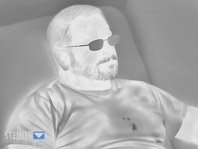

All of the videos are taken maxed out at 16x, the stop sign is approximately 200 yards away. The photos are taken with the native 2.04x. I apologize for the shaky hands, it does have a tripod mount on the bottom but I do not have a tripod yet. Again, the video is much better than these photos and videos as this is pre-AI upscaling. Let me know if yall have any questions.
