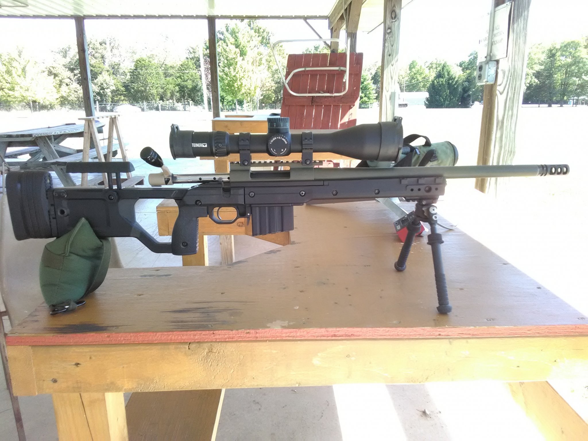

Finally took my P4xi that I bought from the PX from @screaminweasil to the range yesterday. I loved it. Shot from 300-800. Tracking was great and glass was very good. I did get a blister from trying to break in that elevation turret when I first got the thing. I gave it a thorough night of twisting and it feels great now. I like the glass in my Cronus a little better but the P4xi is definitely a keeper. I can't think of a better scope for the price you can get these.

Yeah, after 1100 rounds my first Steiner Elevation Turret seems pretty nicely broken in. No need for a locking turret on that model:p
I agree, I like my Cronus BTR glass better, but for the coin, those Steiners are worth every penny! Glad you like the scope

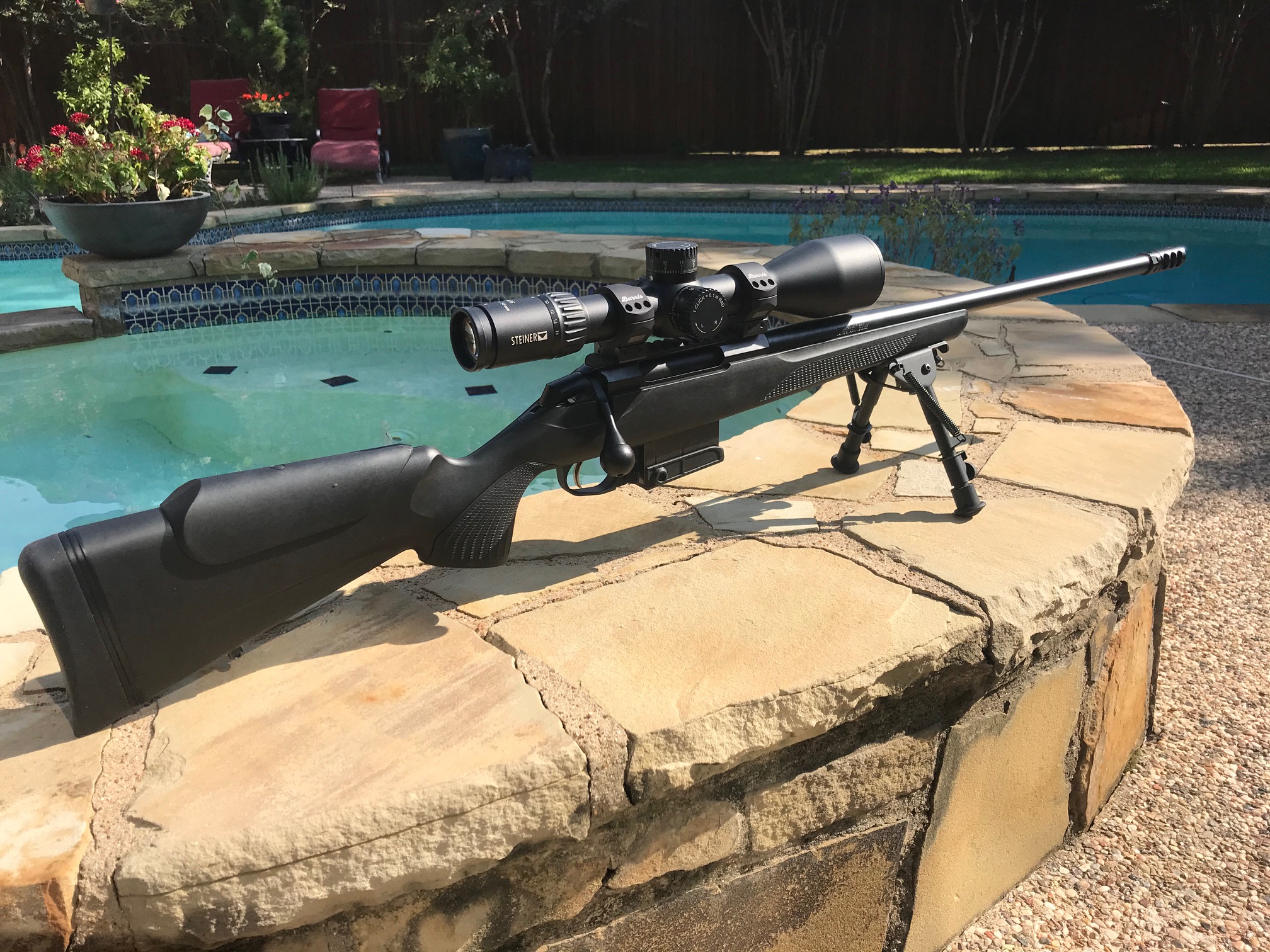

I went with the Burris XTR signature 1 inch rings. Seem to work well with 20 moa inserts on a Tikka CTR with factory 0 moa mount.
can someone please measure outside objective diameter , trying to make sure rings aren't too low
