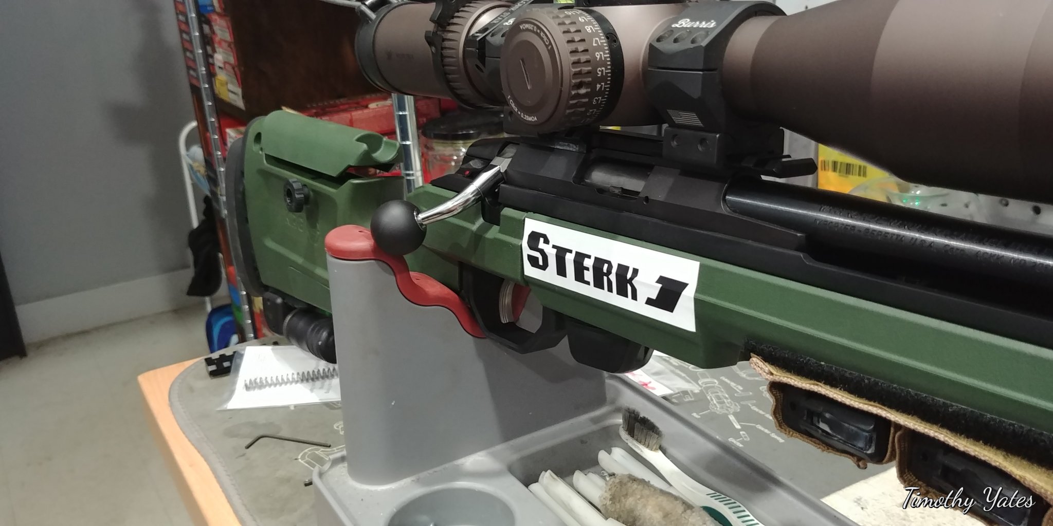

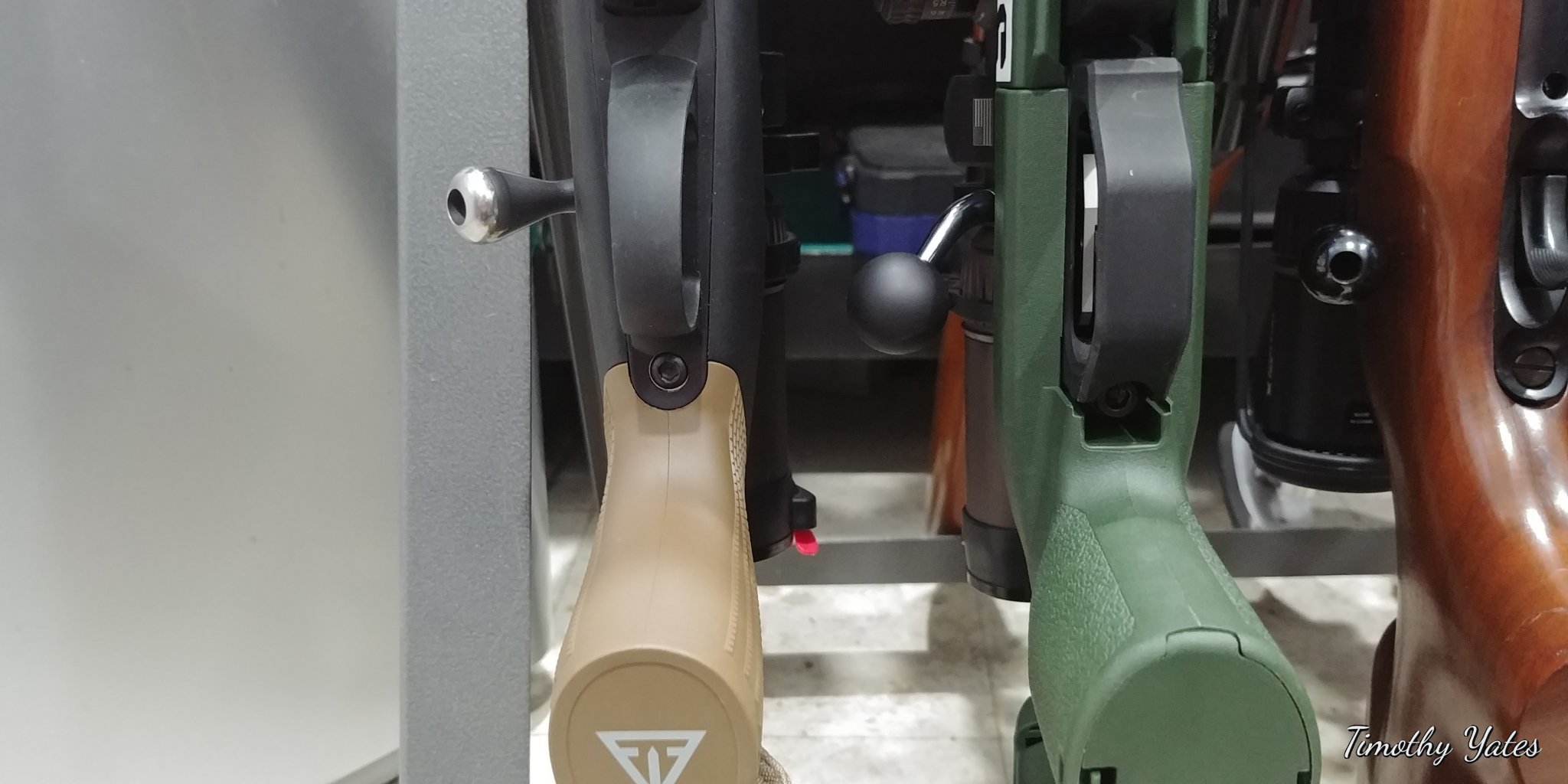

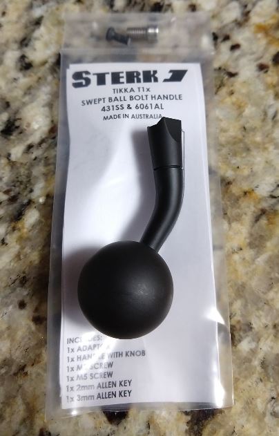

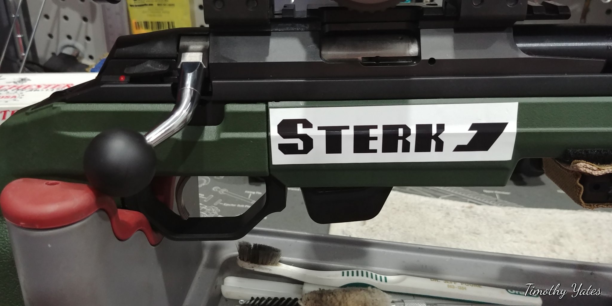

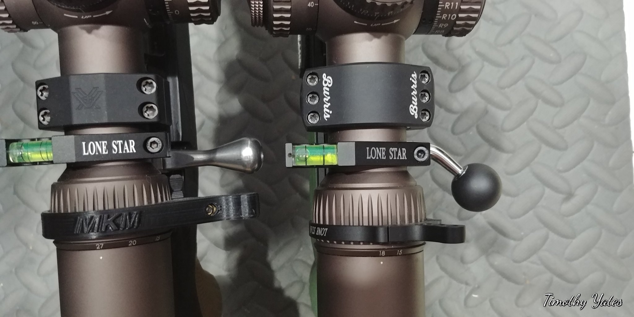

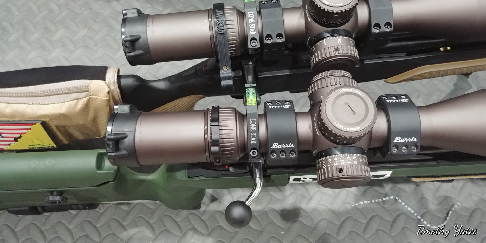

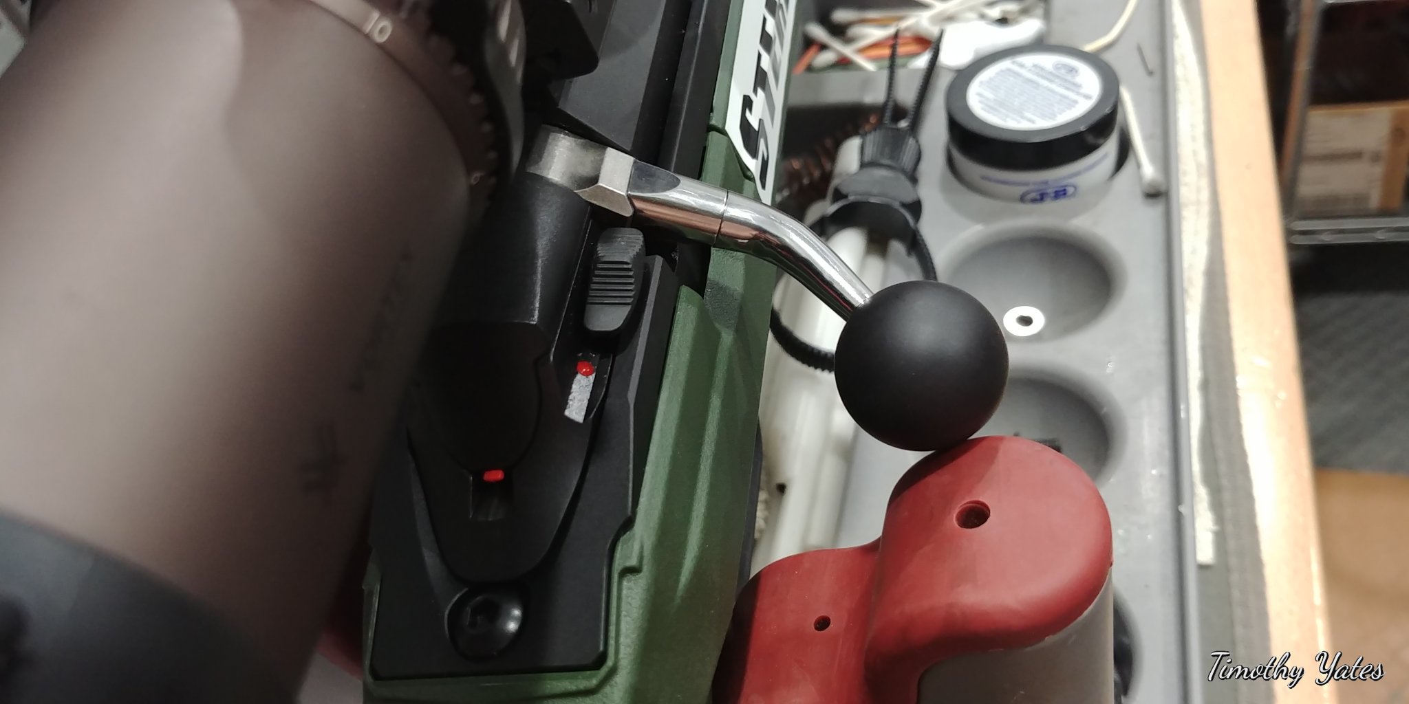

    Ok guys, finally got the Sterk handle today and mounted. Attached are some photos compared to the factory bolt handle. Just doing a lot of dry runs the handle feels just like I imagined. There is very little hand movement to cycle the bolt now. Depending on how good you are I would say it's possible to cycle the bolt twice as fast. The photos show the position and it's right below your pointer finger and thumb.

    I was a little so-so on this too, but your side-by-side photos show a good bit of difference. I'll put this on the must do list.

    Yeah, I was skeptical in the beginning. It wasn't until one day I was shooting the Tikka and then right after that I shot my Anschutz with its factory swept bolt handle and that's when I notice a significant decrease in hand movement needed to cycle the bolt.

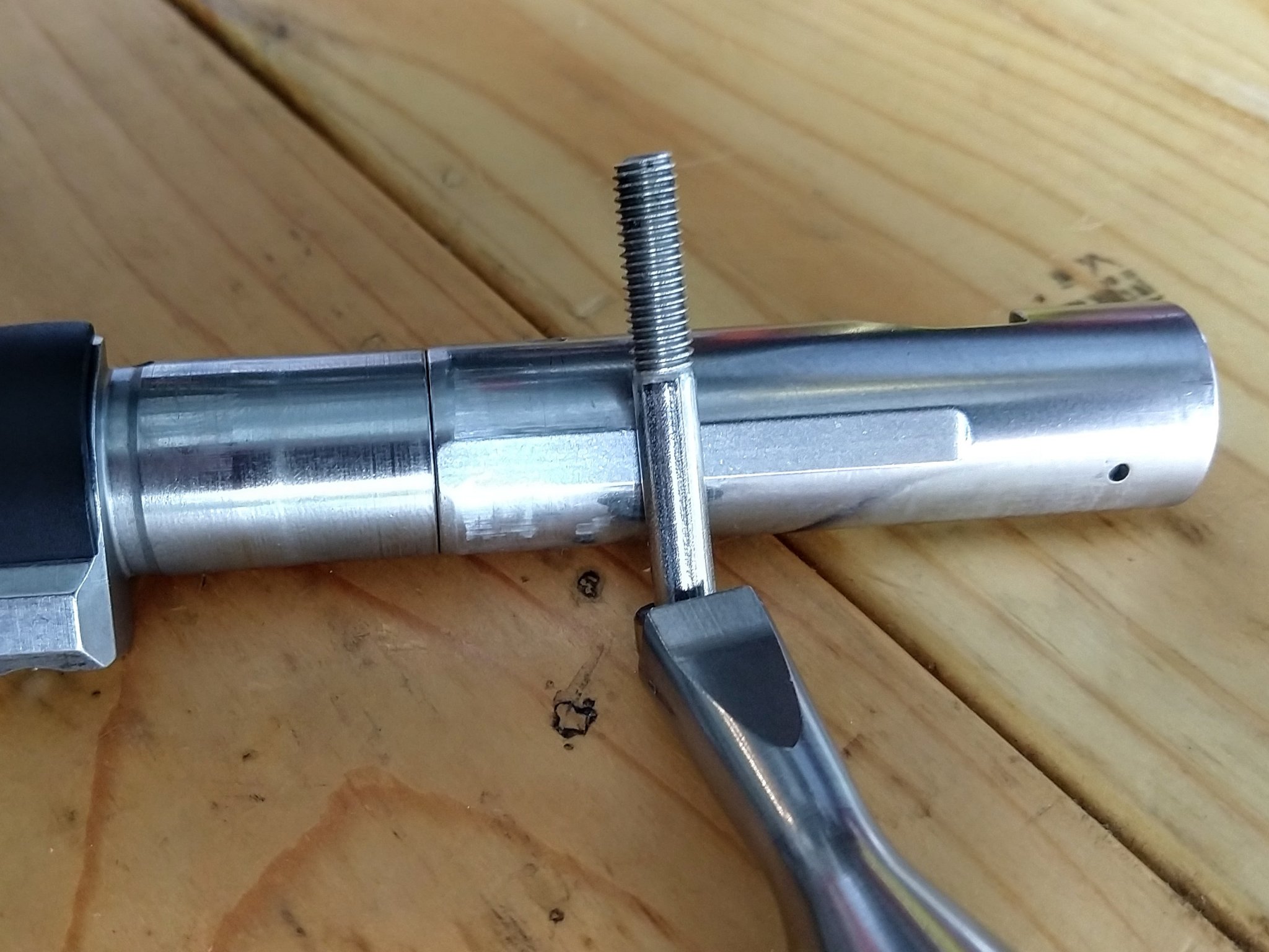

    No, it's very very easy to install. The hard part is getting the factory handle off. I would recommend an Allen wrench long enough to reach the bolt and using a "breaker bar" or some type of extension on the Allen wrench to get more leverage and take it slow.

    Well, I could, if people think it would be helpful. Honestly it's pretty straightforward. Just take a normal L shape Allen wrench, insert the long end into the handle and put something over the short end of the Allen wrench for more leverage. I used the handle end of a small adjustable wrench. I put the Allen wrench through the hole on the end of the adjustable wrench and turned it with increasingly more force until it broke loose.
    If someone thinks theirs is on too tight and they might break something I would recommend using Kroil on the handle bolt and letting it sit for an hour or whatever. I know Kroil works great for helping get things loose.

    The bolt on my factory lever was a pain to get off. Tikka had that sucker on their tight! But once it was off the process was really easy to get the Sterk knob on there. Just shot with it today and I agree it really is so much better. Could pretty much run action with just my thumb if I wanted to.
    My factory bolt handle came off using the short side inserted of the included Allen wrench. It was tight but broke free with some persuasion. Just make sure you install the bridge w/ the bolt side down. ?

    The swept design eliminates the forward motion of the hand that is needed to reach the factory handle. It is quite a bit faster.

    Mine got loose :( I thought I had loctited both the screws, but the inner one was loose, so the whole thing was a bit loose. It was a bitch taking it back off, as my outer screw was loctited really firm and I ended up having to get a blow dryer to really heat it up for it to come loose, then I reloctited and tightened everything back down last night :)

    I will second that removing the Tikka factory handle will take a breaker/cheater bar and or heat. I used a box wrench looped over the short end of the provided hex key (thank you Sterk!). I also found that applying a little heat to the bolt body - bolt handle junction enabled me to break the factory screw free with the improvised breaker bar.
    Are you removing the old handle with the bolt in the rifle, or out of the rifle?
    In. I had it on the tripod at just about eye level. I had no issues removing the original. I made sure the included Allen wrench was securely seated and gave her a solid twist once I felt the resistance in the wrench and it broke free. I could tell it was tight by the way it broke free. My tripod/mount is solid to work with as well. Way better than on a bench resting on the bipod. If you have a gun vice, I would advice you use that.

    Today's the day, the day my sterk it's supposed to be delivered. The day I must battle with the removal of the mighty powerful OEM handle.
    I got myself ready, couple push-ups, pull-ups, sit-ups for good measure. Warmed up my manly hands and manly forearms with a couple of sets on the old Captains of Crunch hand grips. Busted out the gas torch and breaker bar just in case I needed backup.
    As I approached the bolt with the hex key in my right hand, I could feel the excitement and anticipation building up. From all the battle stories told here on the hide, I knew it was going to be a tough task, but I was ready.
    I quickly grabbed the bolt, secured it in my left hand, swiftly inserted the hex key and engaged the bolt. Firm grip. Exhaled three or four times, here we go. It's the moment of truth.
    Ready to unleash a tonnage of force and ... the bolt broke free with maybe 15 lbs of torque if that much.
    That's it. Nothing to see here. Move along. The bolt didn't even have Loctite on it. I feel cheated! lol

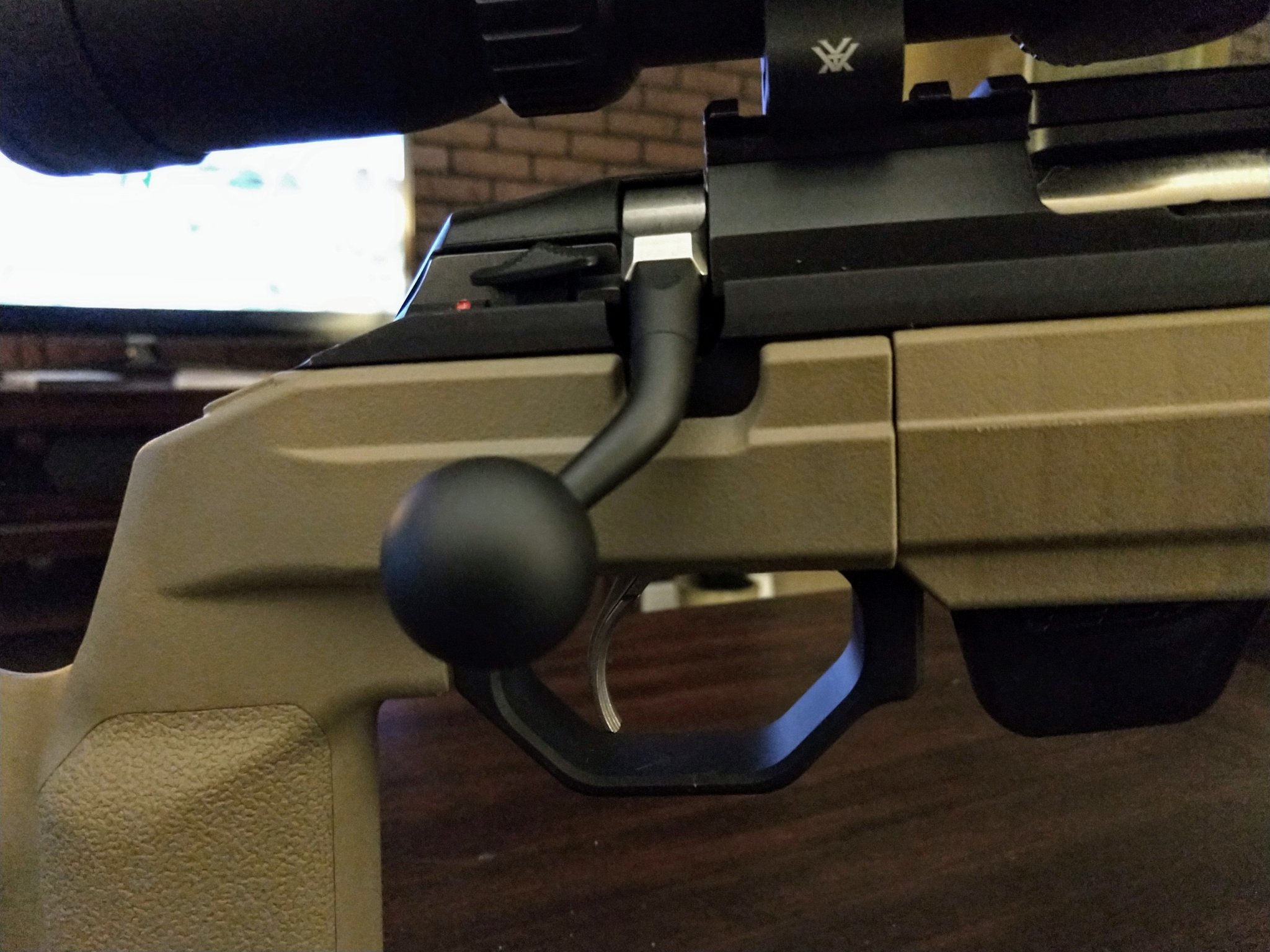

    Anyways here it is, finally, the Sterk!
