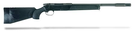

    Anyone own one of this rifles or know what they are going for this days in LNIB condition?
    Any info is appreciated

    Unfortunately PIV's dont really come up for sale that often anymore. This one is possibly the last one available to dealers in the US, it was the "floor sample" at Steyr USA in Alabama. They said it was the last one and no more would be coming, not sure if that was the case or not.

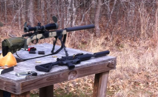

    Not a very good picture, but this one is wearing a Bixler (SCRC) suppressor specially designed for the PIV. Super quiet for .308 with any ammo. .
