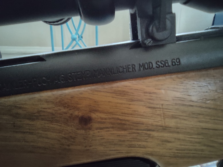

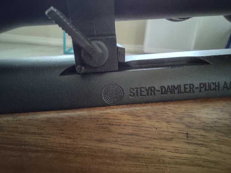

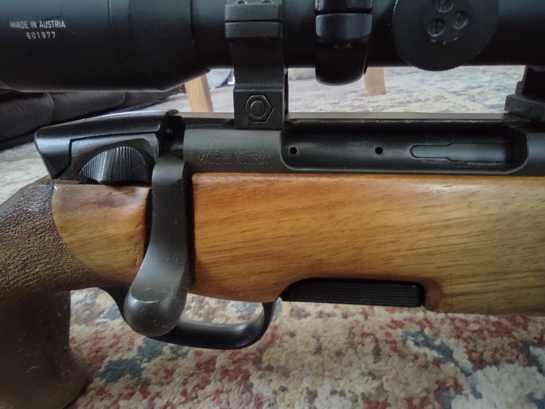

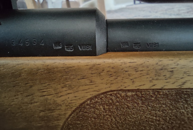

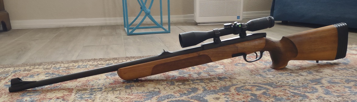

Hi all. I have owned this rifle for a while and have some questions about it. I'd like to get some confirmation that I am correctly noting it as the proper model.
I consider it a Steyr-Daimler-Puch A.G. Steyr Mannlicher SSG69. It has proofs that I believe date it to 1981, so I didn't know it they merit a more specific model description?

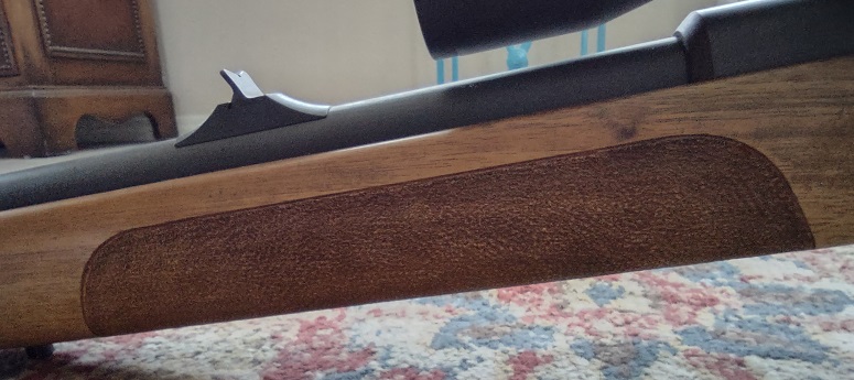

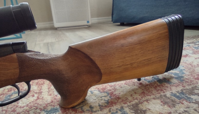

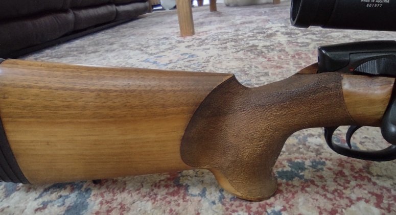

It's rare in the sense that it has an original wooden stock, which I was told was a custom factory order. Any info on the rarity of these stocks would be appreciated as well. It's very comfortable to shoot.

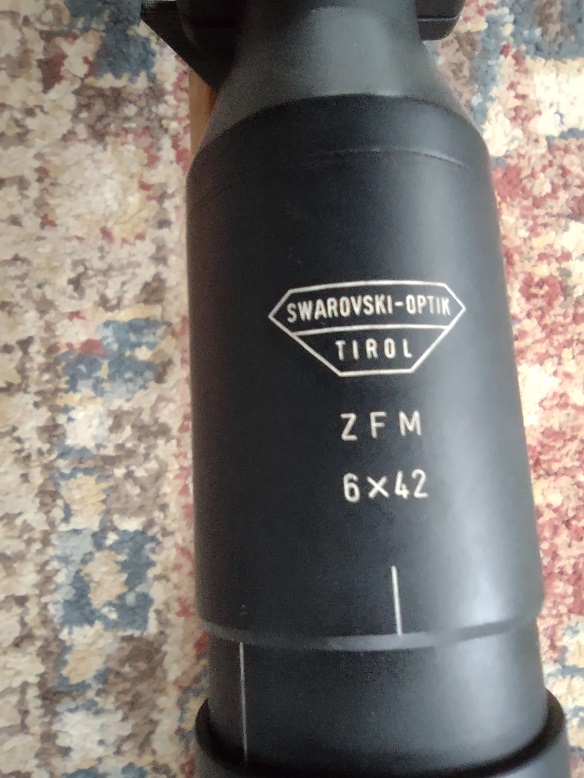

It's wearing the original factory rings and period correct Swarovski-Optik / Tirol ZFM 6x42 Plex scope as well.
Enjoy the pics, and thanks!

OP, yes it appears that is all correct info. As far as the stocks, I have seen a few with it. I almost bought one years ago with that wood stock.

What you basically have is an SSG 69 P1, The P1 being the model with iron sights, and a slightly lighter profile barrel than the P2. As you mentioned, the walnut stock model was a factory custom run - I believe they were known as the "Sport". Definitely an uncommon variant among all the SSG 69 models overall, but still basically a P1 otherwise.
As stated earlier, you have an SSG 69 P1 version with wood stock. Make sure you list the reticle in your your ZFM when you go to sell it.

The wood stock is the standard stock on the SSG69 Match with open sights. The Match has a 3/8" rail on top of the receiver instead of the milling for scope mounts for added stiffness.

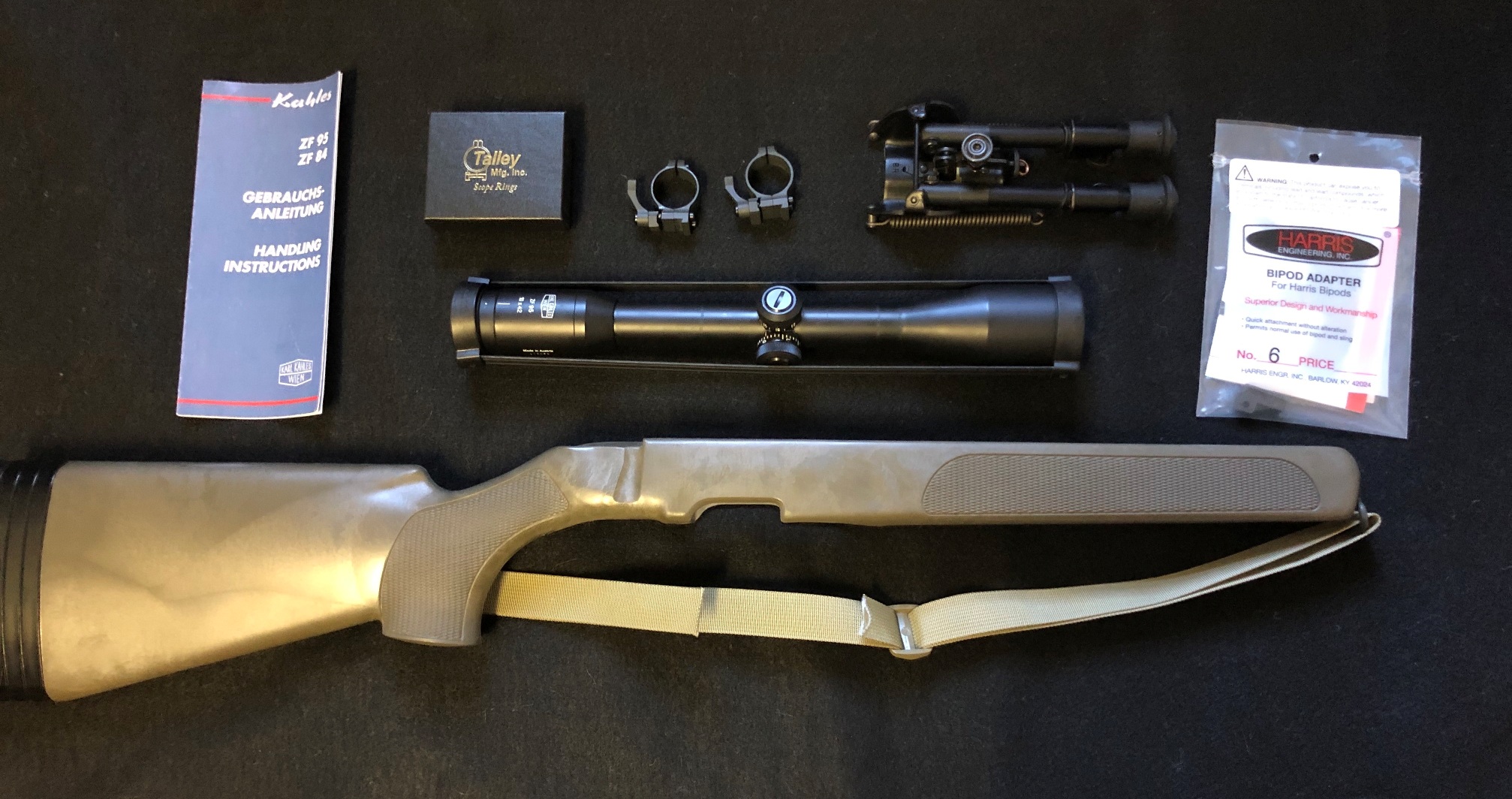

I bought this OD green/tan stock on eBay a while ago, along with the 10X ZF95 scope...but the 26mm rings are for a Tikka rail - not a Steyr SSG69 (opps)

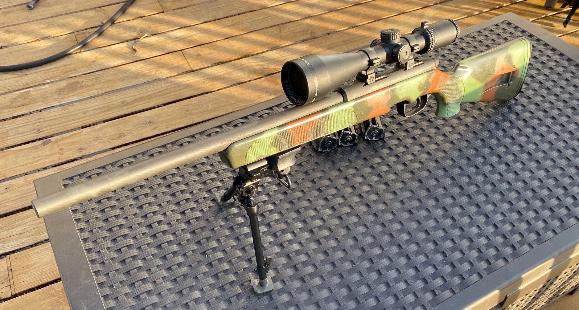

The most unusual SSG-69 stock I have seen was this one with a reportedly factory camo pattern. Owner said that not many were made, and I'm still kicking myself for not buying this rifle a few years ago when it popped up on the CMP forum. It's the only one I have seen with a supposed factory camo stock:

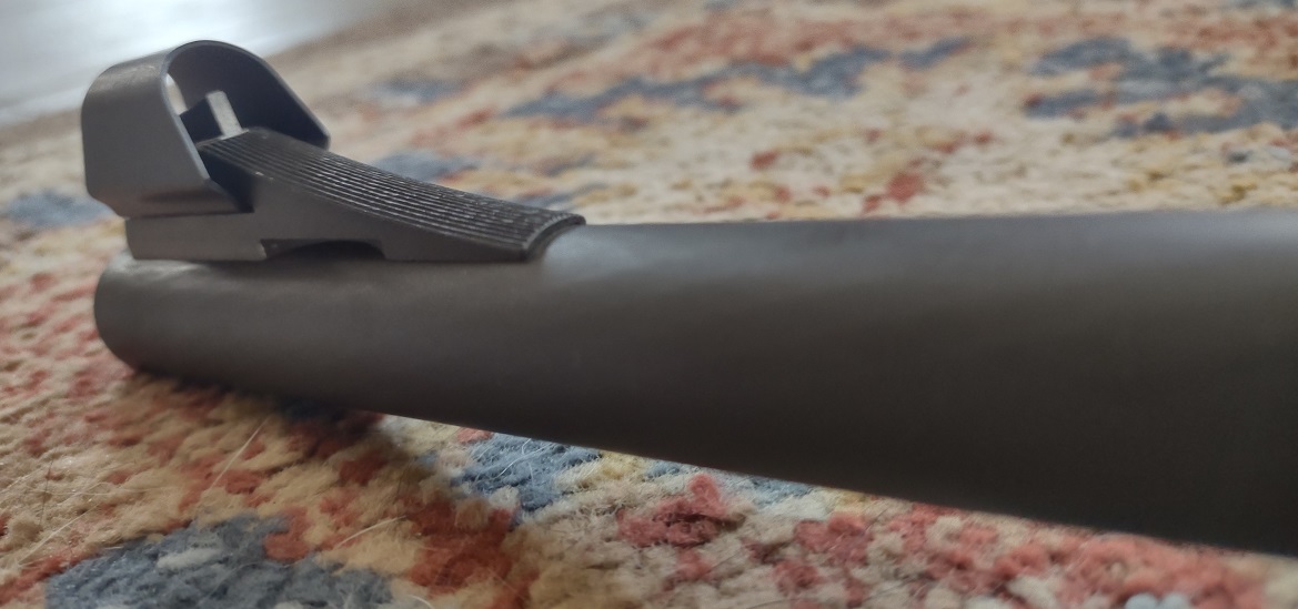

Can anyone spot what is very different on my early 90's SSG P2? It was sent to Steyr to have the additional item/s added & supposedly there are only two rifles like this one in existence with the mod, per the guy (Iner, probably spelled wrong) at Steyr who found the additional items in the bottom of a toolbox in the warehouse.
Your SSG 69 P2 has iron sights (the hood does not seem to be directly over the front sight), like an SSG 69 P1. Unusual. I own one SSG P2 rifle, with the iron sights too, that I bought in 2010 from Steyr Arms, Trussville, Alabama, via a Canadian importer. The trigger guard/magwell on your rifle is an aftermarket replacement (Dr. Strangelove ?).
From what I can see. And from what I know. But I am always interested in learning more about those rifles.
Bingo Carcajou, you are correct, the iron sights are the items Steyr added to my rifle. Very interesting to know that your P2 has them also. From what Iner told me mid-90's the two in my area were the only ones that had them as Steyr never made them for the P2 due to the heavier barrel. Yes my front hood isn't correctly placed on the front sight. When the hood is properly set into the notch on the front sight, you can barely see underneath it, so i moved it a little bit upwards so the sight could be seen & apparently i have it set incorrectly in the pic. Yes i have Dr Strangelove's bottom metal in the rifle these days which is a fantastic upgrade. Also have an aics version bottom metal that CDI made years ago. Hoping that the good doctor makes them in the future as i would get 4 of them for everyone around me. FYI: The bottom metal also fits the Varmint Model "L". The Varmint model "L" also has a threaded in barrel & my varmint is in 22-250. Unfortunately several years ago i sold both of my ZF84 scopes to hide members, Got old & needed higher magnification which is why the MK4 is on it.
