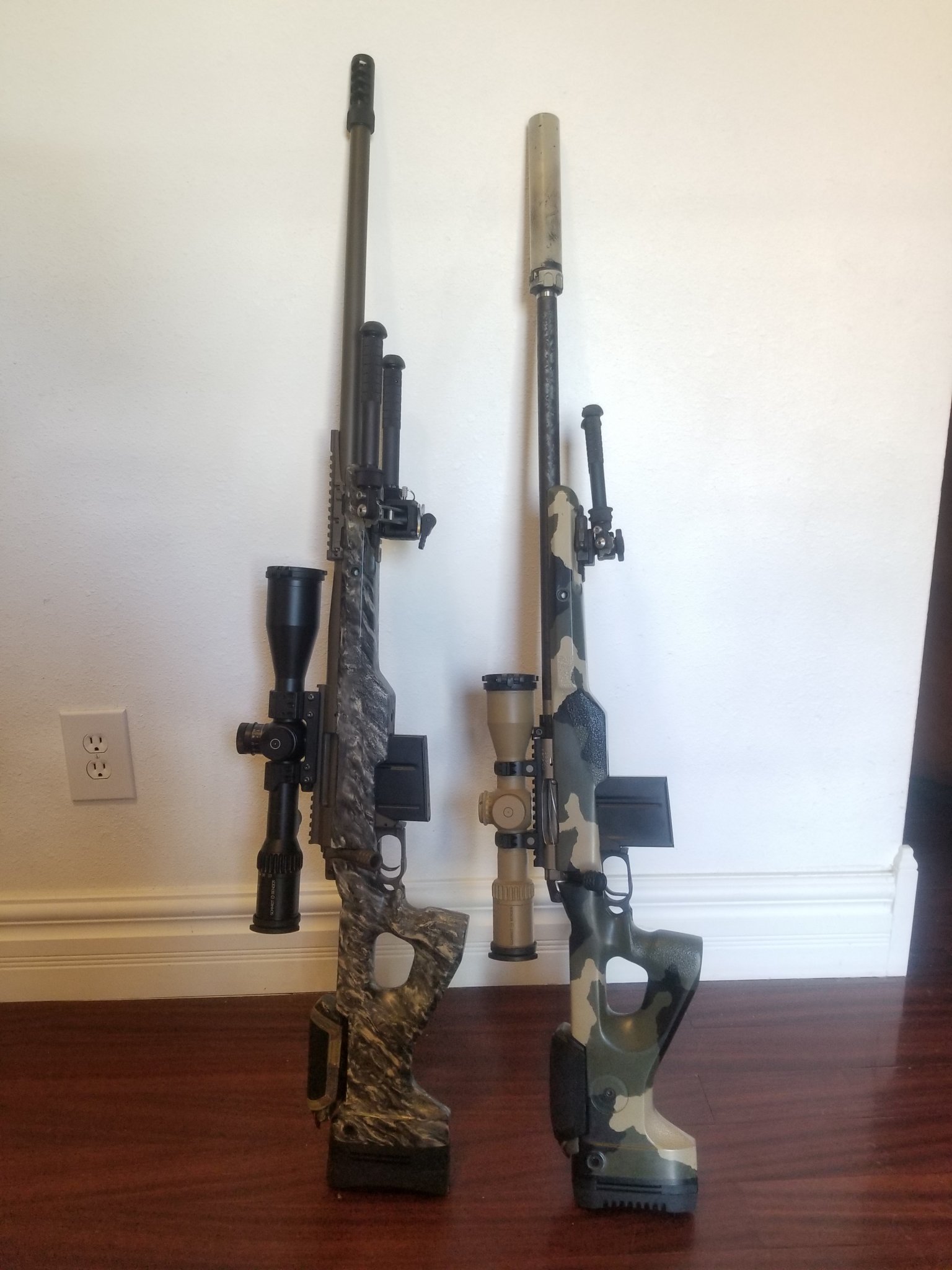

It still has 38 mils of internal adjustment, you can only dial 26 of them though. You cant do that with the 5-25 FYI. I have one mounted on my 338 pictured on the left.
