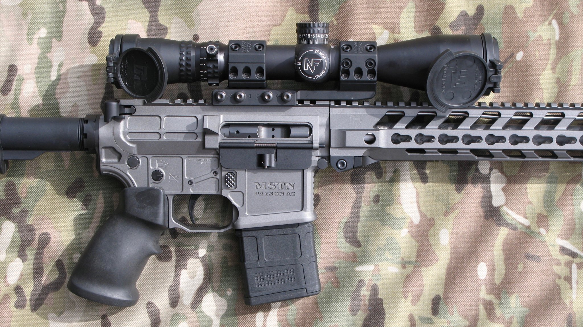

I asked this question (same question as the OP) a couple months ago on 2 other forums and didn't really receive any first hand info, just a few opinions on what might be best.
I eventually decided on a Noveske marked MUR upper (because it has a little more material around the barrel extension than the standard VLTOR upper), a Knights URX4 handguard and a JP FMOS bcg. This build will be getting a Bartlein barrel from Craddock.
In regards to upper and bolt fit, my sample of 1 JP FMOS is no tighter in a Noveske MUR than a standard mil-spec bcg (toolcraft in this case) and a BCM MK2 upper receiver. I was hoping the JP bcg would have less play in the upper but no such luck.

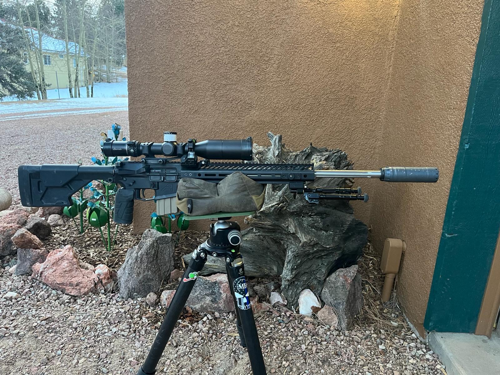

Wow, it’s been a while. I ended up with the seekins, never tried the MUR. The results have been fantastic. Took 3rd at the steel safari special ( tied for 2nd and lost tie breaker and I think we were 1 point behind 1st), I think 11th at the team steel safari, and won a local teams match that went out to 1k with the rifle so far. I have mostly used the rifle for prairie dogs and it just hammers them!!!
Build ended up seekins upper and lower (I swapped to an aero standard lower because my brass catcher wouldn’t fit on the seekins lower).
Larue MBT 2 stage
Lilja 24” fluted 223 barrel
When I built the rifle the JP bolt I wanted to run was out of stock so I put a spare bolt I had in the rifle and haven’t changed it, not sure what brand it is.
Kgm r30k suppressor
Arca rail added to the bottom of the hand guard.
I am beyond please with the rifle. By far the most accurate AR I have ever been around and consistently shoots under 1/2 moa with 53vmaxs. My match load runs hornady 75 otms and I get occasional flyers but for the most part is under 1/2”.
I played with impact changes with different pressures on the hand guard and shoulder pressure. I still get more shift than I do with my bolt guns but significant reduction from my other standard AR upper builds.
