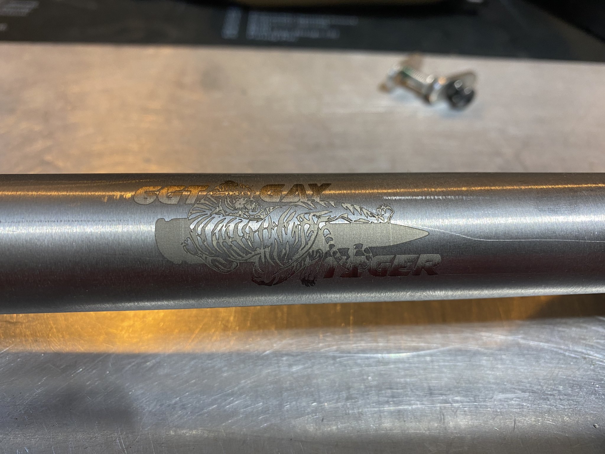

Don't go full gay tiger.
Holy crap that’s cool. Even though your rifle clearly says “Gay Tiger” for everyone to see.

love that i mage on the barrel.So where did the Gay stuff co me from? I have a6mmARC and two 6GT's.
When it first came out, someone, somewhere saw the GT and called it "Gay Tiger." And it caught on virally.
At first George and company didn't care for the name. But it actually turned out to be a hell of a marketing tool by accident. Now they just lean into it and go with it.
