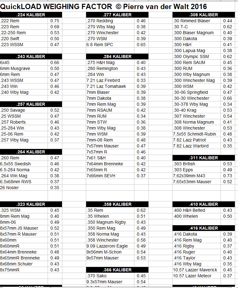

    It sounds like there will be quite a bit of QL research that you still need to do before effectively using it. QL can predict loads well, but you must enter very exact values, accompanied by real data to tune their default values in order to get accurate and SAFE loads.
    This overbore concept directly affects the weighting factor value for quickload. There is a table I saw in another forum that lists the weighting factor values to use for each cartridge.

    If you can find that table of weighing factors by cartridge that would be very useful.
    As I'm sure you know, the QuickLOAD manual is useless.
    Is this the chart you’re referring to?
