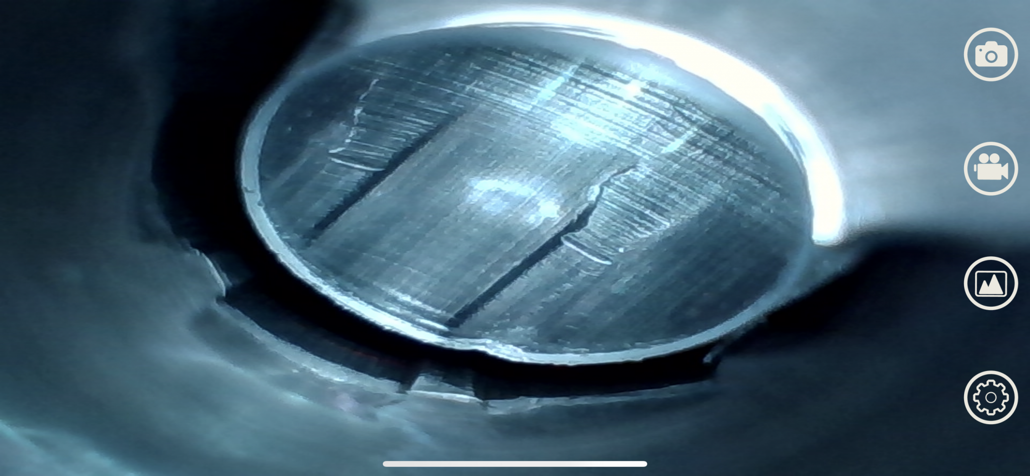

Once you let a carbon ring build up they’re a pain to get rid of. I had a good shooting rifle that started being not so good. I read about the carbon ring and decided to check it out. I had one so thick it had topography.
My previous method of cleaning consisted of cleaning after every outing with only cleaner on patches with a few strokes with a nylon brush every few outings. So I attacked the carbon ring with a brass brush, first I soaked a Tipton cleaning pellet with cleaner and let it soak on the ring for a couple hours and then scrubbed vigorously with a brass brush. This was then result.
I got most of it. Then I got some JB Bore Paste. I soaked the ring with Kroil for a little while, wrapped a patch soaked with Kroil around a nylon brush then covered it with the bore paste and scrubbed the ring are real good. It did the trick. There is a little faint carbon left, but I’m fine with that so long as it doesn’t affect accuracy.
The gun started shooting good again with no cold bore fliers.

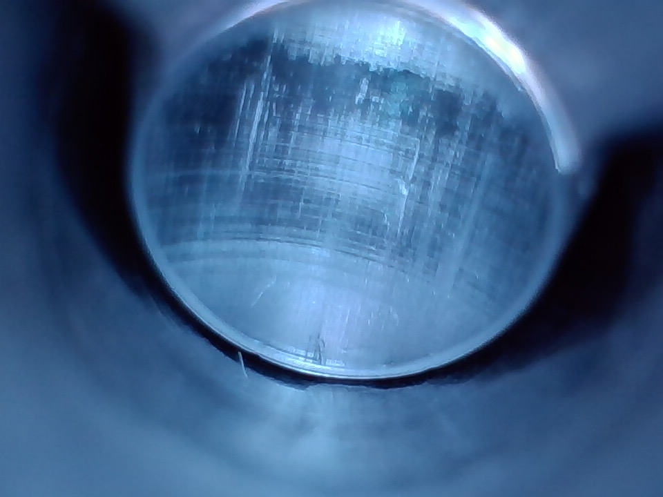

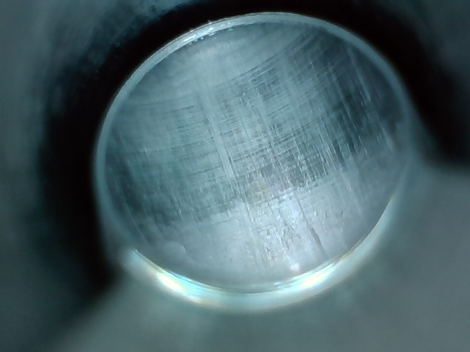

I don't know all that much about 22LR accuracy, or more precise, what can be done to clean 22 barrels up. IMO, your barrel looks rough in that area, with both vertical and horizontal striations.

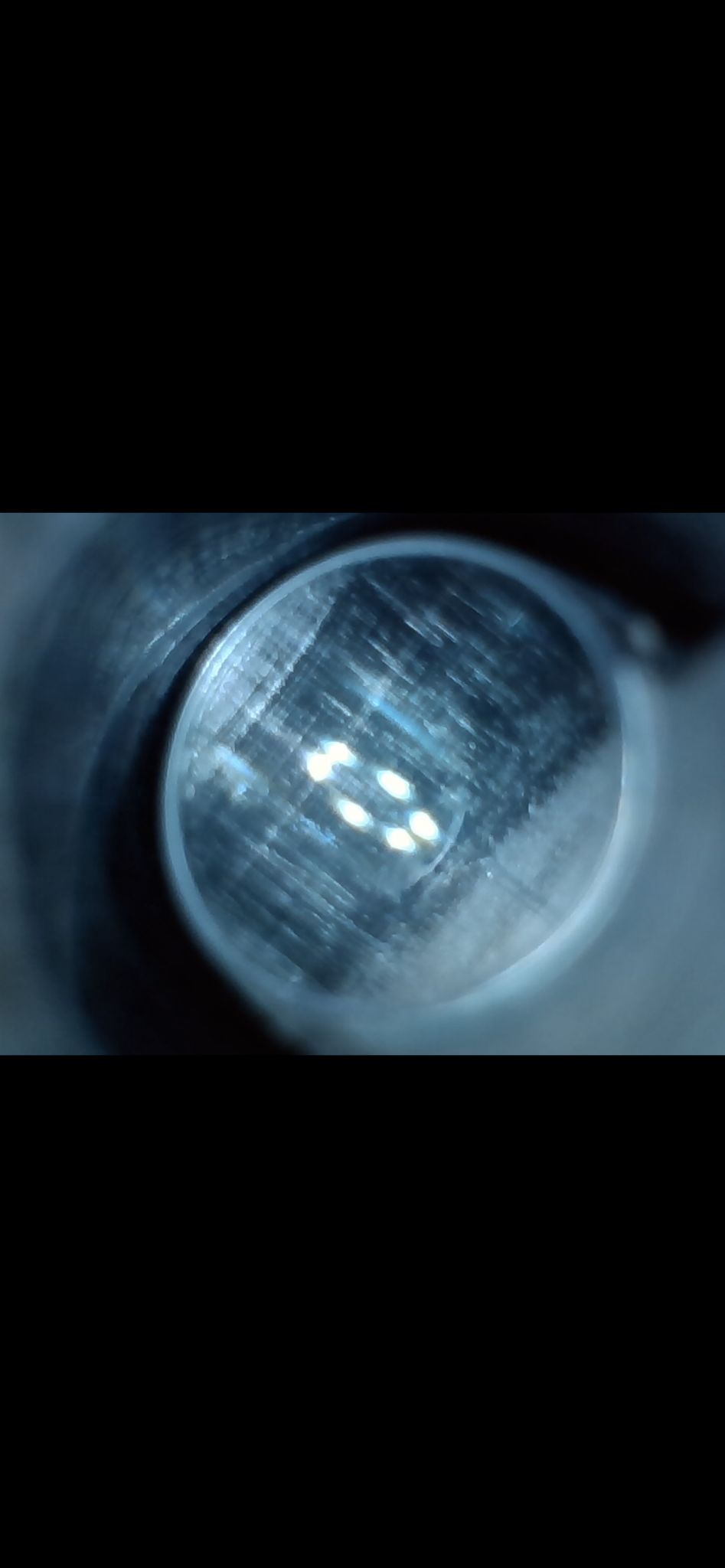

There are 2 camps on what a carbon ring is, the actual end of the chamber, or, as in this case, a carbon buildup where the rifling actually starts.
I don't know what you have into that rifle, but I would polish that area if it were mine. At least get a fresh start, leaving any carbon in that area is just going to act as a magnet for more.
The carbon ring forms where the bullet meets the brass case. You can’t really judge how a rifle will shoot by how the bore looks. Sometimes it’s better not to know. That particular rifle is a tack driver for a factory rifle, CZ 452. Actually it’s the best shooter out of the 13 CZ’s I have including two MTR’s.

I had trouble with a carbon ring build up in my first 22. It was used and the first owner was in the never clean a 22 camp. I was advised by a good gunsmith to soak a patch in Boretech carbon remover and slide the patch just past the chamber where the end of the case would be and let it sit for 15 minutes or so. It may take two or three applications. He also told me if the original owner used a lot of copper coated 22’s to plug the chamber with a rag and try one or two overnight applications of Wipe-Out foam.
This fixed my flyers. Not saying it will fix your but carbon rings are sometimes tough and I would try the bore cleaners before I bought a new barrel.
