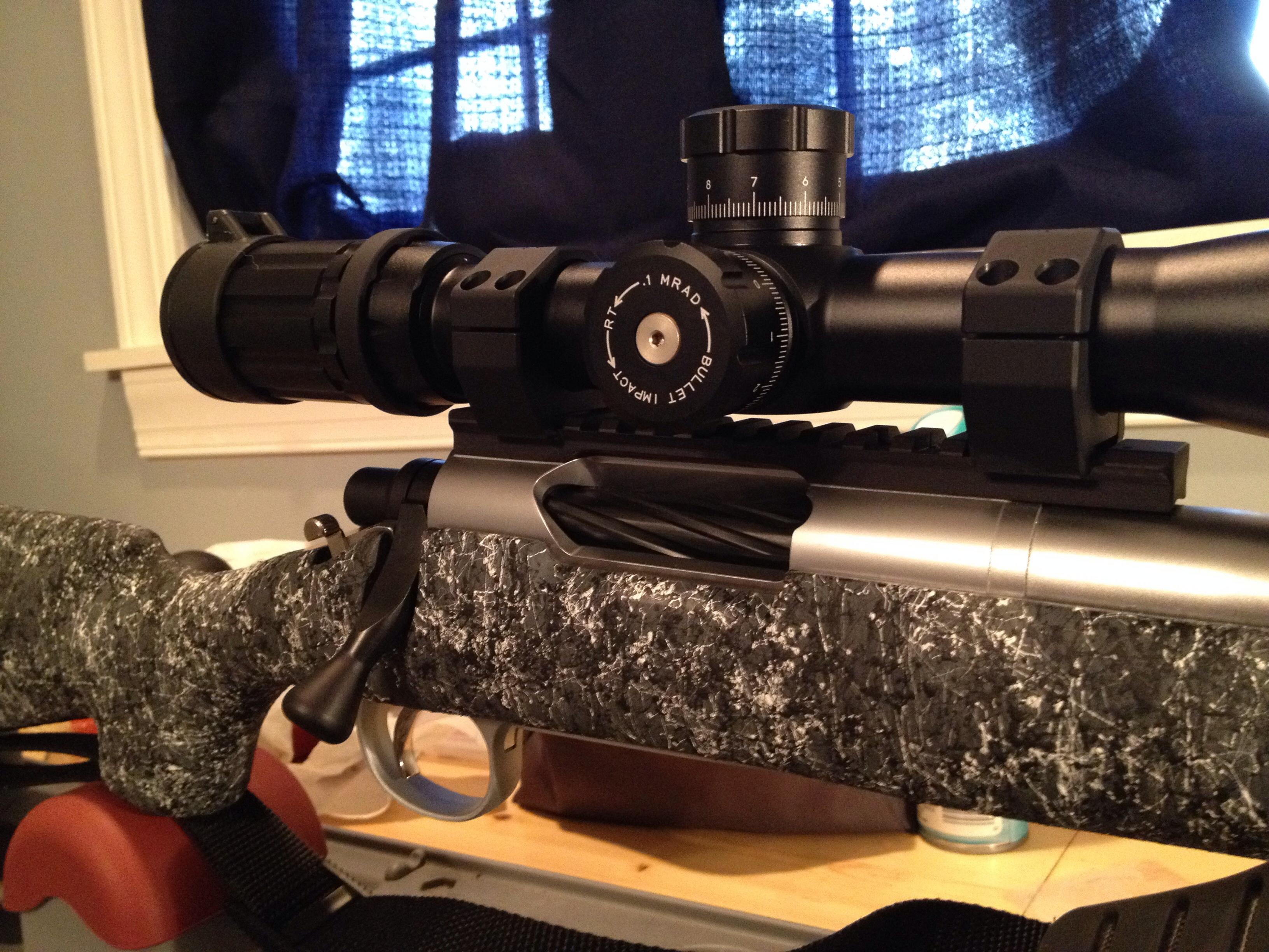

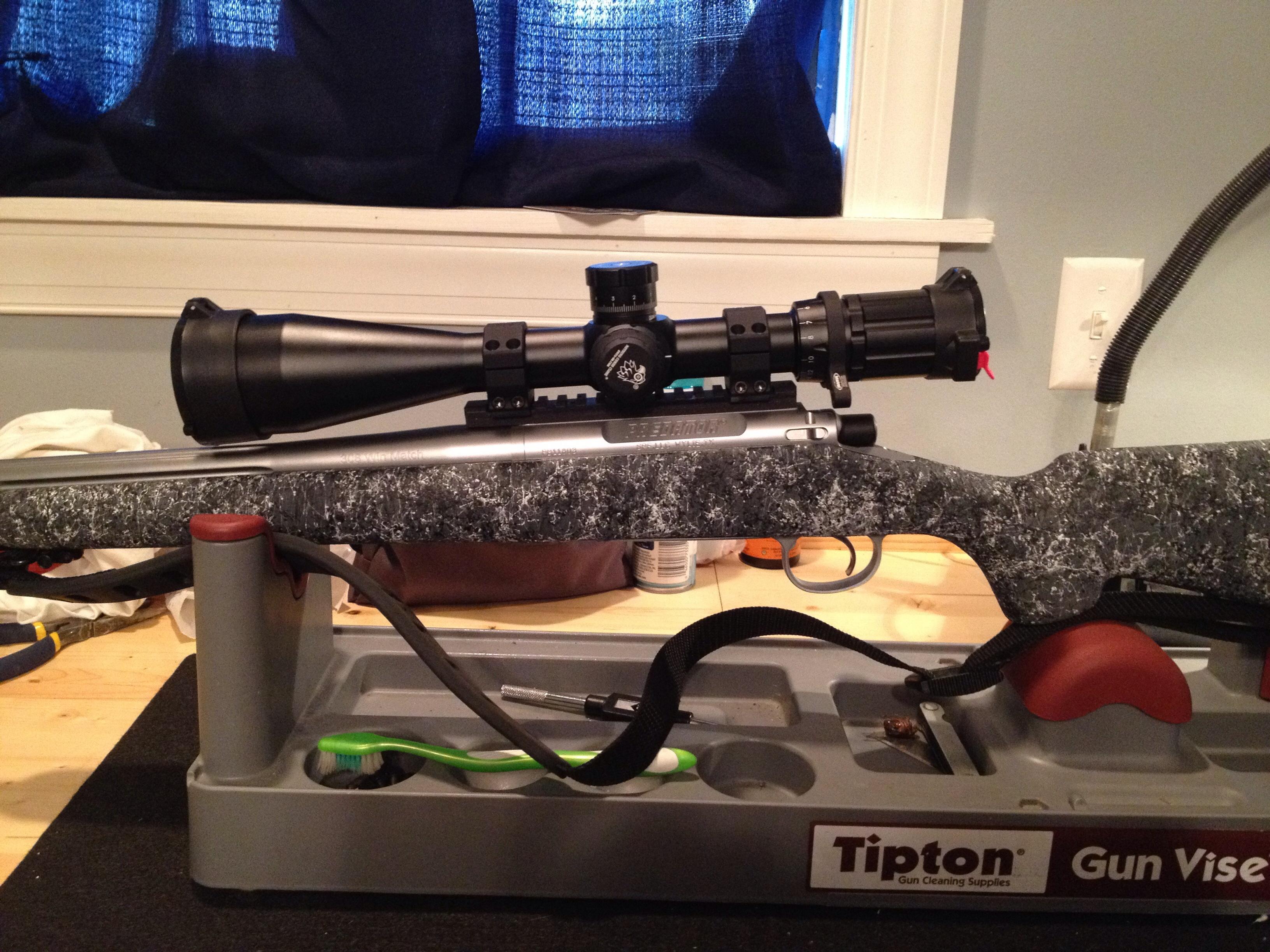

Stiller no finish; media blasted.

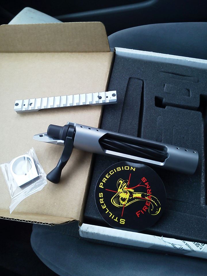

My new TAC 300 arrived yesterday. It is absolutely beautifully crafted. I ordered it at the end of March and got it 5 weeks later. Try that with some other popular action makers. The work is under way. Pictures to follow soon.

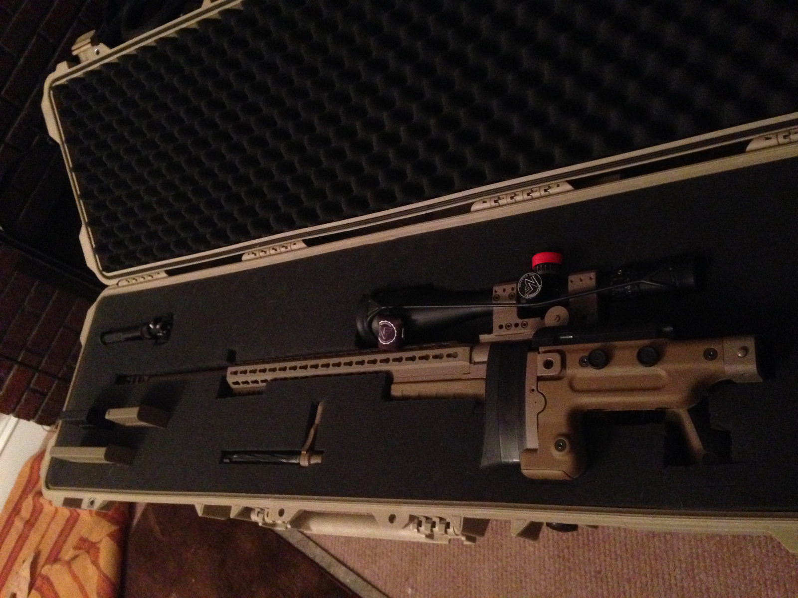

I just sent in my payment for a TAC 300 that will be sitting in a cadex with a benchmark barrel. Russ was EXCEPTIONAL to deal with. Very helpful, knowledgeable and I am very excited to have a stiller action. This is my first custom build and I feel like I made the right choice in regards to a quality action.
This is the only picture I have atm, will take more when it's nice out.
Stiller Tac 300, Bartlein, Jewel, AICS AX, Nightforce NXS 5.5-22x56 -- Amazing shooter.
