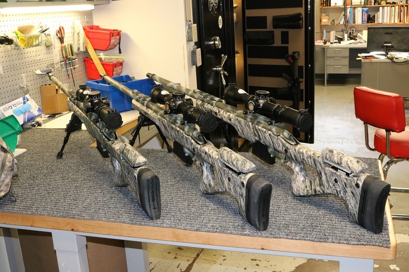

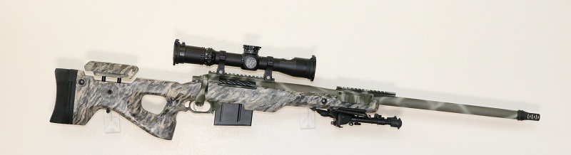

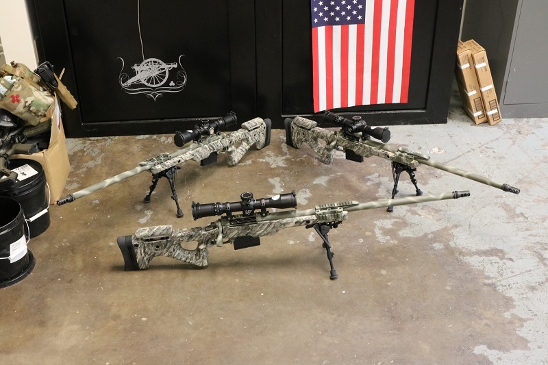

eodusa,
Defiance Machine runs plenty of actions with 0.750 diameter bolts. In addition multiple configurations of bolt nose/lugs are available. I use them regularly for Lapua and Norma based cartridges. These are 3 complete rifles on the Defiance action in .338LM delivered to a State Police agency and in service for a bit already.
I have other rifles on the same pattern in circulation being run hard. Various users are running RUAG, Black Hills and Hornady ammo for monthly quals with no issues at all. Buy and build on the Defiance with confidence. I am sure the Stiller product is a good one as well but I have zero personal experience with building on any of their big actions.
Just my opinion but you are going to have a fairly expensive rifle built by the time you are through. I would highly recommend you put features and design ahead of any slight cost difference in your action choice.
PS: Not sure WTF would have been up with your rifle setup but if you sheared ANY recoil lug on a 700 shooting ANY cartridge, something was not right in the parts or build.
