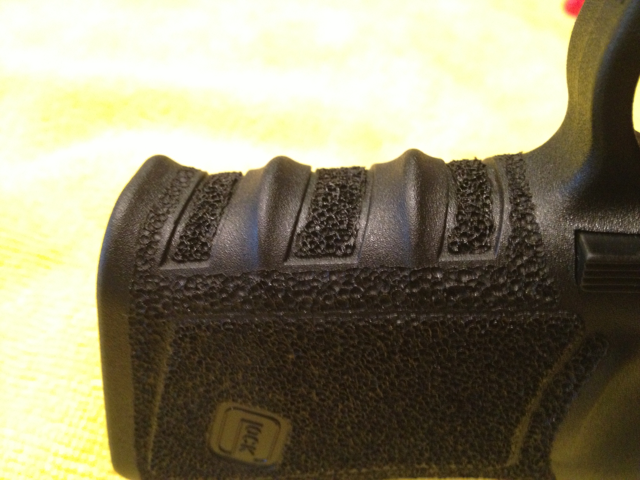

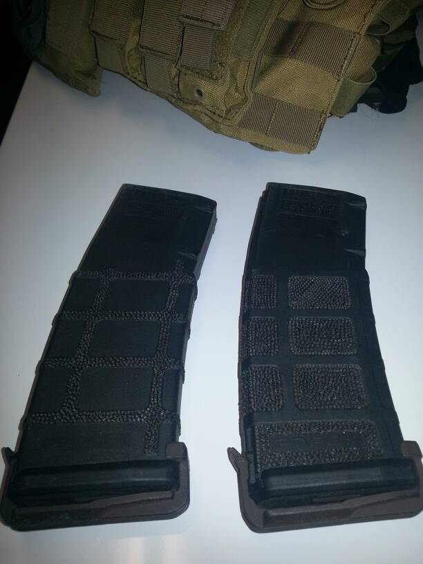

I also did this on a couple PMags...two to be exact. I will post pics when I get home but...what I found (and friends of mine by doing a eyes closed experiment) was there is ADDED grip if you stiple JUST the ridges of the PMags and not the valleys. When the PMags "valleys" are stipled, its still a semi-smooth surface all the way down. When just the ridges are done, its like sand paper. Ill post pics tonight.

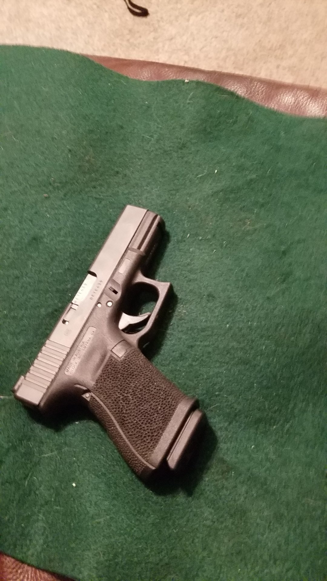

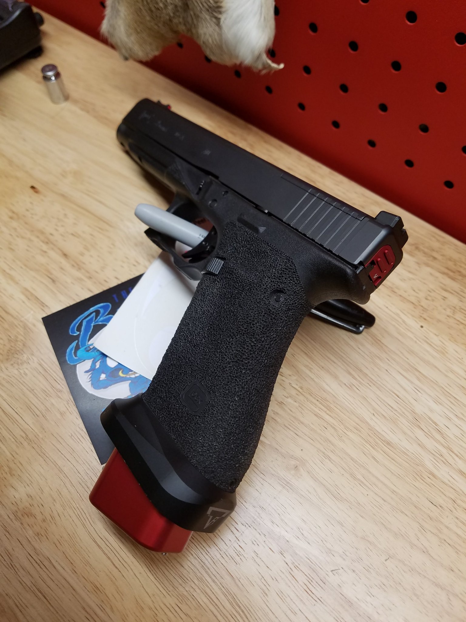

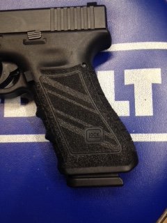

Here are a couple glocks a buddy did for me. I also did the rip area on a mossberg 500 stock but it didn't turn out as good as I hoped. Think it was more because of the difference in the polymers.
Thanks guys! It's definitely a good way to kill a couple hours! Those glocks look great. You try cutting a finger relief, and a relief for the mag release yet? Fairly easy to do and you can stipple right back over it. A lot of guys notch the front of the mag well too for jammed mags.

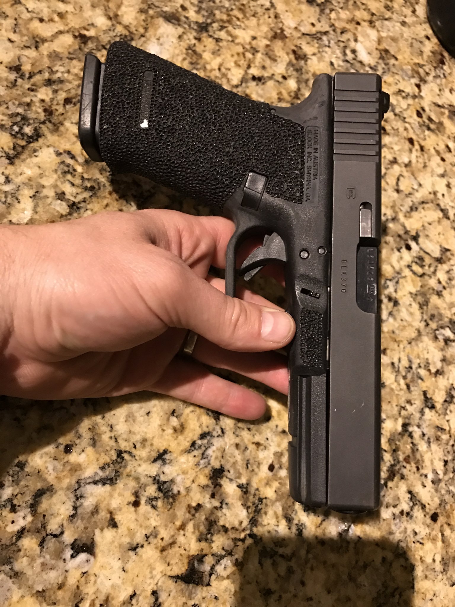

On a blind feel test, everyone I asked said the one on the left felt better and more secured than the right. To each thier own, just food for thought.
Sent from my SCH-I535 using Tapatalk
I actually just got a new set of gen 3 PMags.. I'll be stippling those soon and I may very well take your advice. Haven't really decided on stippling the floor plates yet though. I had a couple GI mags lying around and tried stippling those. What a mistake. The flimsy mag body just dented in when I hit the punch (not hard either). Reason number 4 billion that those mags are worthless.
So what do your public restroom encounters have to do with anything? :p
Kidding, stippling the high portions might be worth a try, thanks for the picture.

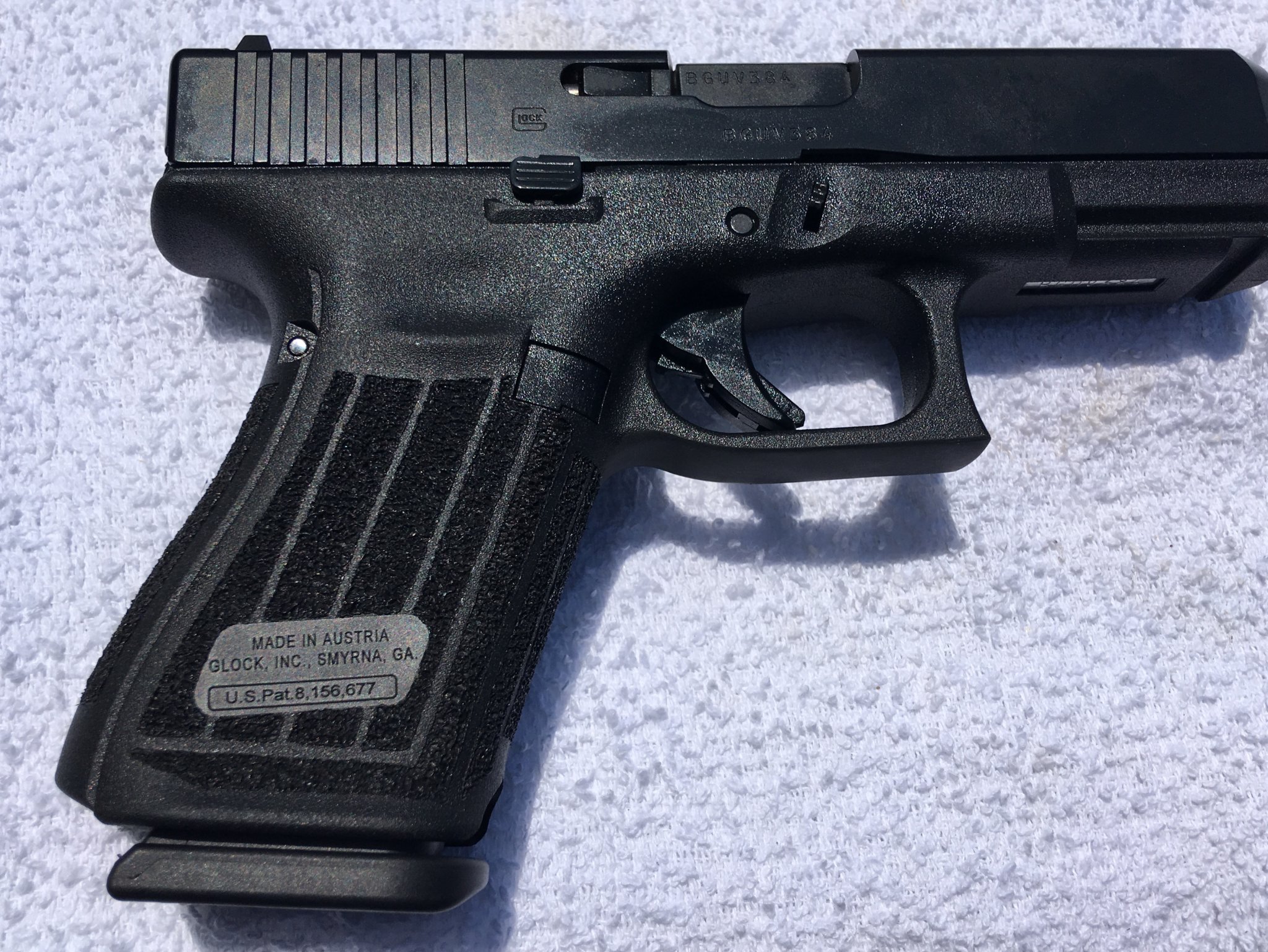

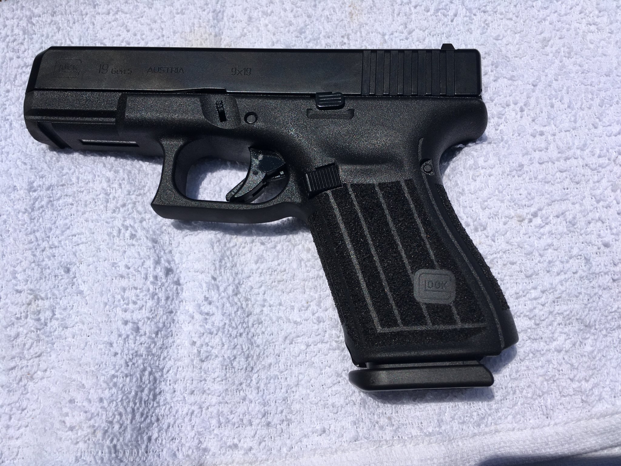

Little Glock stippling i did with a soldering iron

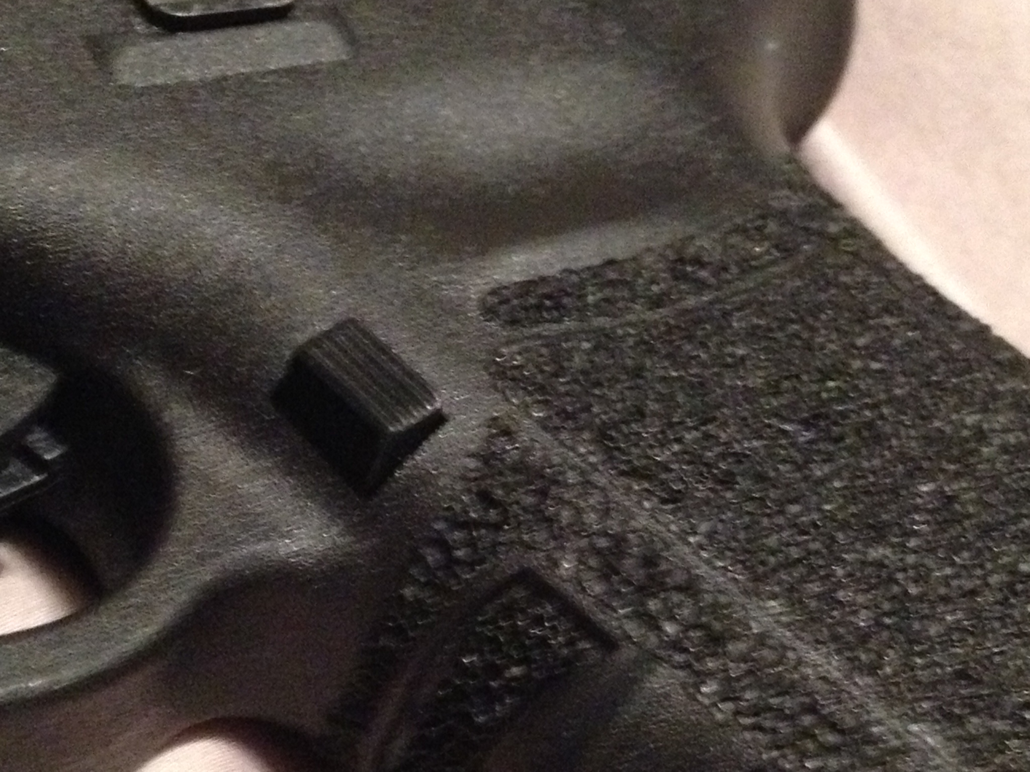

Heat gun and a wood burning kit. Was my first complete and I love it. Definitely wore down after about 1000 rounds. Used to be a little scratchy carrying IWB

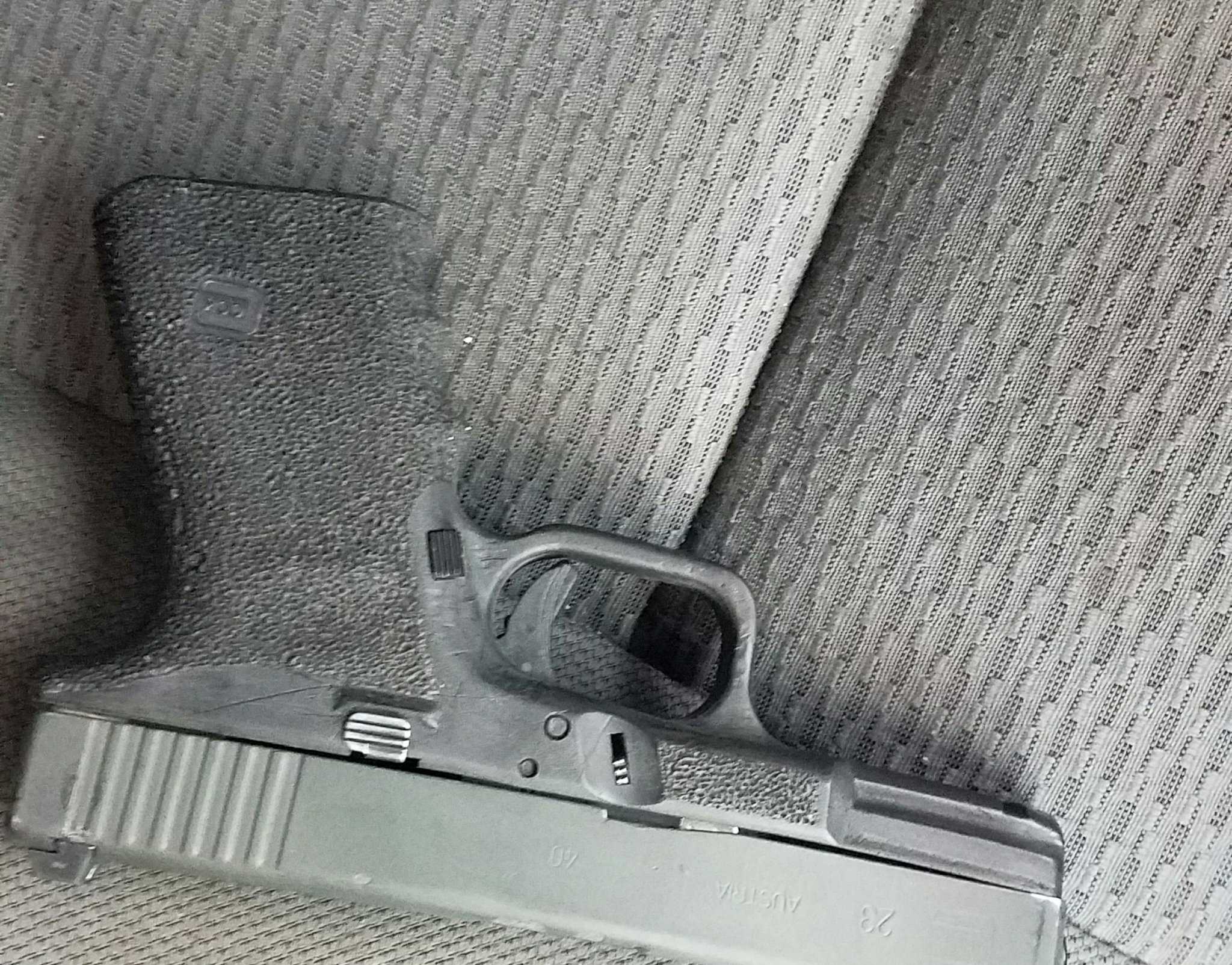

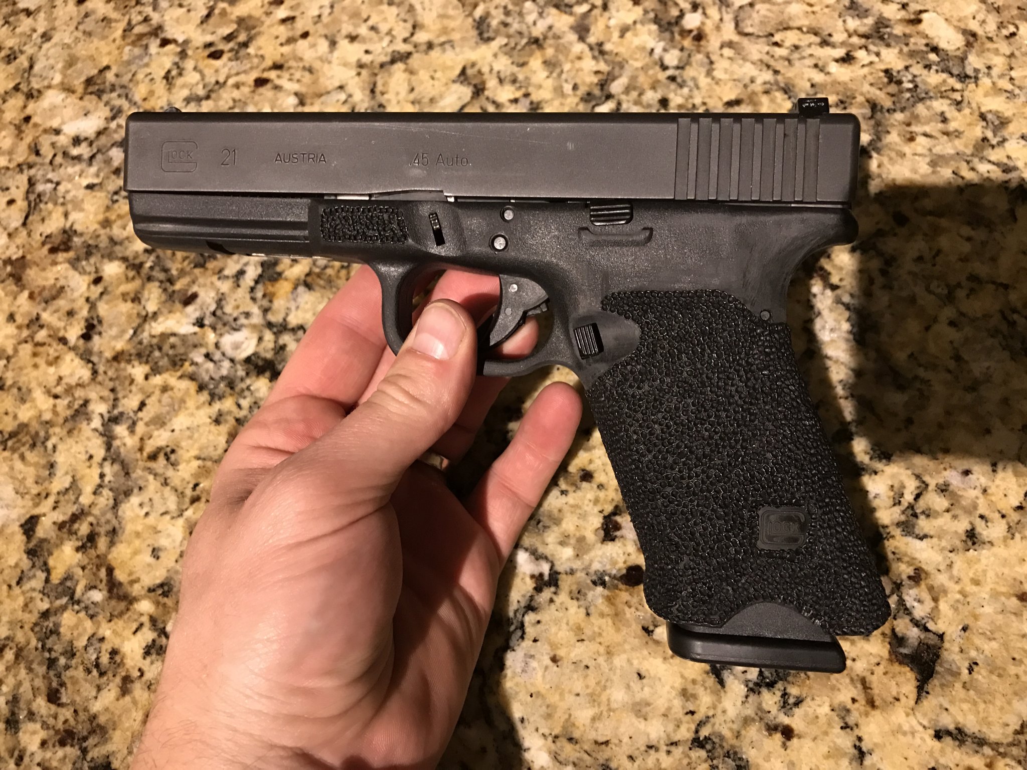

Here is a G21 I did a grip reduction and stippled with a soldering iron. Also changed the beavertail a bit and undercut the trigger guard.
Made the mag cut because this becomes a .460 Rowland for bear country with my little one, so probability for debris is high. Did it on a recommendation from a gentleman who has been doing this for a long time professionally.

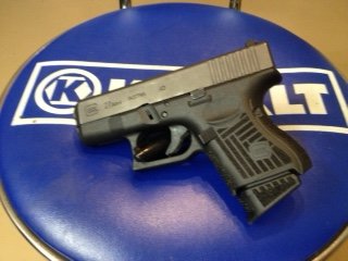

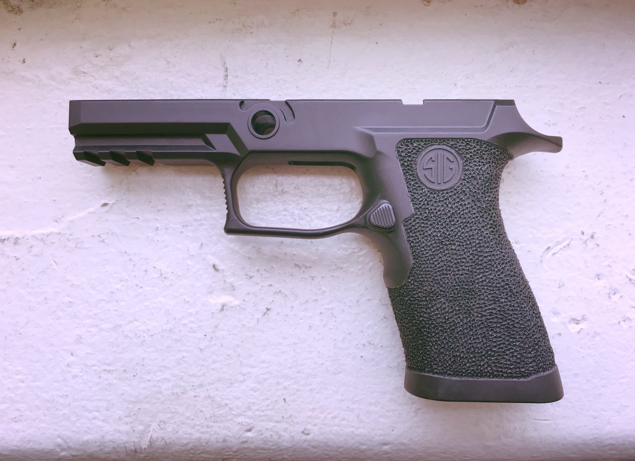

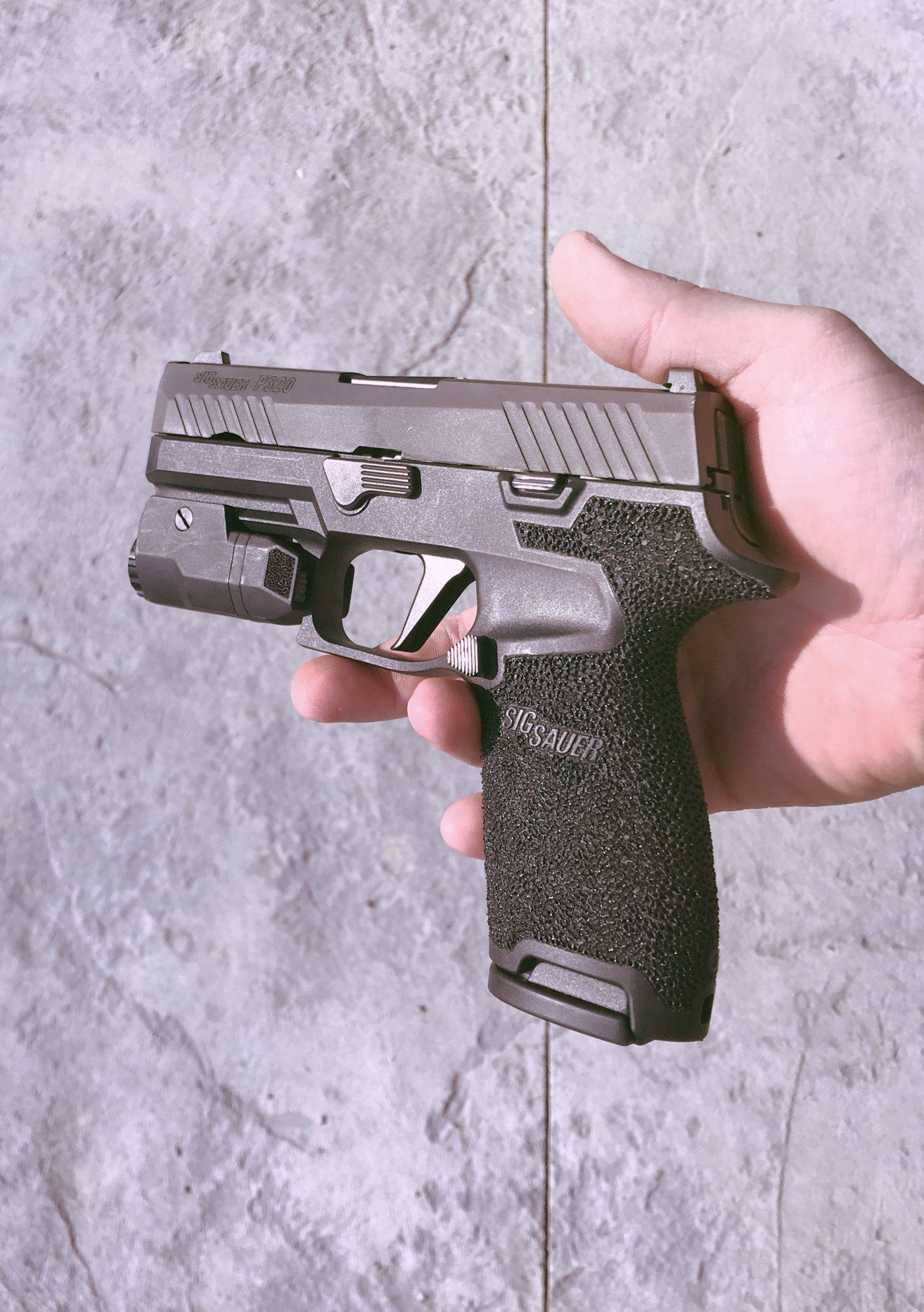

Here is a P320 carry I did the other day. I think it’s the 3rd frame I’ve tried and I still can’t figure out how to do a really clean recessed border like the guys on IG
