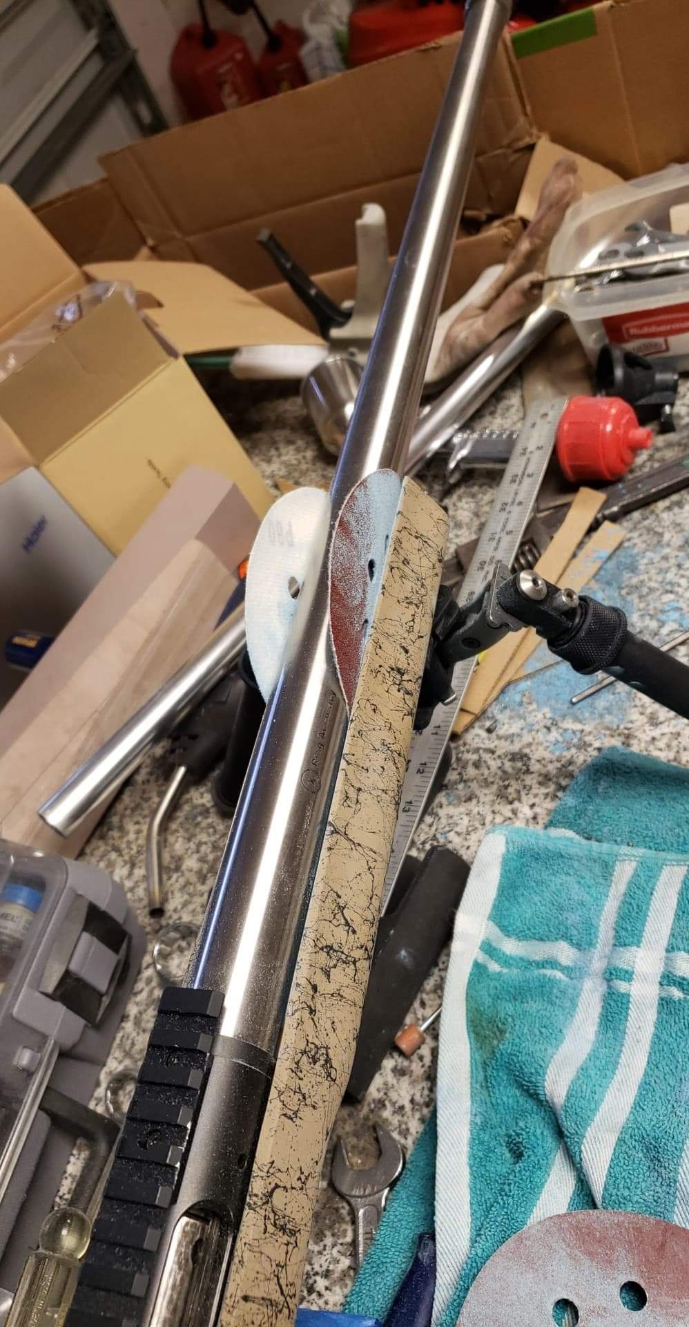

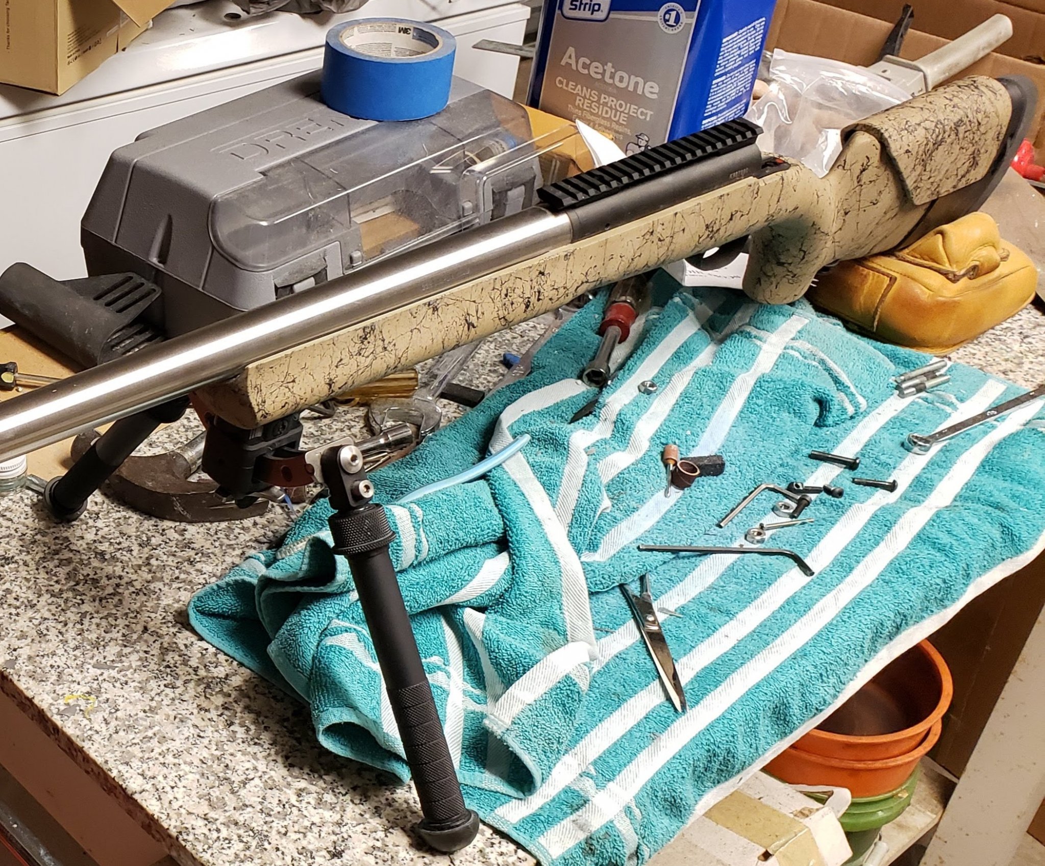

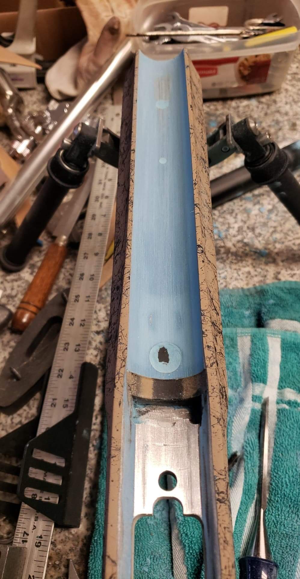

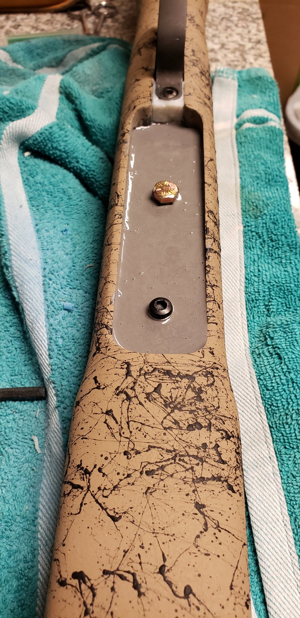

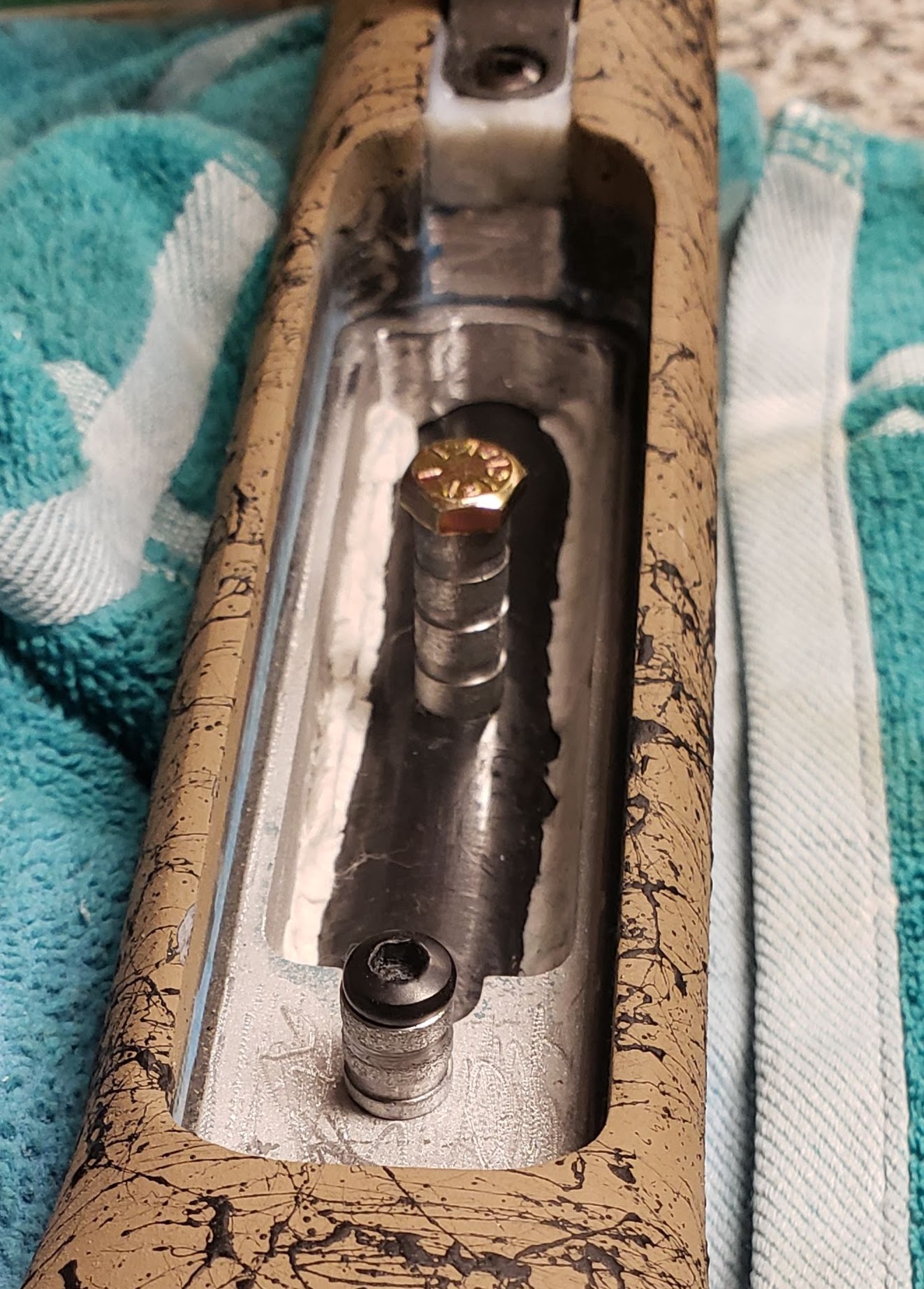

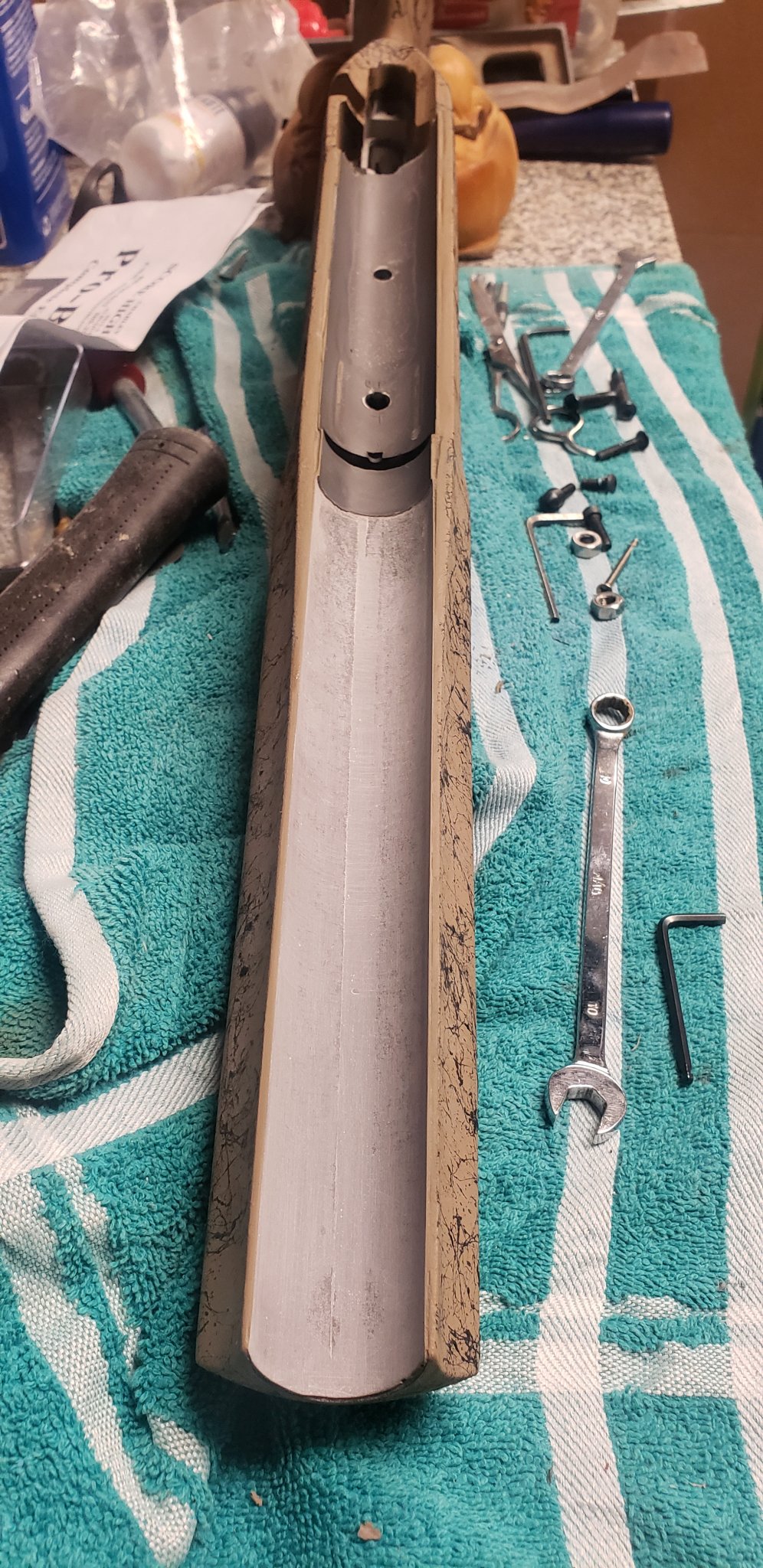

I ended up getting a HS precision for the 110. I had to put a pillar in the middle for the center bolt, a few other little spacers to make it work and fill in the magwell, but it wasn't a big deal at all. I did take pictures as I did it if anyone else wants to do it, or is intrested in seeing it.
So I am no gunsmith by any means just a hobby guy .
I started by inleting the stock to fit the different contour barrel that I had put on.
This is a Brux heavy varmit 1-9.5 twist.
Once I had it fitting with good clearance in the barrel channel I moved to the action area and started to see what I needed to do to fill in the mag well area. I also had to make a small spacer to go under the front of the trigger guard. Sorry didn't get a picture of that. I knew I had to make a spacer for the front action screw as well and a middle pillar for the center action screw. Since the stock had an aluminum bedding block in it. I used the front action screw and the rear action screw to hold it in place. The center pillar was held in by a random 1/4-28 that I had laying around. After talking with a few guys about what to fill the open area in with, I decided to use Epoxacast 655. We use this at work all the time to make molds and its machinable since its aluminum filled. I used modeling clay to seal up any voids where the action meets the stock. I mixed up the epoxy and poured the cavity full and let it harden up. The next day I pulled the barreled action from the stock cleaned up the clay and rinsed the area with solvent then did a full length bed job using the same Epoxy with cabasil added to thicken it so it wouldn't run. I ended using grade 8 12 point screws to hold the action to the stock. That was about it.

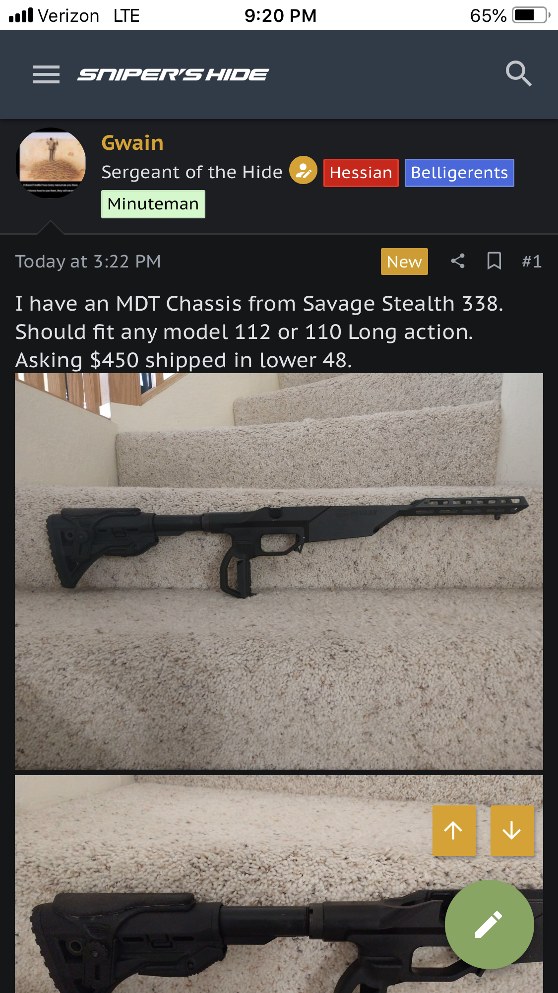

So I know this is an older thread but could you just leave the 3rd action screw out and use an mdt?
Would also love to know if you could leave the third action screw out and use an mdt. My laminate Savage stock cracked on the side, so I'm looking for a lower cost replacement. It was a great stock and I thought about gluing it together but not sure that would be the best fix on such a heavy recoiling rifle.

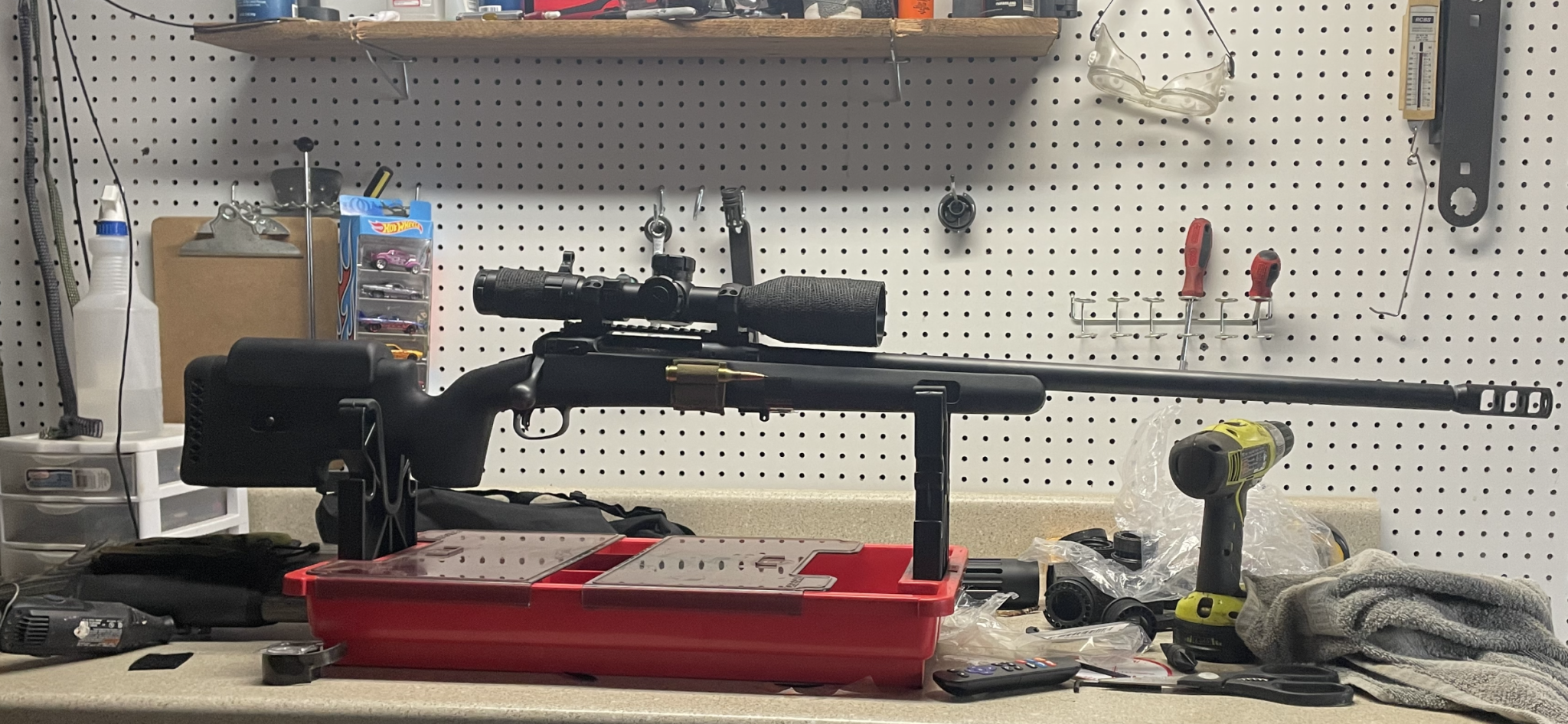

Got the Choate stagger feed long action stock. It bolted right up, once I got it together and checked function I noticed the bolt release wouldn’t work so I took a dremal tool and milled out some plastic around that area and it’s working fine.
Much better stock for longrange in my opinion.
