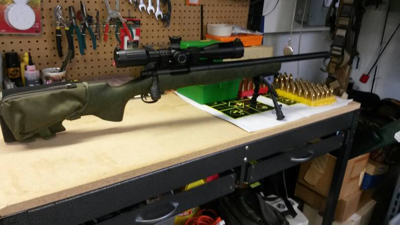

I love my AAC-SD in a B&C A3 (light tactical).
That being said, if you want a dbm its better to have it inleted (or do it yourself if you can). I tried the new PTG "drop in bdl" dbm and unfortunately it didn't drop in for me. Excellent quality part, just didn't fit my stock (I blame the stock more so than PTG). If I could do it over I'd hold off for a manners with an M5 inlet and get a PTG dbm for it. Or even look for a used McMillan.

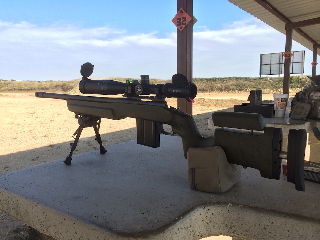

i went with a B&C A5 and then later sent it to Jeff at CDI Precision to get a DBM and inletting (great price/product). My next stock will be a AI AX ($$$) but considering it comes with a DBM builtin, not that much more than buying them separately. Manners and McMillian make great stocks but there are other options and paths too.

my R700 AAC-SD 308
I went with the #2956 Hook and love it. Bedded it myself with Devcon. Shoots the 168 vlds better than anything. But on my AAC SD , the throat is so long I just couldn't justify putting a DBM on it. Hell, my hand loads would be wayyy to long. But for factory stuff I can see the appeal.
