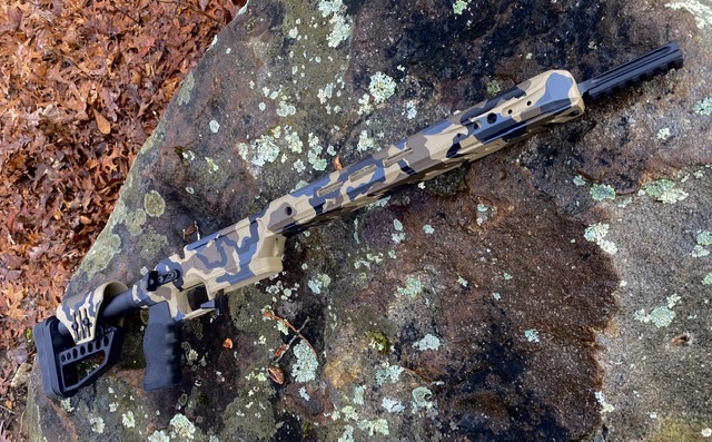

Order a base color and have ceracoted in any patern u want. Would be my Choice hard to beat a manners

I did this for a friend of mine.
