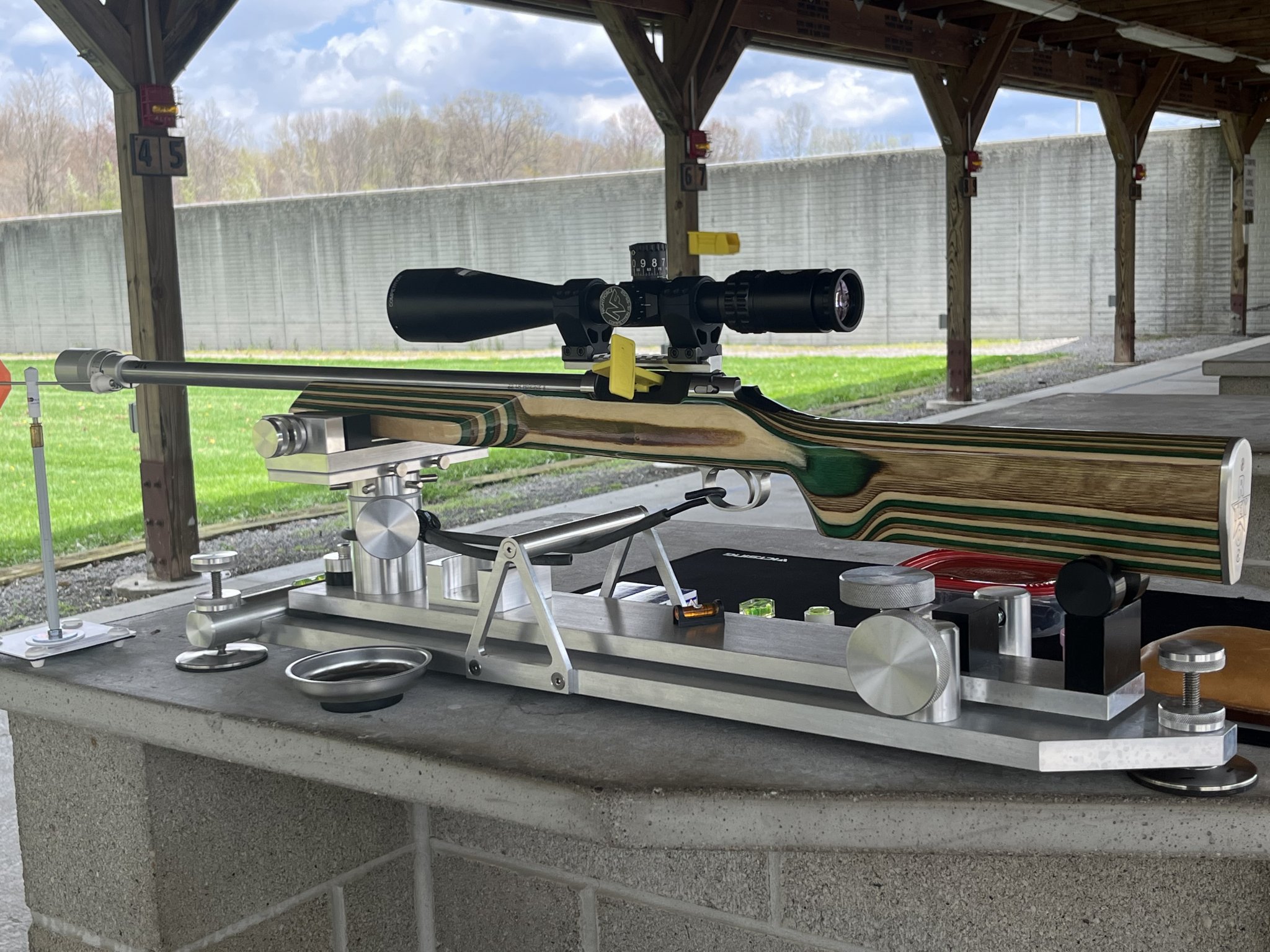

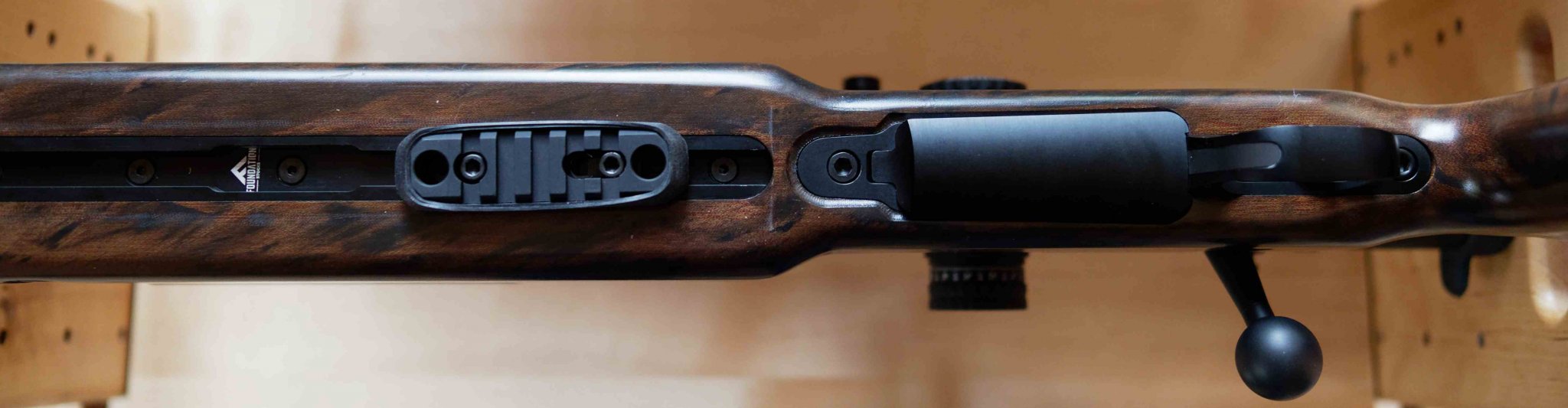

@justin amateur
LOL. My wife calls me the anti-handy-man. Less seriously, a stock/chassis is part of a weapon system, a.k.a. rig, and I want to determine the accuracy of more-or-less standard rigs with the degradations from marksmanship and the environment minimized.
First up is a Vudoo single shot in a Foundation Centurion stock. Attachments show the underside of the Centurion stock and the weapon system. Since not intended to be a benchrest stock, the flat part of the buttstock parallel to forend is a only small interval very near rear of buttstock. Thus the forend extends way beyond front rest. To provide a stop used a picatinny rail in the Foundation enhanced UIT. The two ranger bands wrapped around the picatinny rail are for vibration mitigation.
Using non-lot tested box of Center-X I have no idea how many shots can be kept within a 1MOA diameter disk at 198yd. Hope to do the determination next week.
Good shooting, Rick
Cliff Arnold
@gkgeiger
It looks like you are able to change the length of the bungy cord with a device whose name escapes me but is used to adjust length of cords in backpacks. Could you please provide details. One of the variables would seem to be the force the bungy cord exerts on trigger guard, all the way from 0.0N for true free recoil to some finite value for bungy cord constrained recoil.
Many thanks, Rick
View attachment 7857891Even my custom Stiller 2500 in a Rotex stock has a little slope in the rear. You might look at a McMillan BR50 stock.
@gkgeiger
It looks like you are able to change the length of the bungy cord with a device whose name escapes me but is used to adjust length of cords in backpacks. Could you please provide details. One of the variables would seem to be the force the bungy cord exerts on trigger guard, all the way from 0.0Nm for true free recoil to some finite value for bungy cord constrained recoil.
Many thanks, Rick
Not sure exactly what you want but I just put enough tension on it to return to the forward stop after every shot. That’s one less thing to think about.
By the way, the rest has a roller top, and if fired free recoil without the bungee the rifle would probably be on the ground
Reactions: JimTN
How the bungy cord is attached to the mast. It does not appear to be tied.
One easy method to attach a bungy cord is with a hose clamp. Find one that fits the diameter of the rest post. You can easily make adjustments to the bungy length with a screwdriver or 1/4 in nut driver. Let me add that the clamp needs to be a bit larger than the post so you can slide the bungy between it and the post. Really makes it easy to adjust tension.
Reactions: rick137
