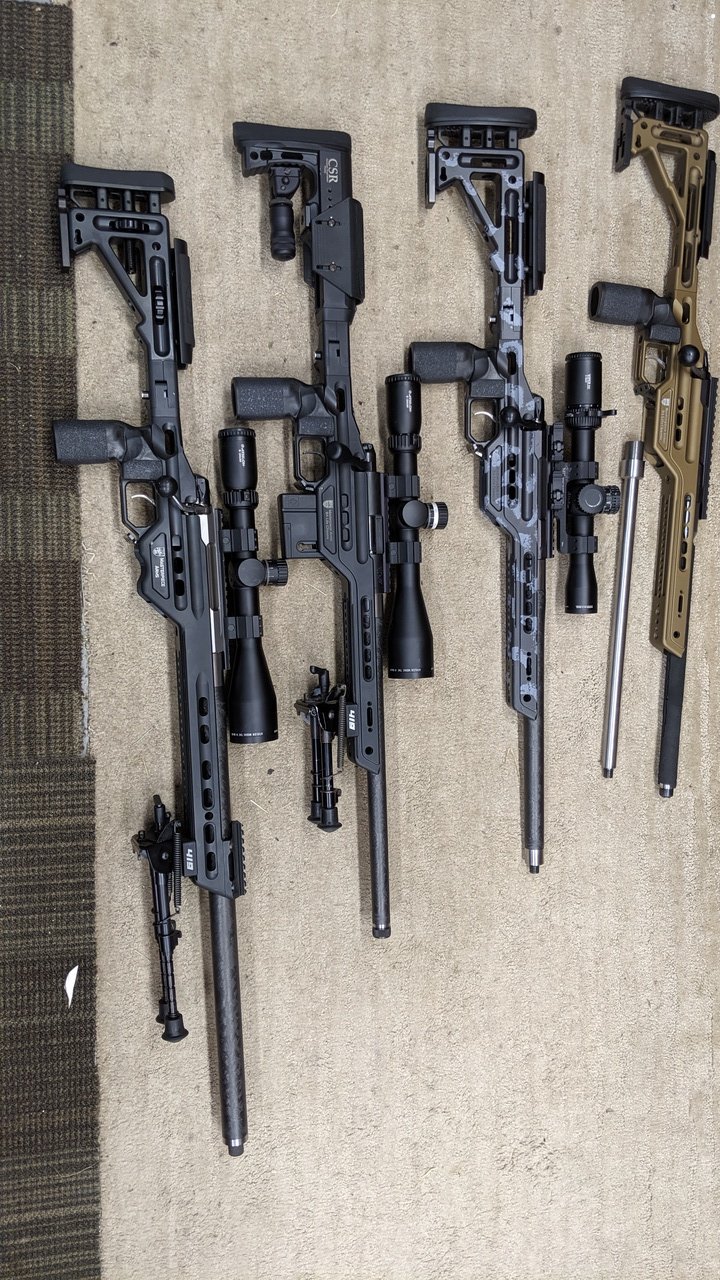

I've had alot of the various stocks and chassis out there. Manners PRS1, T4A, some other manners variant, XLR, KRG, and MPA. All those are good, but to me the MPA chassis were the most well thought out and comfortable chassis of all the ones I tried. I have 3 folding versions and all lock tight and for all around shooting give me the best results. I've been selling off all the others and now have 5 MPAs, with one on the way. Hands down, my favorite.
