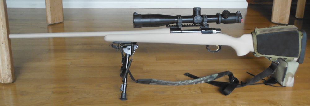

I have bought (4) High Tech Specialties [Bansner] stocks
High Tech Specialties Stocks
HIGH TECH SPECIALTIES at Brownells

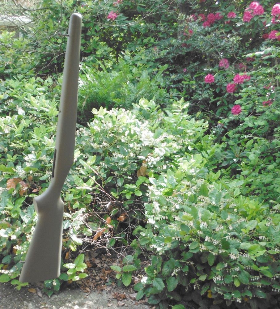

Lately, I have been painting the stocks and stainless steel barrels with Aluma-hyde-II
ALUMA-HYDE® II | Brownells
MSA Safety Works 817663 Multi-Purpose Respirator - Amazon.com
Amazon.com: Safetouch Powder Free Latex Exam Gloves, Non-Sterile, Medium: Health & Personal Care
Amazon.com: BRAKLEEN Brake Parts Cleaner, 1lb. 3 oz. can, Case of 12 (05089F-C): Automotive
The instructions for the paint say 65 degrees F minimum 70 degrees recommended.
I waited for 8 months for the weather to get up to 65 degrees in the Seattle area.
I would recommend waiting for 75 degree weather.
The paint is some kind of one part epoxy, and I would recommend a respirator and gloves.
The Bansner stock is as good as any stock when finished, but it is half the price and 10 times the work. There used to be a "How it's made program episode or two on youtube that showed Bansner on the lathe or his worker on the stock mold, but they have been taken down. The Bansner company ships stocks right out of the mold. The bansner rifles are expensive, because they finish the stocks. I think that the Kimber Montana rifle model uses the High Tech Specialties stocks from Bansner.
It weighs 20 ounces and is stiff.
