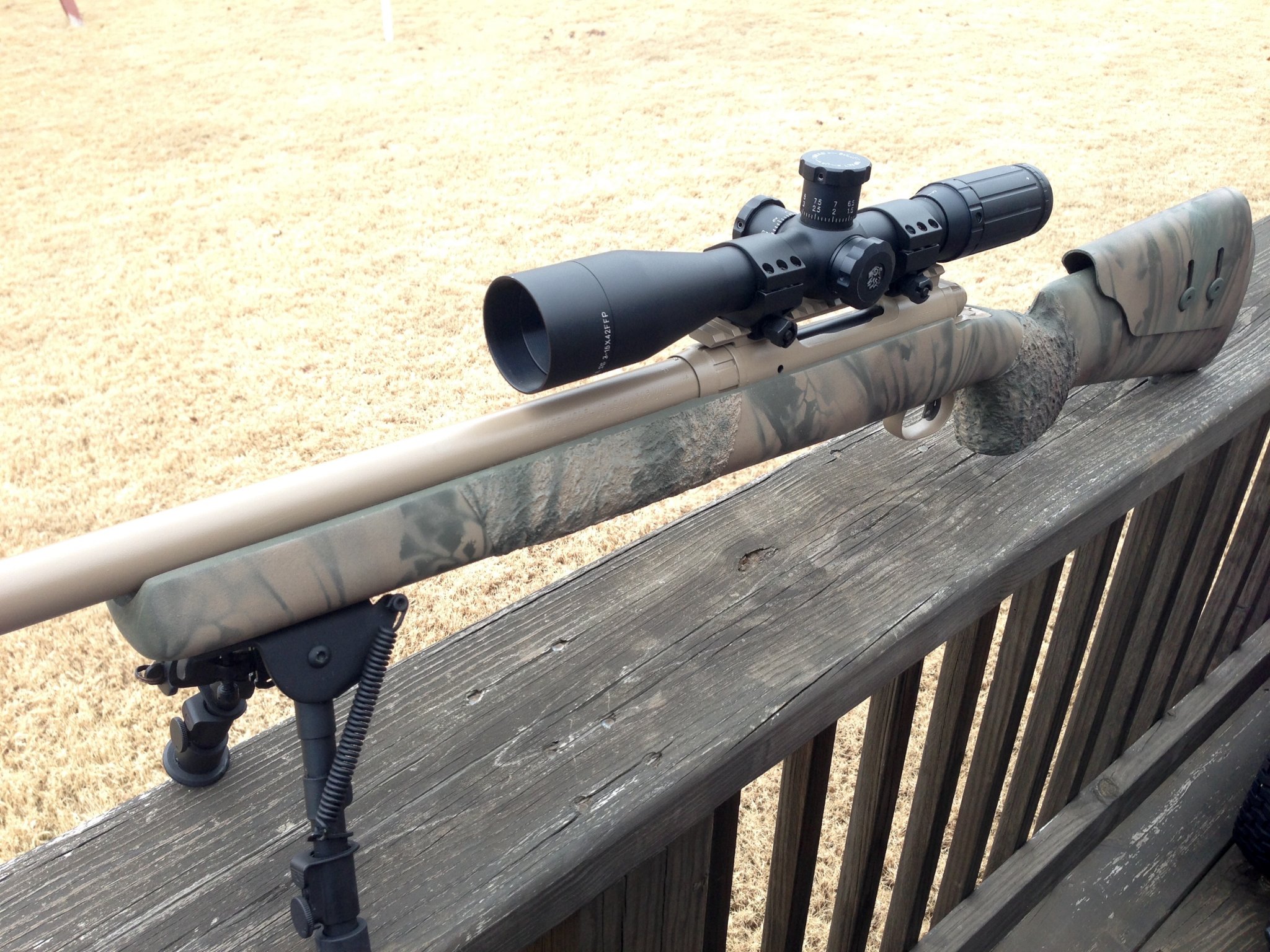

Here’s one I did on my old “test” rifle. I did all kinds of DIY projects on this thing.
