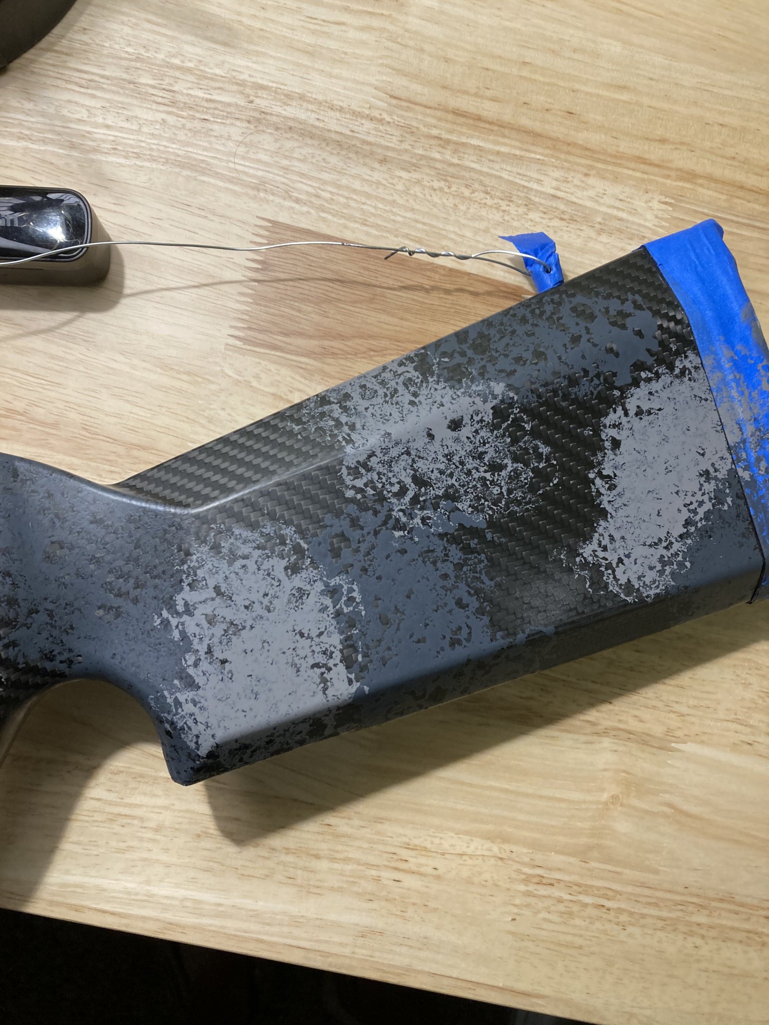

This particular stock only comes in a black carbon fiber look. Wasn’t a fan of the look, so I did a sponge paint job on it.

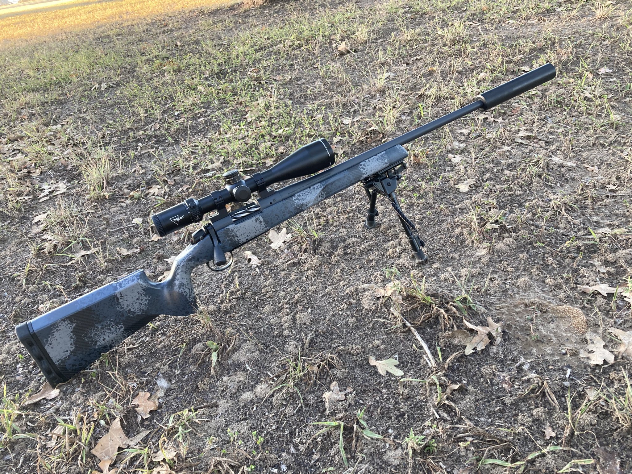

I’ve have it out a few times and really enjoy shooting this gun. The stock has zero flex and kept this particular hunting rifle down in the weight zone I was looking for without spending a bunch of money.

Thanks for the info. You nailed the sponge camo!!! Looks professionally done.
Is that what they call varmint/ tactical contour barrel inlet? No fit issues there?
Thank you! Yes, this is the tactical/varmint contour. The barrel fit very well without any sanding or dremeling

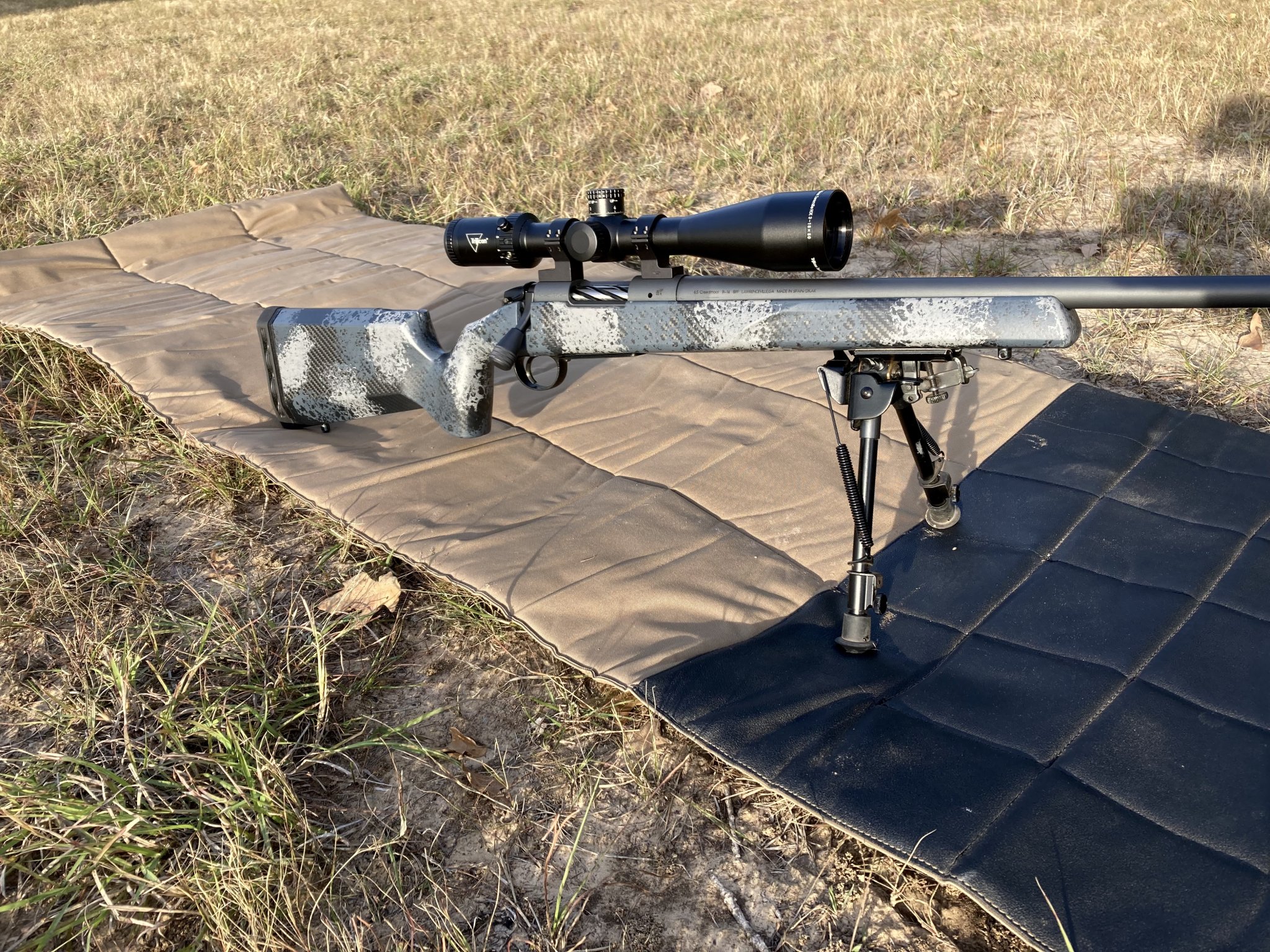

One more question. No complaints on cheak weld? Looks like you have fairly high mounts as well.
I have the same scope on 2 other 700’s, and was able to use medium mounts. One of those guns has the composite accublock stock. With this Bergara I had to use high mounts as the bolt knob was hitting the scope. For me, the cheek weld works well with both the medium and high scope mounts. I couldn’t get comfortable with the factory Bergara stock that the gun came with.
