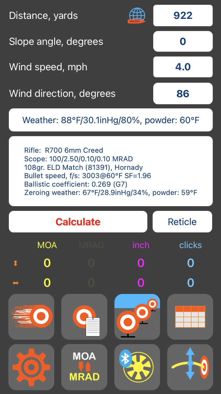

I was at a match this past weekend and about half way through I looked at my StrelokPro app and my mrad column was gone. It wasn’t totally gone, but the brightness was so low I can barely see the numbers. Moa, inch, and click columns are all still bright like they should be. Anyone experienced this or anything like it? Everything still functions as it should you just can’t see the numbers, even sitting here in the house now.
That worked! I had tried tapping it but not holding it down. Thanks bud

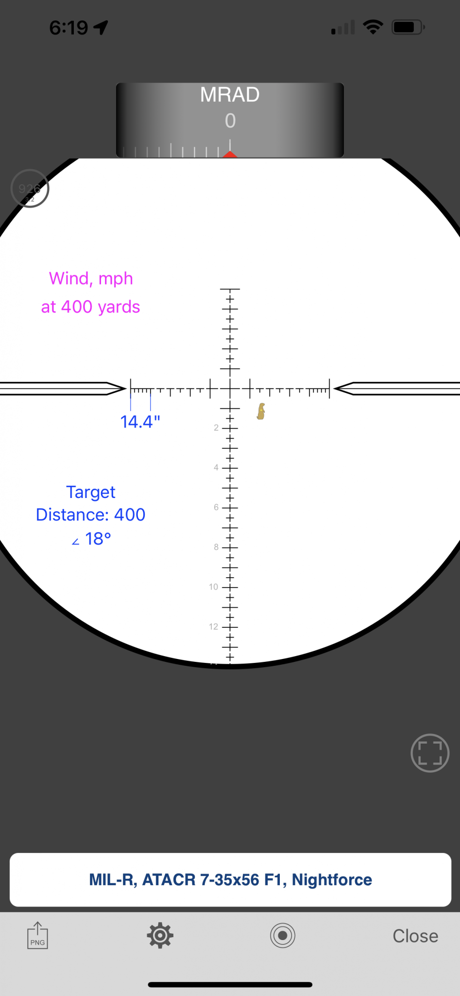

The other thing is on, say, the Nightforce Mil-R reticles (and various random others) I cannot get the wind speed to display nor the 10, 5, 2 mph curves. Tried three-finger tapping too.

The other thing is on, say, the Nightforce Mil-R reticles (and others) I cannot get the wind speed to display nor the 10, 5, 2 mph curves. Tried three-finger tapping too.
Oddly enough I was helping someone on an iPhone after a match this past weekend and couldn't get it to show the wind curves on a EBR 2 reticle.

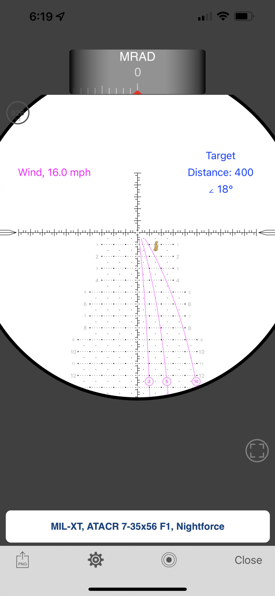

I have no problems with the wind lines on both MilXt and SKMR3. They are visible and can be removed doing the three finger tap. But, I'm pretty "experienced" with the three finger tap.🤠
Ah, but I was referring to the Mil-R. I too have no probs with the NF Mil-XT (or Mil-C, for that matter).

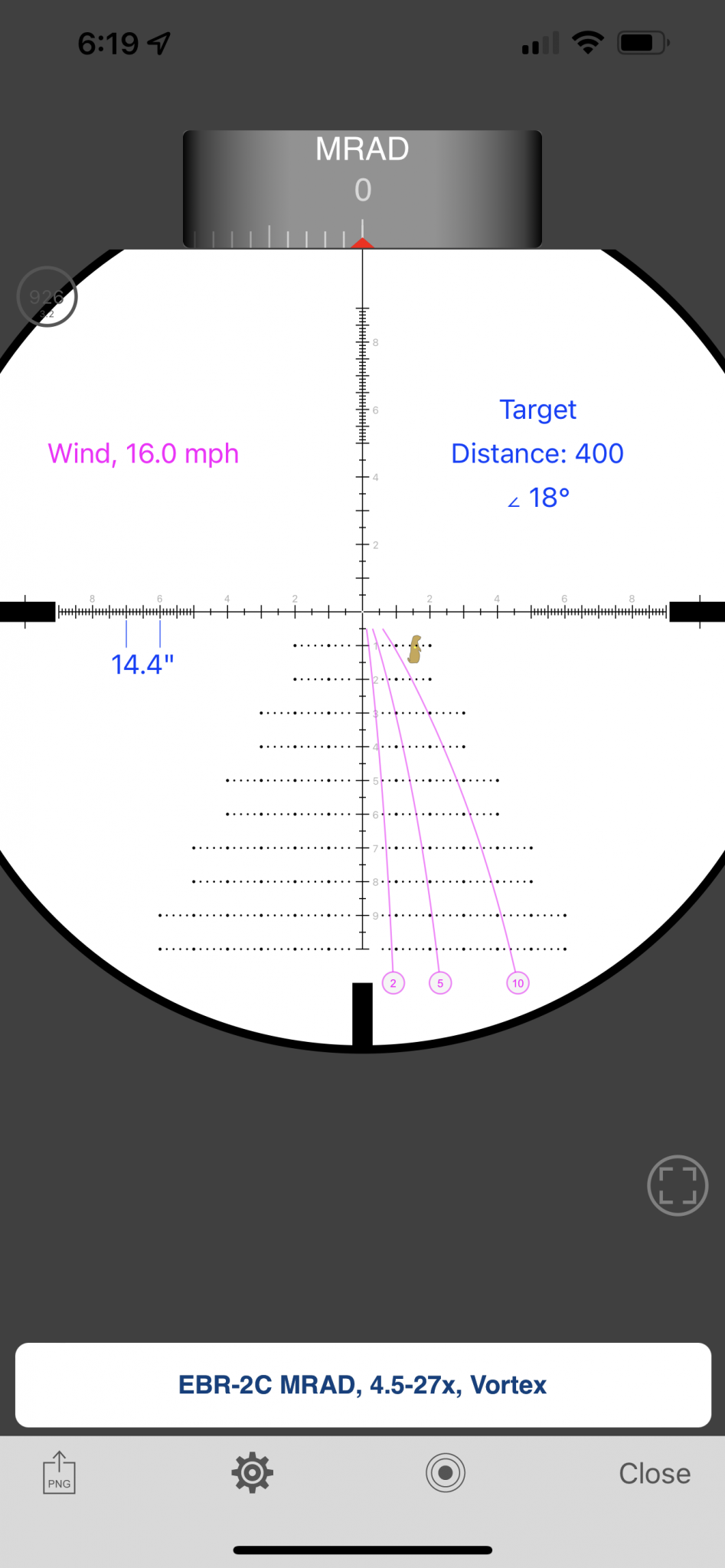

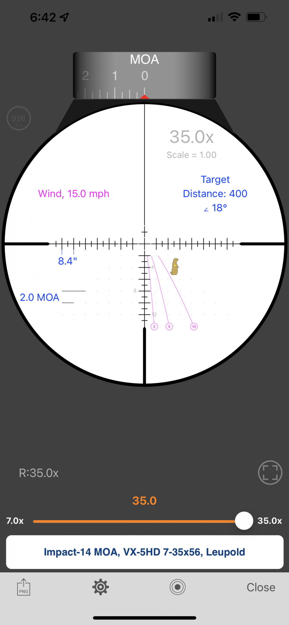

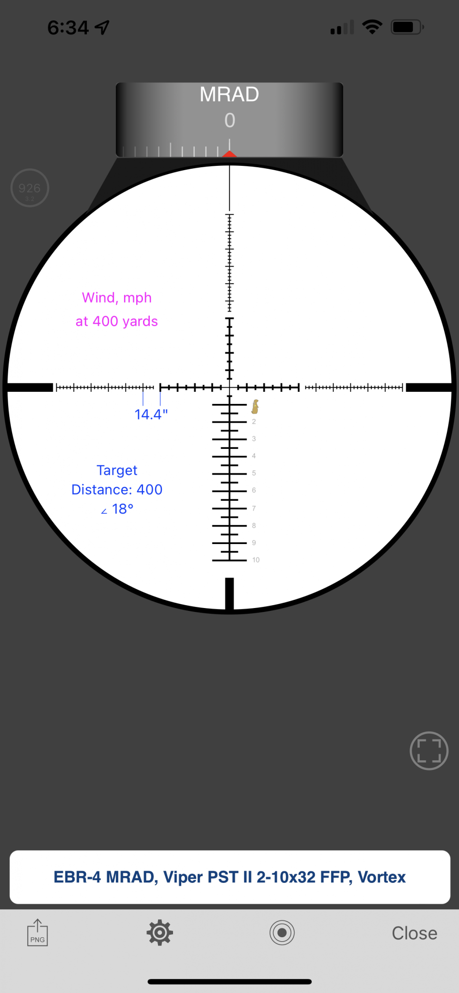

Without changing screens and just flipping between reticles via the bottom drop-down, here’s how the purple wind lines disappear on some reticles.
On the Mil-R and EBR-4 reticles you’ll also see the wind mph number disappear. This happens on some other reticles as well…just can’t remember which ones.
Edit: just noticed on the reticles that have missing mph numbers the distance is put in there twice (in blue AND in purple).

Wind curves are shown only on Christmas tree reticle types.
Interesting. I would prefer the wind curves on all reticles, but that’s me. It helps with a quick visual reference for wind holds regardless of the type of reticle.
In either case, I would change the lingo on the non-xmas tree reticles from:
Wind, mph
at XX yards
to something else. I’d like the wind speed.
As it stands it looks like a bug and regardless of the wind curves it would be a handy reminder as to the wind setting.
