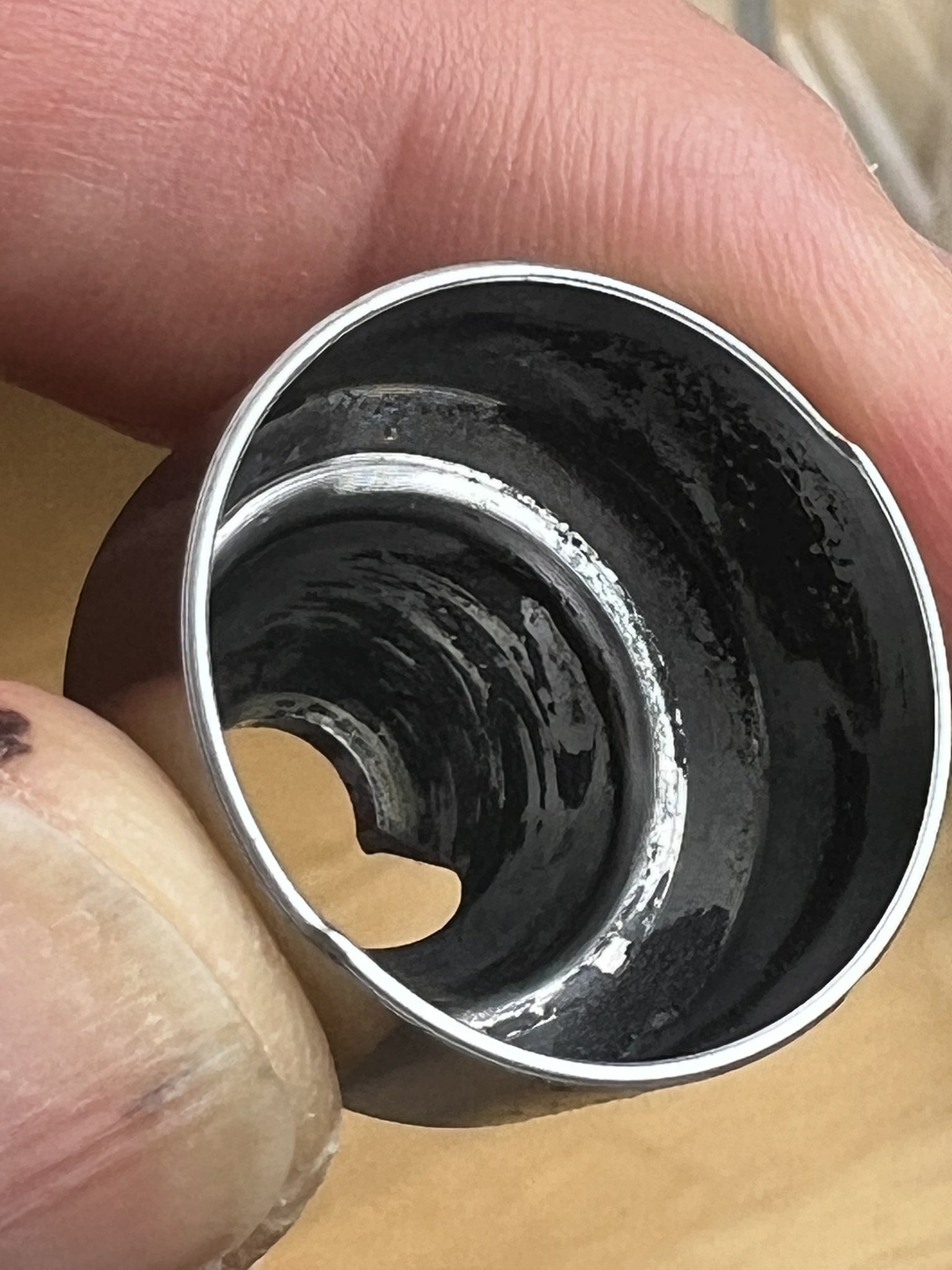

Hello All,
I'm new to rimfire suppressor cleaning and already screwing it up. I have a TBAC that I've put about 100 rounds through. Disassembled it and put it in the ultrasonic cleaner using aircraft-safe Extreme Simple Green, 40 degrees Celsius for 30 minutes. Most of the crud came off and I tried brass brushes with CLP and 99% isopropyl alcohol but the last boogers refuse to leave. Any suggestions? Not sure if it's lead or carbon.
Thank you in advance.

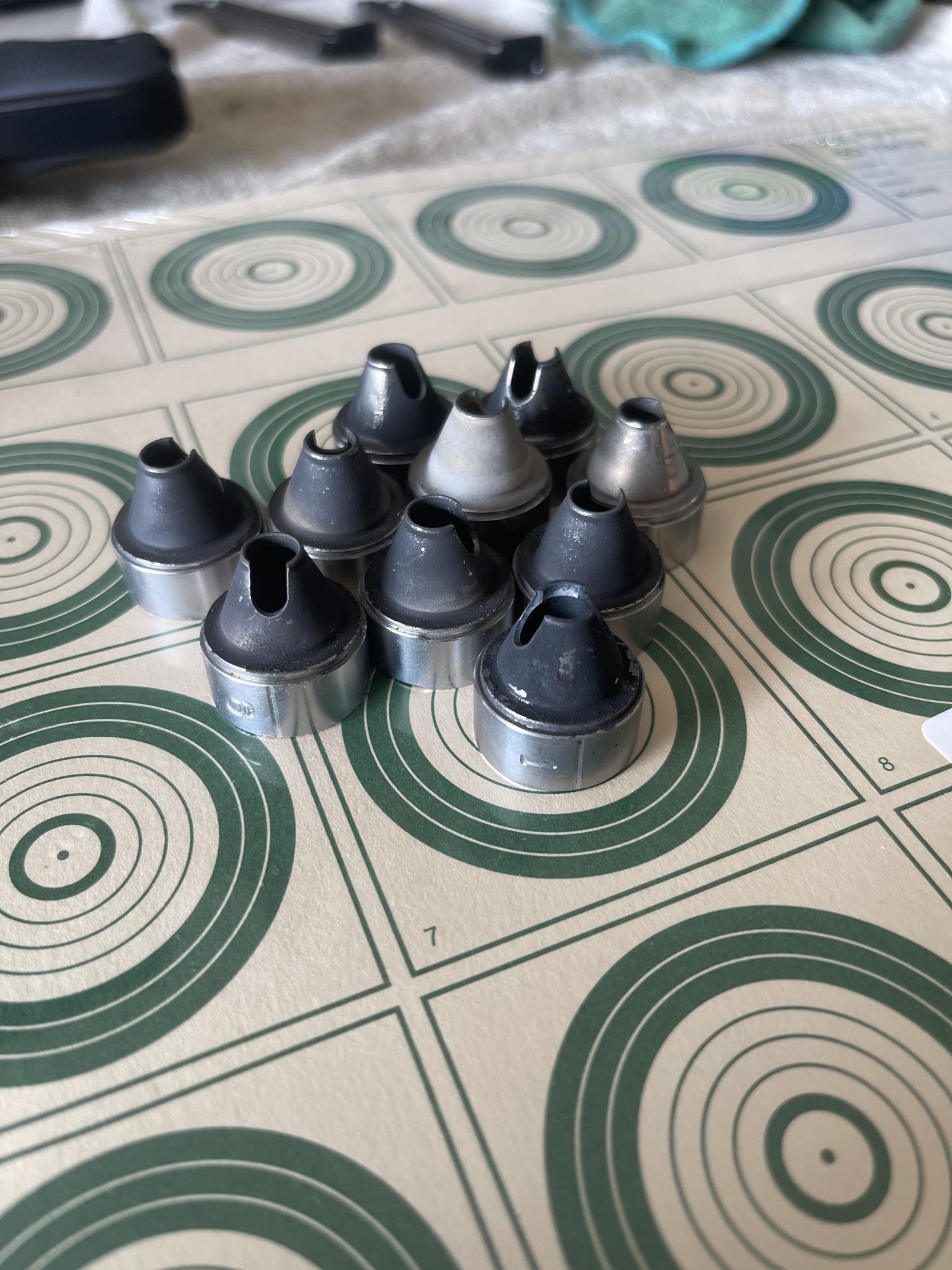

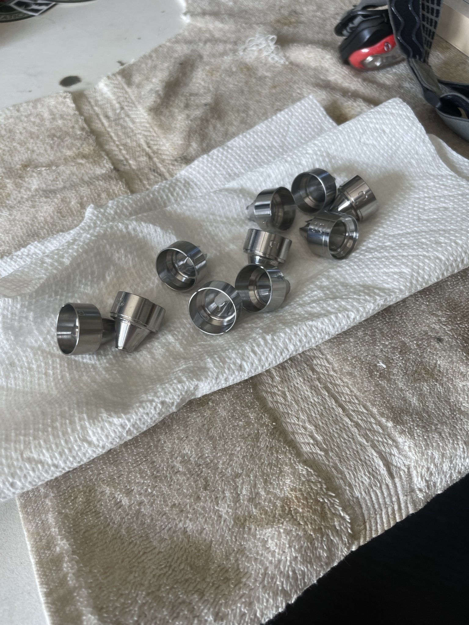

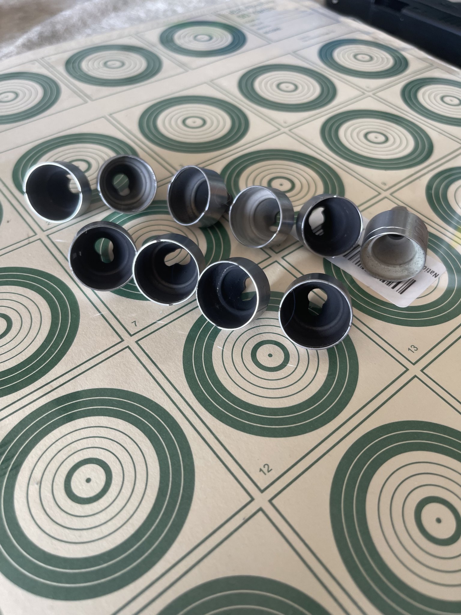

This is 10 minutes in clr then rinsed with warm water and brushed under the water. Let dry. Hit with a touch of rem oil and reassemble. Couldn’t be easier
Probably 300 rounds of SK match fired that day prior to cleaning
