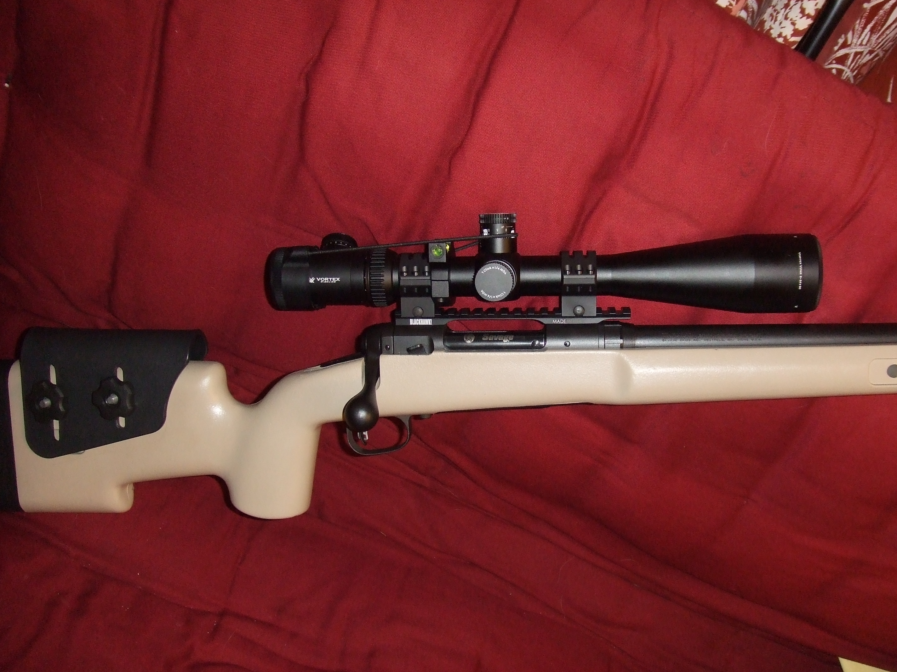

I'm more of a match shooter but I do have several (well, according to my wife, WAY too many) hunting rigs, but my $.02 worth here would be to see if anyone you know has either setup...or maybe BOTH...and shoot them, handle them, see how they fit YOU and your shooting style. Then make your choice. Me, I must have been the ergonomic model for Choate Machine when they made some of their stocks..they fit me just right, are the right weight for THE KIND OF SHOOTING I DO and have never caused me any sort of "fitting grief". I'm not nuts about the black material, but the aluminum bedding and all machining seems to be pretty danged good. (not to mention that I am a cheap sucker and they are pretty reasonably priced) DSCF0247.JPG I just clean them up and paint to get the "look" I want. (see the pic of the .308 Savage) The only thing I have added to any of them is a Karsten vertically adjustable cheek piece and I am happy as a pig in mud with the setup. That being said, I DO have one of Gary Eliseo's Competition Long Range Prone chassis setups for a 6.5 Creedmoor I had built on order (should get it in the next 3 or 4 weeks...been waiting what seems like FOREVER!!) A couple of guys I know are shooting them in our long range varmint matches and they seem like they should suit me fine. Kind of expensive, though...mine is going to be $1000.00 PLUS!!!
