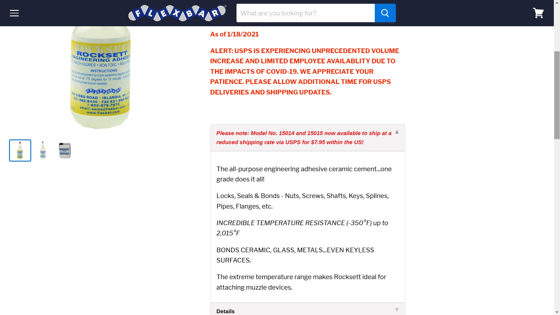

From the manufacturer:
See where it says resists temps up to 2015° Fahrenheit? Your propane torch ain't gonna do shit. And you wouldn't want to subject your barrel to that kind of heat in any case.
