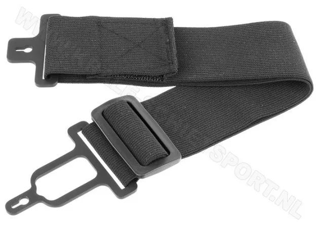

This is what 300m rifle shooters use. It is elastic and will stretch to fit all guns. Rolls up when not in use.
This long, elastic mirage band from Roedale is suitable for barrel length of 41cm (16") to 68cm (26"). The width of this mirage band is 5 cm.
More Information

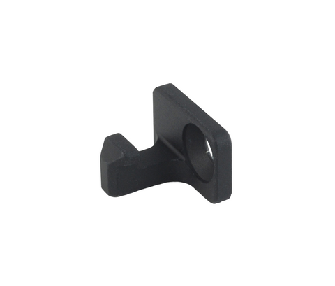

Are they adjustable? If your not using a trg 3 ring mount how do you hook the other end at the receiver?
I have a Spuhr Scope mount and it has a hook for one end and the other end goes over a screw on the Sako Muzzle Brake.
Edit: No, it’s not adjustable but it is elastic so it stretches pretty good, 19” relaxed to 36” fully stretched.
