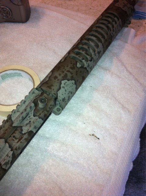

I have an AR15 that has a simple round free float tube. What I can't figure out is how to secure the tube on the nut because there is no lock ring to bind it. The tube just screws on the barrel but. I tried blue loctite and then rockset but neither would lock it in place. It was like neither would dry. Maybe because there was no torque involved? Does anyone have any ideas on what I might try? I don't want to use anything that would require heat to set it or remove it because it has been duracoated.

I bought a new tube of blue loctite and it held just fine. Maybe what I had was old and no good anymore. Here is a pic of what the tube looks like
Looks like a Yankee hill style mount, which means there should have been a jam nut with it. I'd be wary of just loctite to hold that, since that is likely to heat up in extended fire, and let the hand guard loose.
