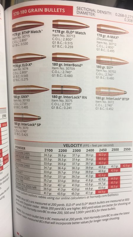

Just got some varget for the first time in over 5 years. Also just got some 178 eld x bullets. Started working up from the bottom like normal for a OCW test. At 42 grains I'm getting compression. The 178 elds are longer than the 178 amax I used to load. Coal is 2.815. Brass is R-P. Fired 4 times in this rifle. Shoulder bumped .002. Is the compression normal? Should I keep going to 44 grains? I got my hornaday manual right before the ELD came out and decided to use amax data with caution.
Max in the 10 edition is 42.4.

As a side note for you about Varget, my goto load when I still had a 308 was 45.1gr Varget with a 175gr SMK. Hornady's published loads are quite conservative which is why I usually go off of what Hodgdon's load data says. So you problem have quite a ways to go before you hit pressure signs.
