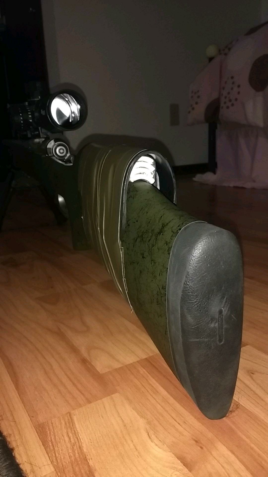

I have a B&C m40 and wanted a cheek riser. I looked at the Bradley but wasn't sure about spending $100+. I considered the saddle styles but didn't want to drill into my stock. I didn't want to exchange the stock for something adjustable. I also wanted to ensure i could always reset the height exactly if i needed to take it apart. I ended up trying pieces of a cut up PVC pipe as spacers under a kydex saddle taped on with riggers tape. The height is perfect, very adjustable and it is ridiculously solid. I put the PVC spacers inside a section of bicycle inner tube to prevent any sliding of anything.

The top of the kydex piece is notched at the front and let's me get the bolt out too.
the form doesn't look as refined as specific products but I like the function of it better than anything else I've tried.
