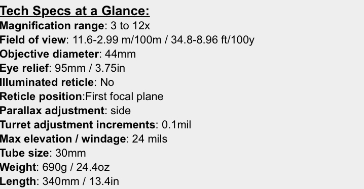

Definitely the Trijicon Tenmile 3-18x44.
They are just as durable as the SWFA, better glass though, great illumination, reticle is decent even at low power, light weight (24 oz). After much deliberation and research I settled on it as the best mid tier overall scope.

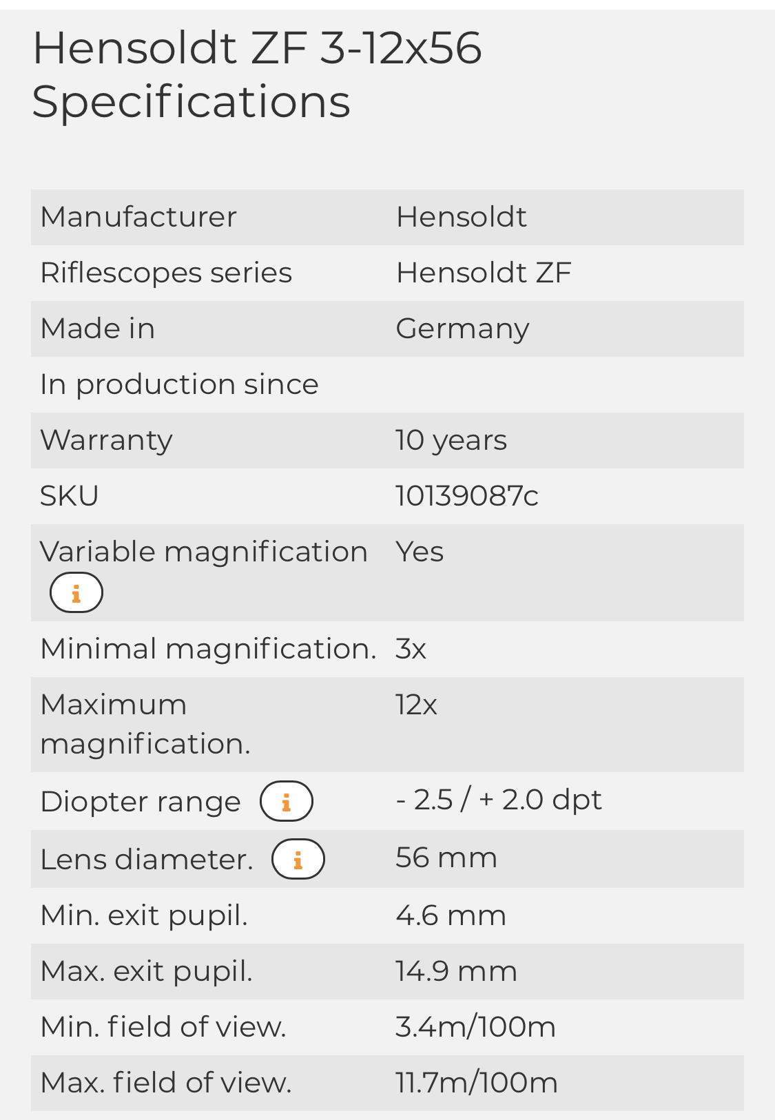

The Hensoldt ZF 3-12 has slightly worse FOV and is considered excellent (if not somewhat outdated)
