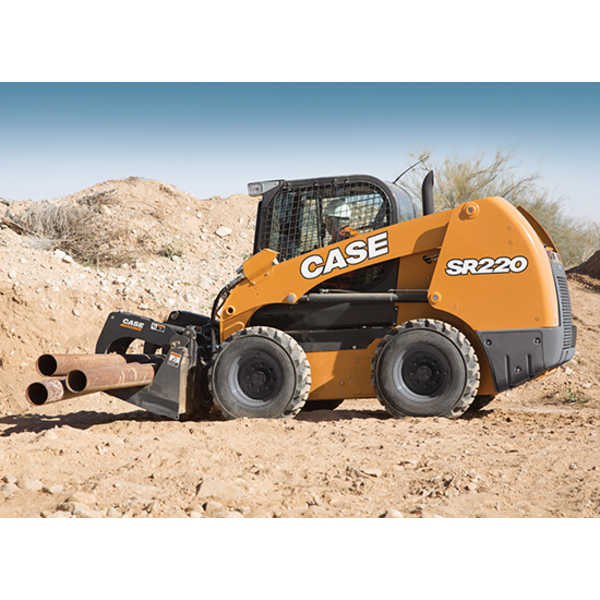

Skid steer has ZERO ground clearance and if it gets stuck (inevitable) it is damn near impossible to move.
Yea, I've run a bunch of them, geil, cat, bobcat, kubota, etc etc.
Take a good look at the ground clearance here......dunna matter if it's wheeled or tracked, same clearance.
Eek, it looks like it'd get high centered in snow.

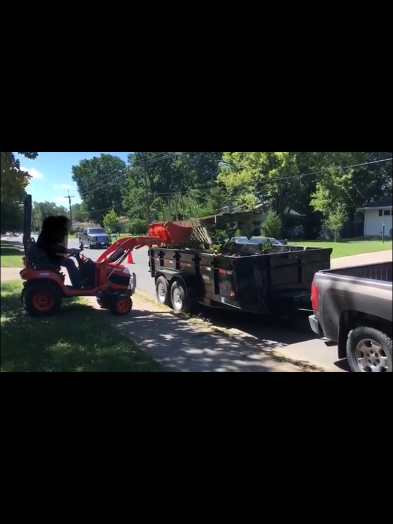

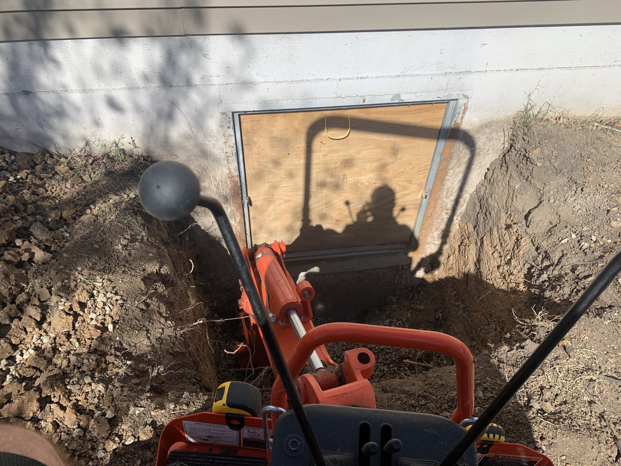

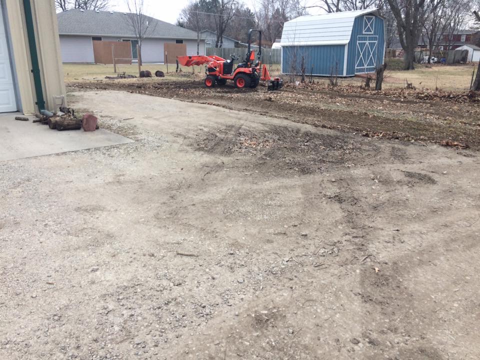

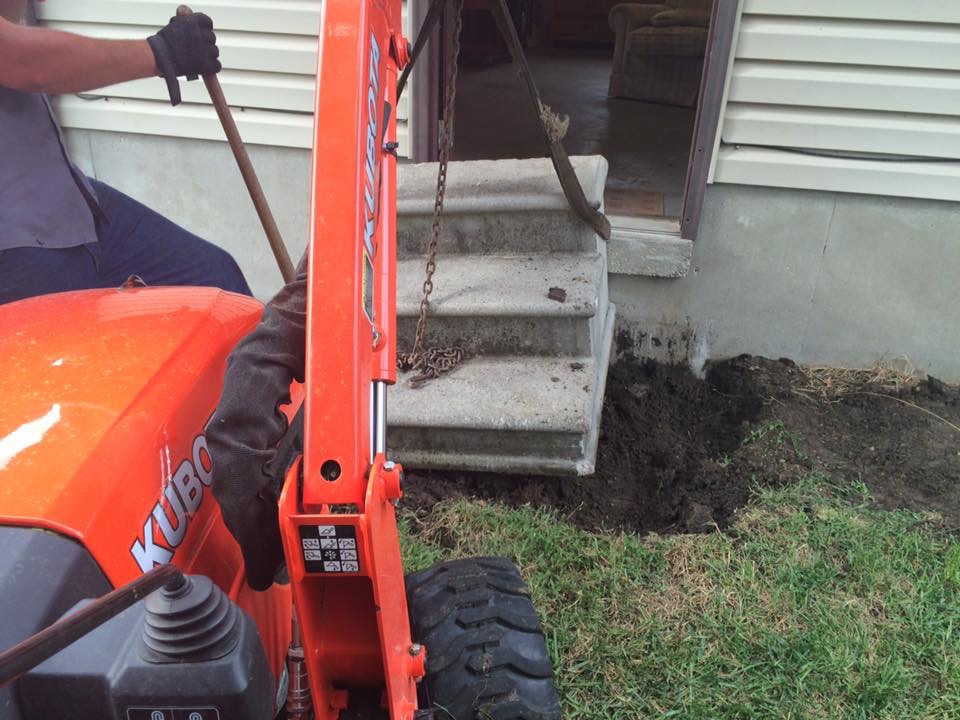

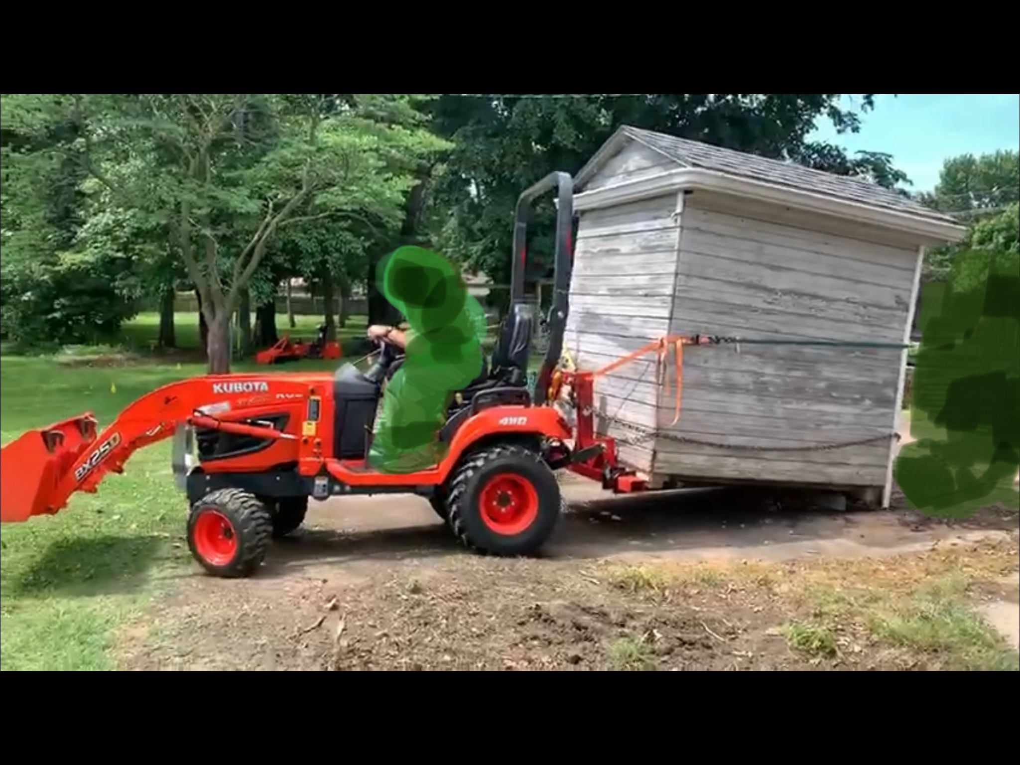

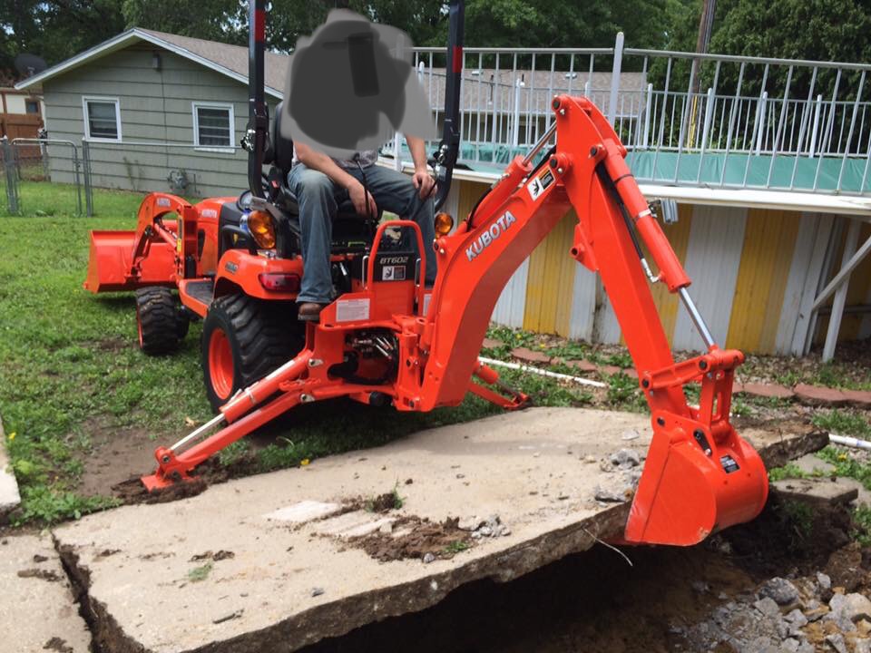

Here is some of what I’ve done with my Kubota BX25D-1:
