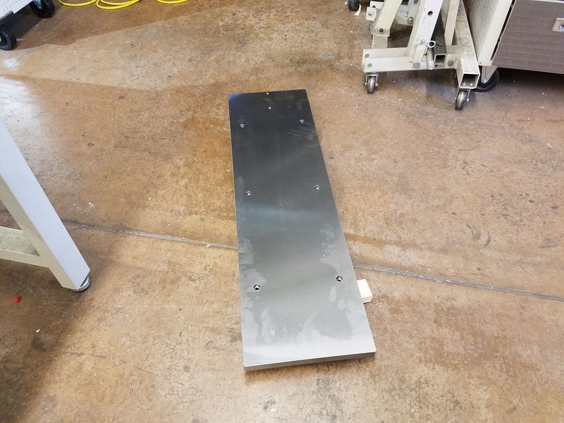

    They are finally here. Now the work starts!
    18121710_1331964140231674_242987275735514722_o.jpg?oh=9870cb19a98e02899591ad9860df12fd&oe=597C...jpg
    BIG Surface grinder. Shop in Minneapolis did 3 of em for us. Hardox 400 plate. They hated it too. lol. 3 days on a vibratory stress reliever to get it to finally stop moving around. Had to whack .045" off the faces. I chose this stuff because its nice and tough. Very abrasion resistant. Great for a sub plate in a dynamic shop where fixtures are on/off daily.
    I have been wanting to get a Hardox 400 plate setup for rows of Mitee-Bites, just dont need it enough to justify it at the moment. Hardox 400 is hard to beat for plates and fixtures.
