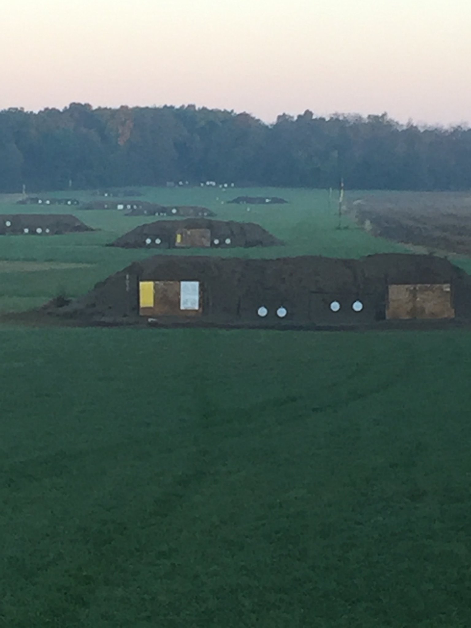

Went out to the range all day and had some fun running the 225 subs. I sighted in at hundred and move out to 600 yds with ease.The 1-6 twist barrel perform like a champ.
The 800 yd is the back right mound. I waited a couple hours to allow the temp to rise. I tried to get some video but my camera fell down because the wind pushed it face first. I couldn’t see it because I put it behind the 700 YD target in front of the 800 yds mound.
This was my shooting position I was 2 for 50

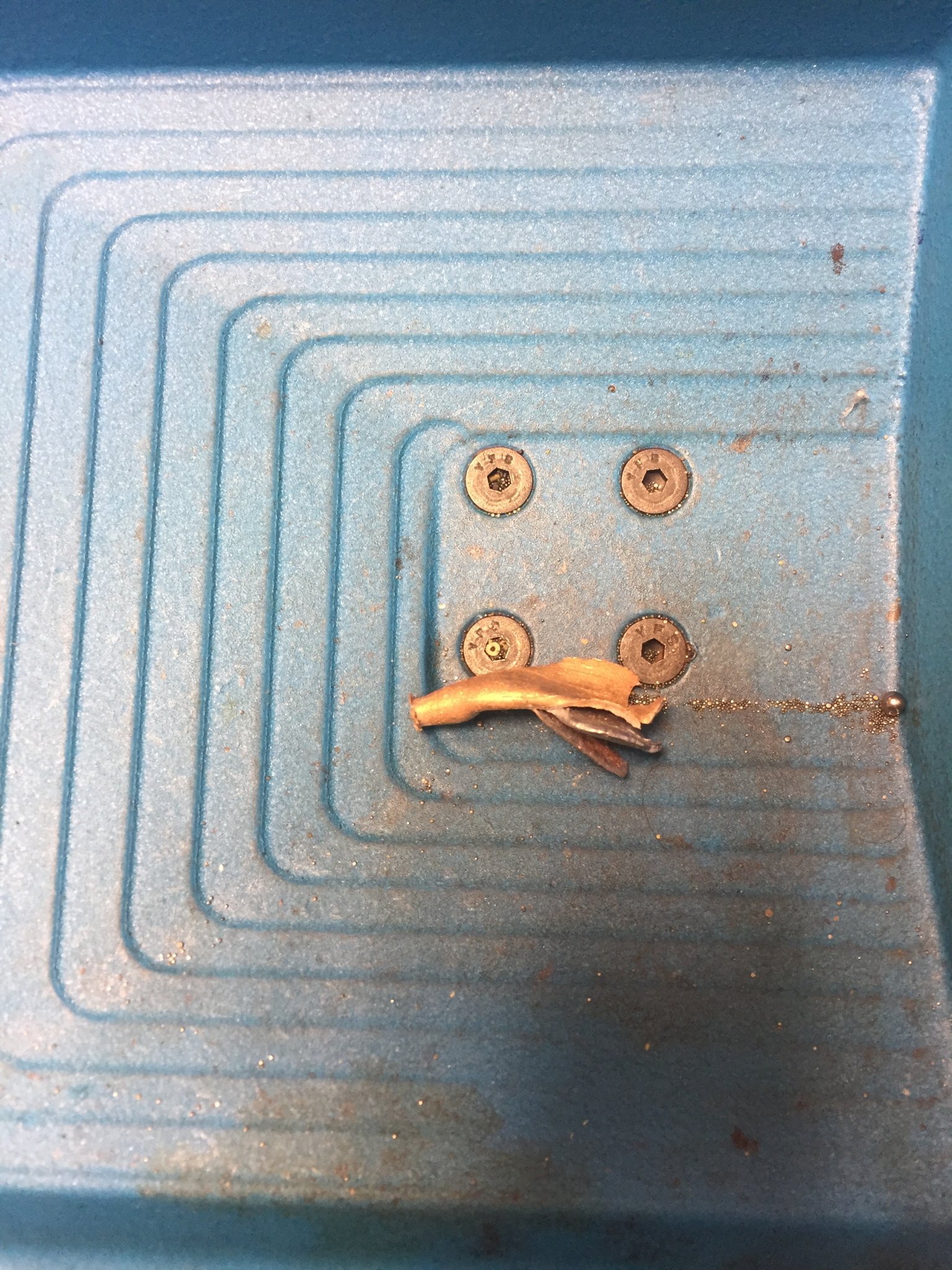

With one recovered bullet
The only big factor was the wind. If I do this again I’ll do it all my shooting in the morning. But from this experiment long range subbing should be keep at 600yds and under. From a military point of veiw if thier is one,subbing should be under 400 yds. An lastly Subbing for hunting should be 100yds max. It would be fun to have a PRS sub competition to a max of 600yds. It would keep thing fresh for all shooters.

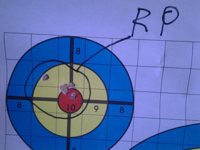

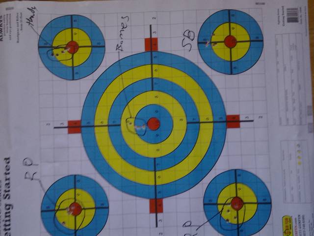

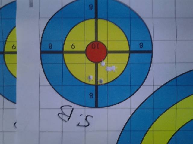

Mixed range brass shoot.
All loads 12.1 cfe blk all brass prepped the same.
It's like a box of chocolates. Lol
50 yd, rem 700aac all staying subsonic with aac can .
