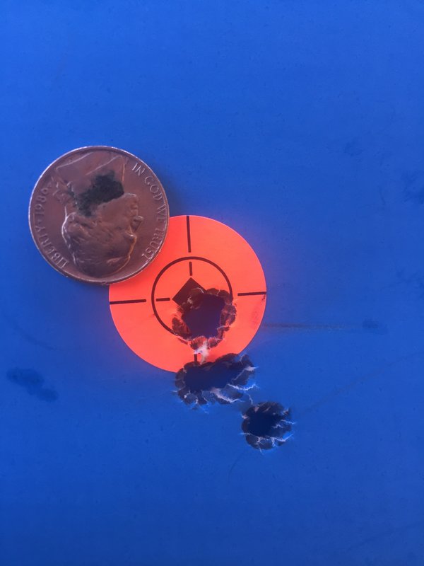

Been working on my sub loads as well . Always used TB . 10.5-11 gr and 200 SMK . 2.800" shot this group yesterday . 10.7grs remember with subs start high and work low.
