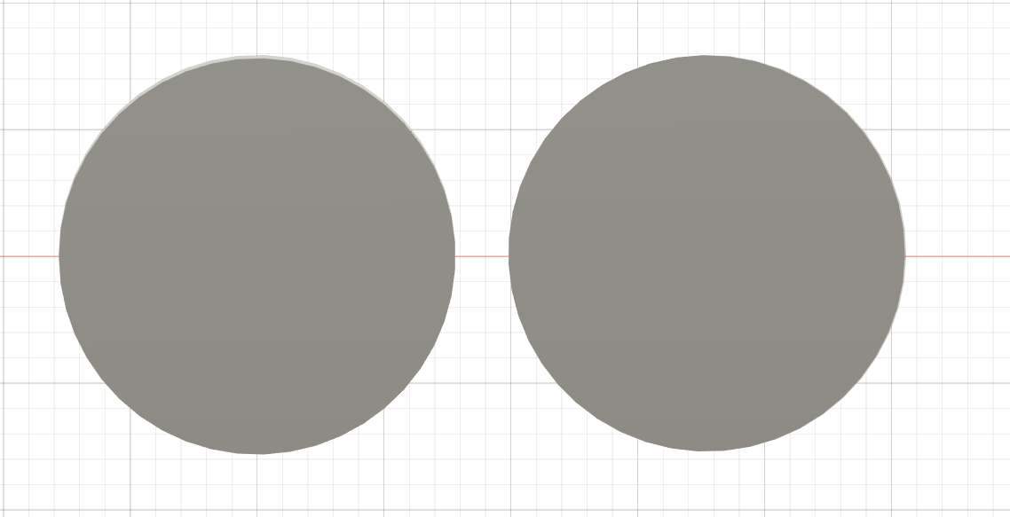

First: If your supposition that the bullet remains parallel to the bore is true, it's trivial to calculate the angle of impact of the projectile given your 16.4" drop number (.261 degrees). This will produce a hole indistinguishable from a bullet hitting exactly perpendicular to the paper. Your own explanation doesn't produce the result you think it does. I've included an image showing two bullet holes, one is yawed .261 degrees.

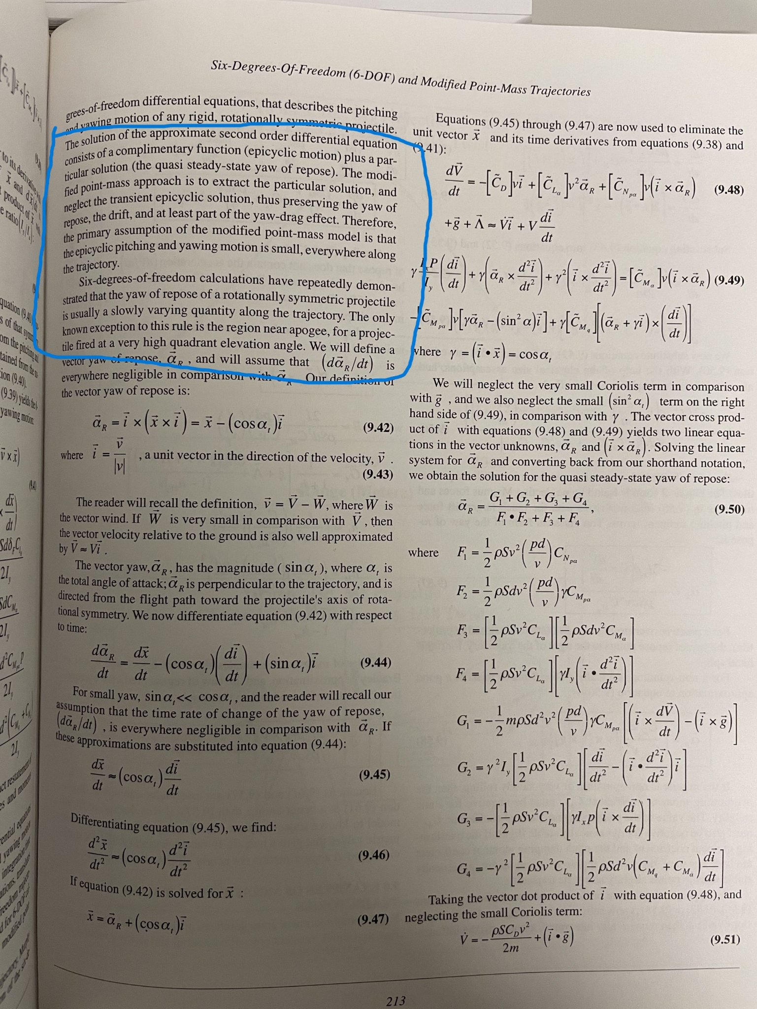

Second: Bullets simply don't fly like that. I mentioned earlier that the "average" motion of the projectile tip tracks with the trajectory. Technically speaking, that isn't quite true; the average tip motion is centered about the yaw of repose (which is generally tiny, especially at short ranges). The total yaw at any given point is the vector sum of the epicyclic yaw and the yaw of repose. You don't have to take my word for it though, straight from McCoy:

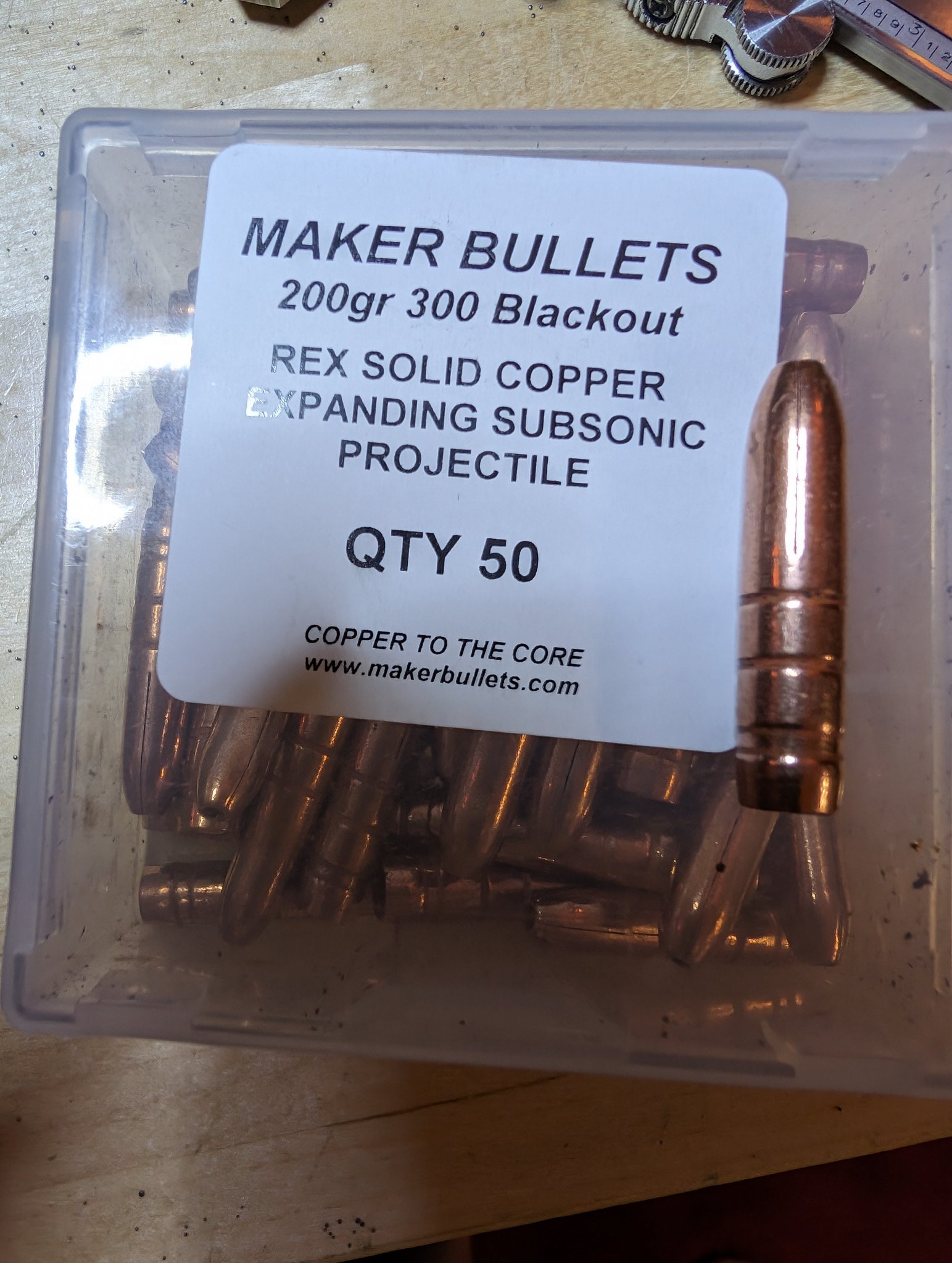

Good info. I shoot the Maker 200g Rex and it is 1.415 long and a full .30 cal for over an inch. I get oval holes at distance and believe it is the long projectile and the drop. It is consistent and more pronounced at longer range. I'm willing to bend on my theory, but that else can it be?

Good info. I shoot the Maker 200g Rex and it is 1.415 long and a full .30 cal for over an inch. I get oval holes at distance and believe it is the long projectile and the drop. It is consistent and more pronounced at longer range. I'm willing to bend on my theory, but that else can it be?View attachment 8300244
That is a super long bearing surface, so any amount of yaw will look more pronounced for sure and all bullets are flying with some amount of yaw.
If it's getting worse with range it could be a dynamic instability, no idea if those particular bullets display that behavior.
