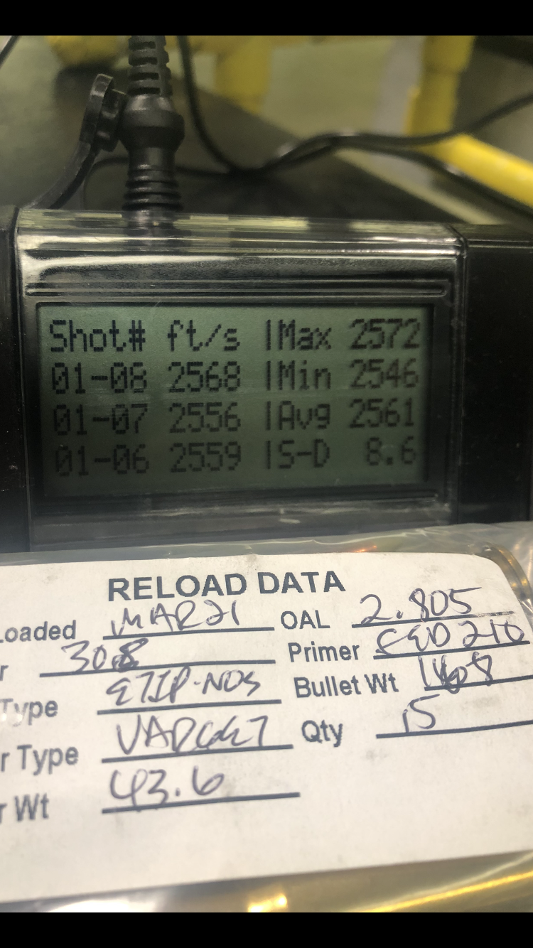

I use Varget in my Nosler ETip 168 load at 43.5 grains. It shoots 3/4 minute from two of my rifles. I will make sure my barrel is clean and run a few patches of Iasso paste through it before I try them again. This is from a 16.75 inch barrel.
