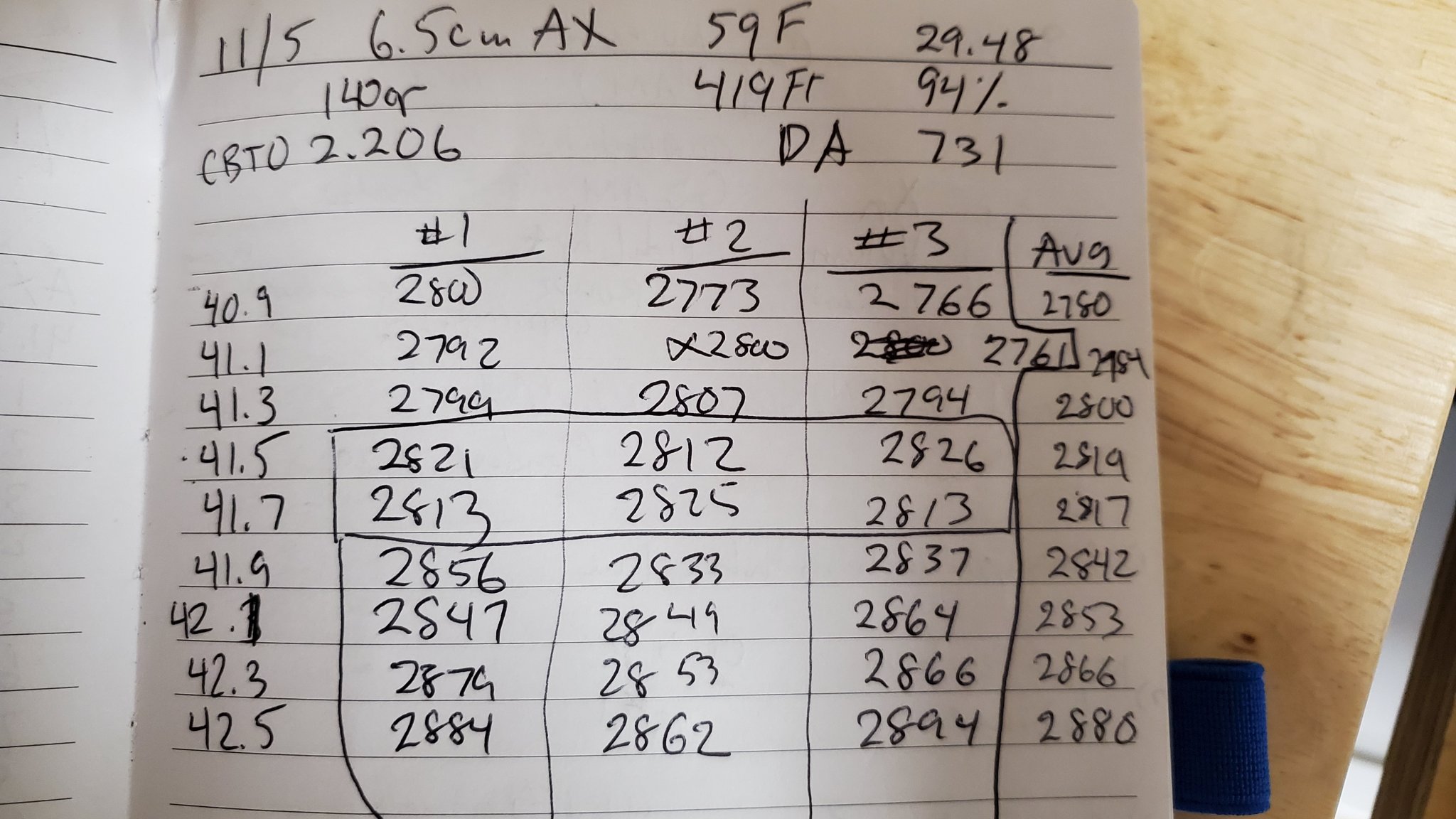

    For the next 30 rounds, I did a velocity ladder test of shooting three strings of 9 rounds from 40.9 to 42.3gr. which included three cold bore + sighting. Looked to be a "node" in the 41.5-41.7 and maybe again in 42.1-42.3. Density altitude 731ft and temp 59F.

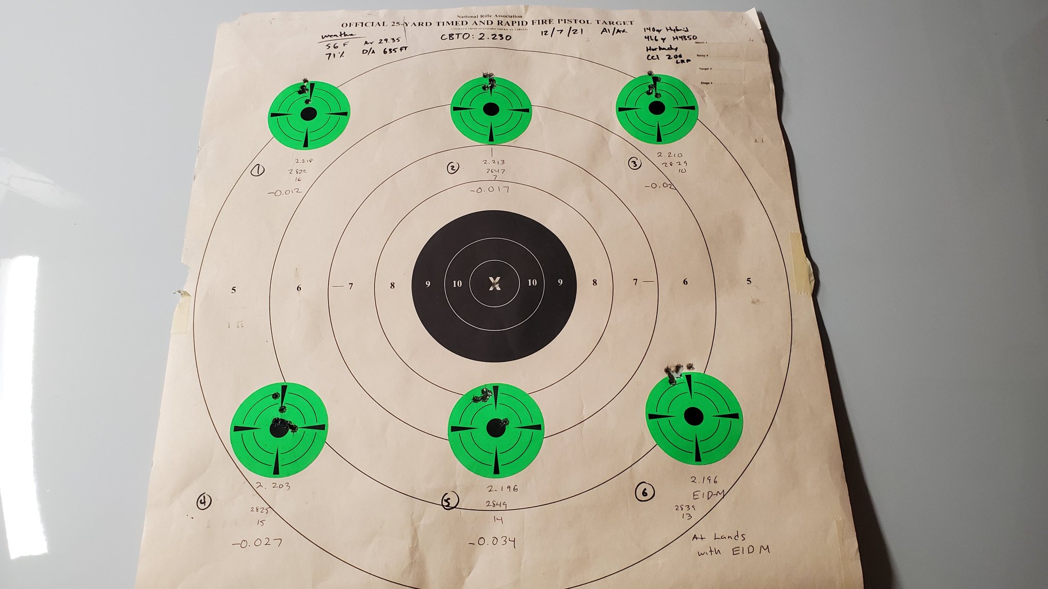

    For the next 60 rounds, I settled on 41.6gr H4350 and did seating tests with Berger 140gr Hybrids ranging from 20-85 thou off. Below is a target from one seasion...Velocity was consistently in the 2830 fps range. 350 Density altitude and temp 60F
    ....FINALLY...at 150 rounds down...I have the crazy idea to clean the barrel. This included 4-5 wet patch passes down (assume I did all proper bore guide, etc) until no more black and enough passes to dry it out. This is actually the first time ive cleaned a bolt gun barrel because usually I just am told to leave it....for whatever reason...I didnt.
    Today I went back for another 30 rounds of seating test from 60-85 thou off. I upgraded to a Fx-120i and wanted to see if my velocities were more consistent having spent $800 for to upgrade from my $150 frankford arsenal scale.

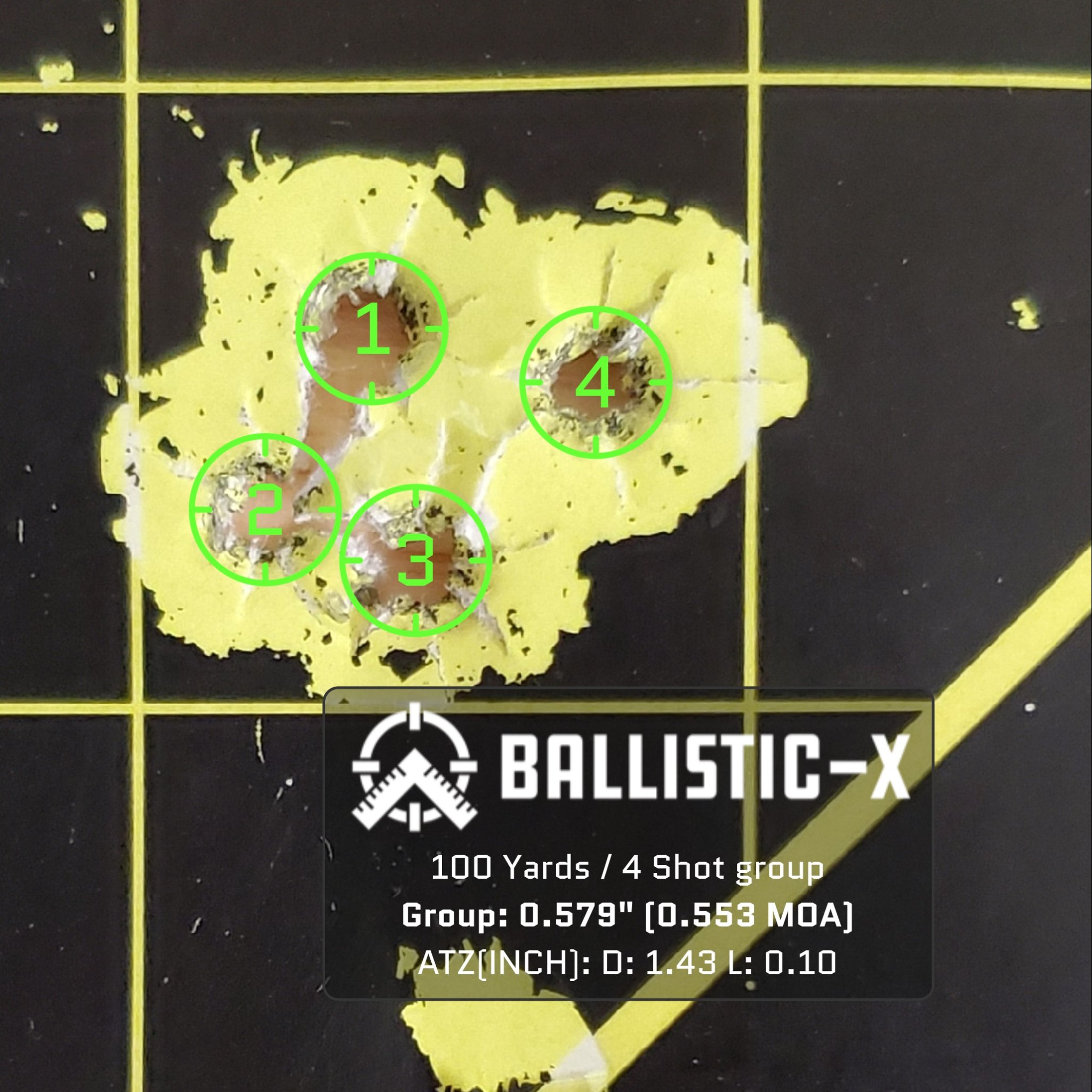

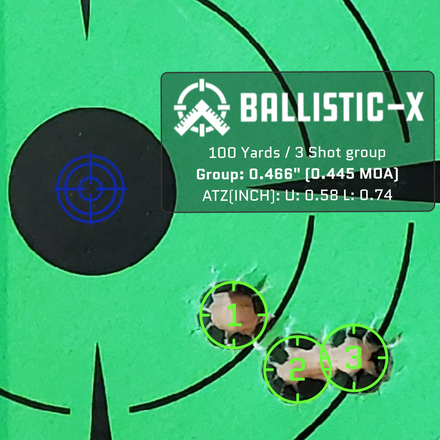

    FWIW,
    Top is 41.6gr H4350 weighed on the new FX after barrel cleaning. Only three shots...
    Bottom is 41.6gr H4350 weighed in the old Intellidropper. Only four shots... similar accuracy.
    Accuracy is as good/decent/poor as before, but the velocity falling off a cliff when all you ever hear is barrels "speeding up" as they break in is super puzzling

    Seating depth + weather could’ve caused that swing.
    You said you had started with “20-65 thou off” early on, then later went to “60-85 thou off”…. that plus the other factors (weather + less carbon post cleaning) might have done it.
    A longer bullet-jump can lower pressure, which will lower speeds.
