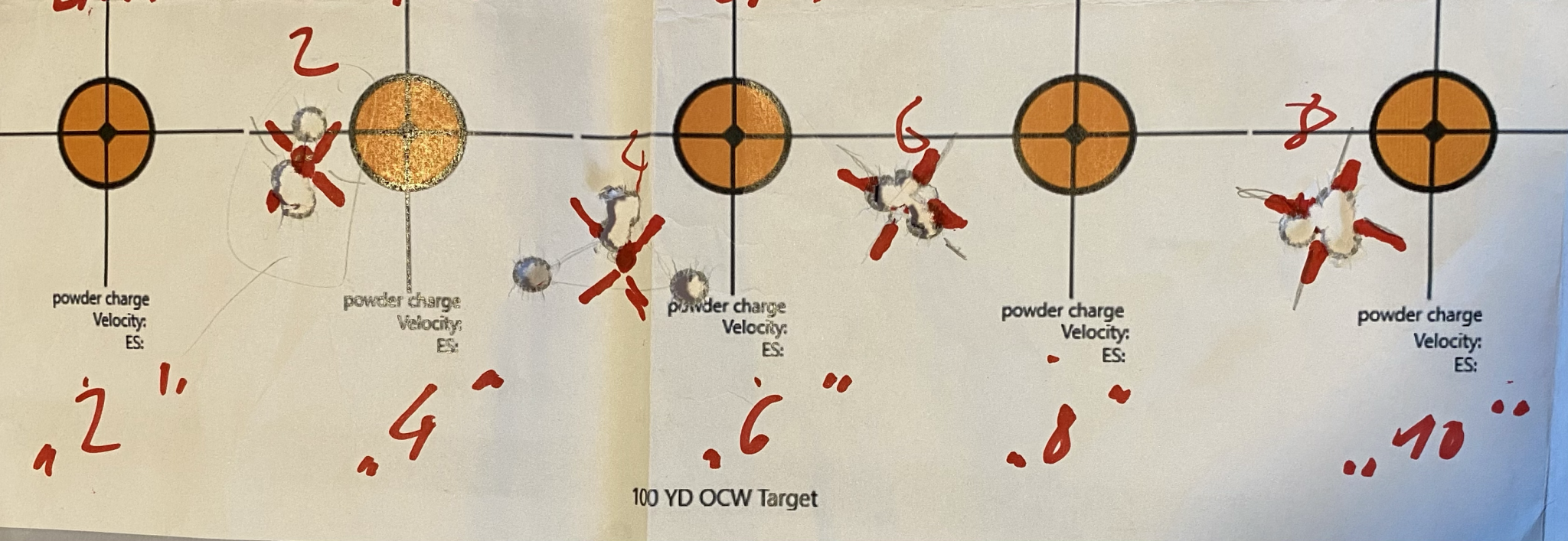

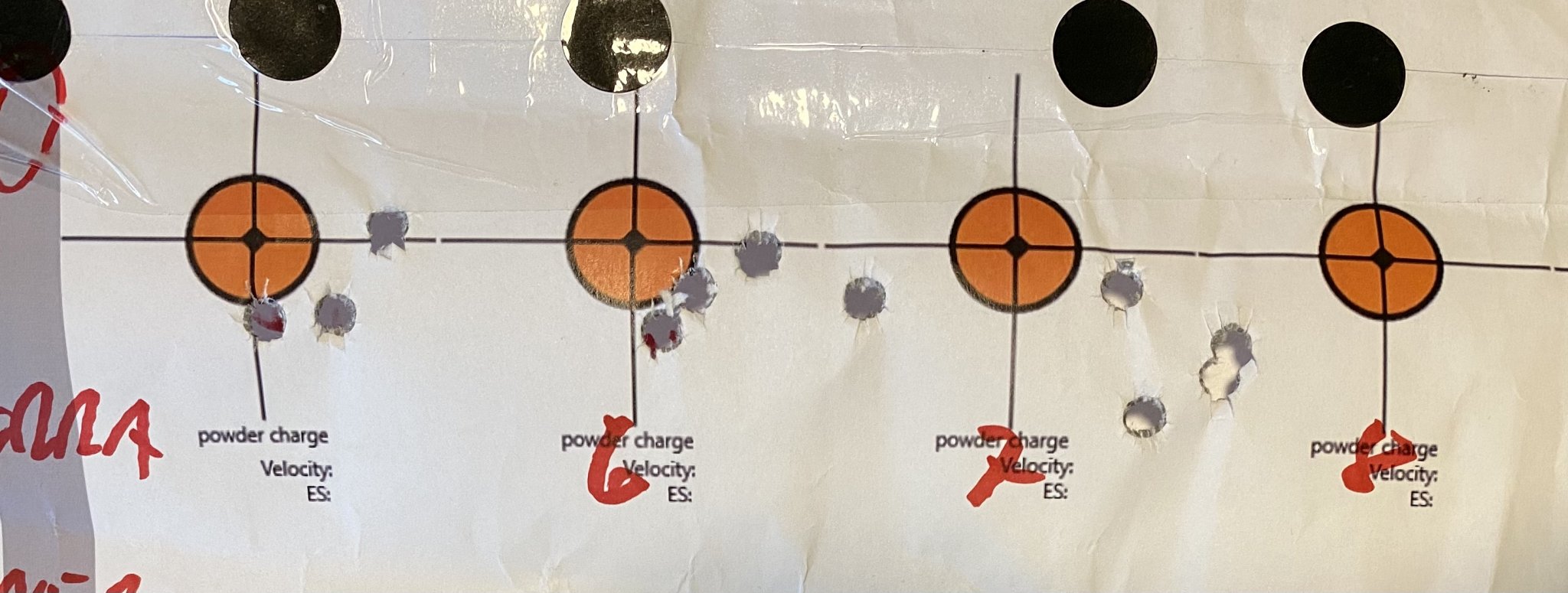

Hi guys,
yesterday I went shooting my 300 PRC B14 HMR Bergara for final tweaks of the load with tuner brake....it was the very same indoor range as always, same distance, same temp., logically no wind, same shooting position, scope, optics...I'm quite confident that like nothing regarding rifle and environment has changed. I was shooting batch of handloads with exactly the same specs as the load before. I compared those two batches and everything seems to be the same (CBTO/COAL, primer depth, whole procedure totally similar, same powder and batch of bullets, primers), but didn't have the time to try previous load again. To my surprise, some fine tuning with EC tuner brake (which previously gave me good results) wasn't at the table as the groups totally scattered from I'd say decent ones to this failure. I put pics of the previous (working) load target and this failure. Any ideas what could have cause this? I'm even more nervous about it as I have some local comp. next week:(
Thanks a lot in advace and have a nice day.
Best,
T.

Are you saying that the only thing that changed, that you know of, was the tuner setting?
Oh I forgot to mention I tightened 2 action screws, but according to recommended torque from Bergara and discussions on the internet, and they really weren't loose.
P.S. even same tuner settings I have, for example those marked with "6 on the pics are the same (EC tuner brake setting)
Well honestly, it wouldn’t be the first time that action screw torque made a difference in group size. I can’t say that is your issue, but if it were me, I’d at least try backing those torque values back down to where you had them and see if that makes a difference.
