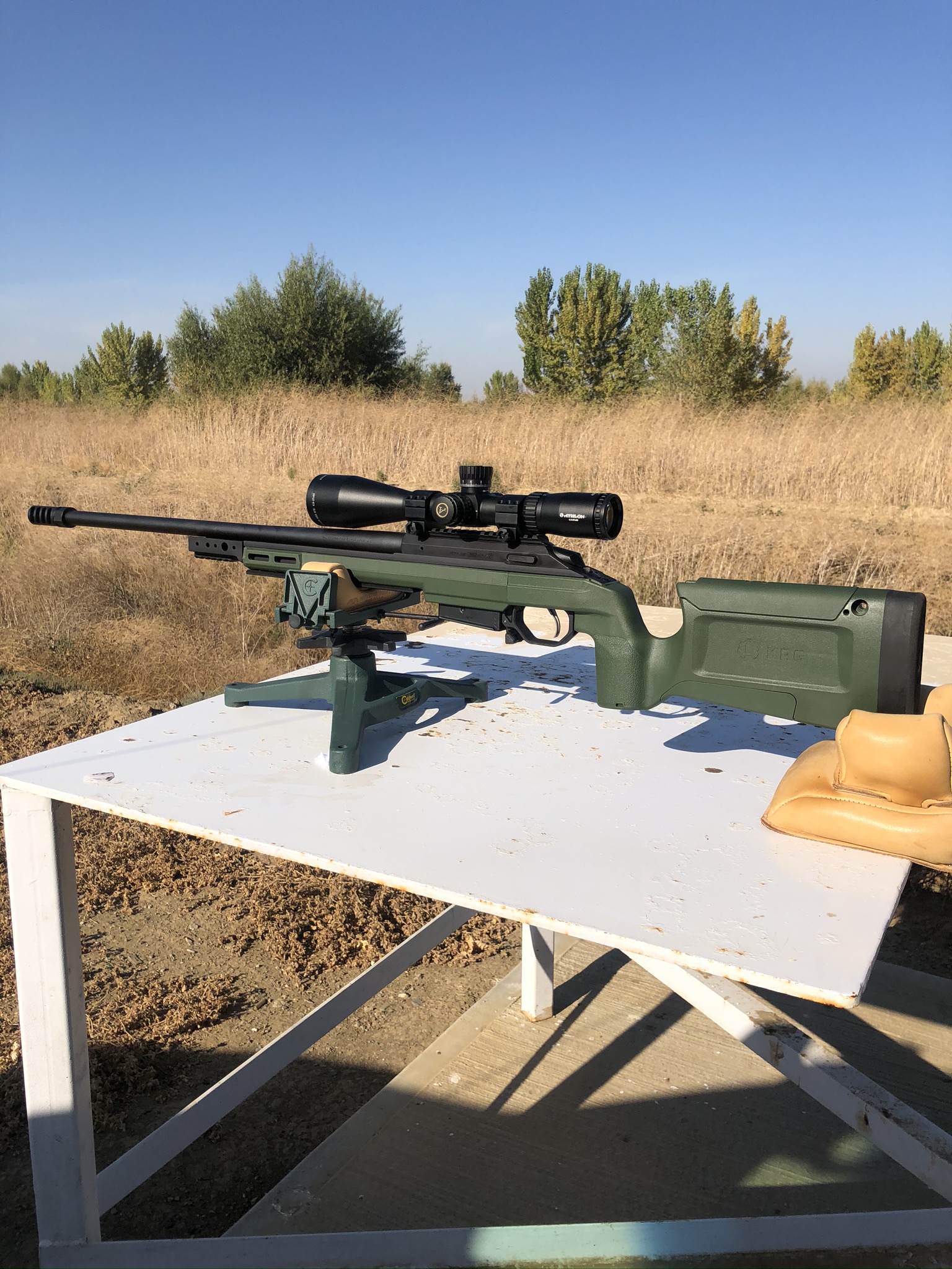

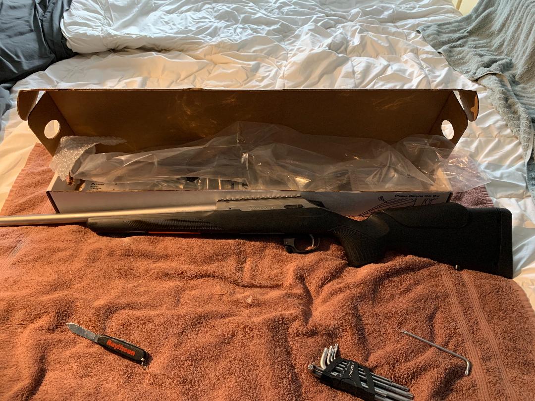

Although I have not taken it to the range yet, I'd go Tikka. Kept hearing great things about them on here and was able to snatch one off the px. Bought the KRG bravo and put it in there. All for just over 1k (before and after pictures attached). Even snagged the exact barrel I had on order for custom build elk hunting rifle. Now I don't have to wait months for Proof to manufacture it :D
