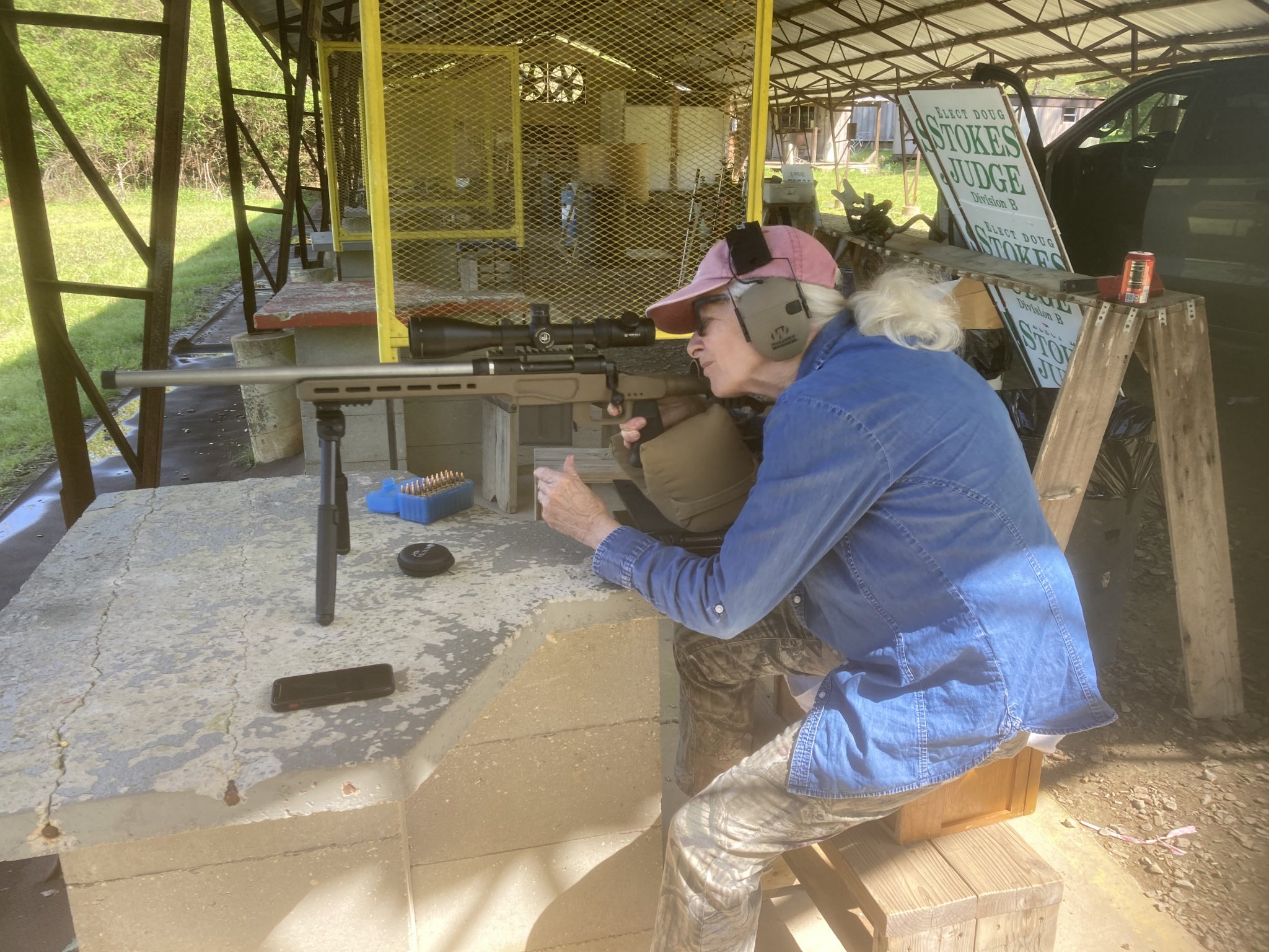

What a whole bunch of other’s are recommending. Will put this together for Brenda. While it is using a Savage action (with a custom barrel and a barrel nut) the magnesium chassis is light enough. I also like the idea of the 6ARC. Otherwise, go with any of the 6mm rounds currently in use. 6 Creedmoor offers a lot of hunting/target options if a bit more power is desired and tolerated.
I keep telling Will III and Brenda that the little rifle is begging for a brake, but they say its just not necessary.

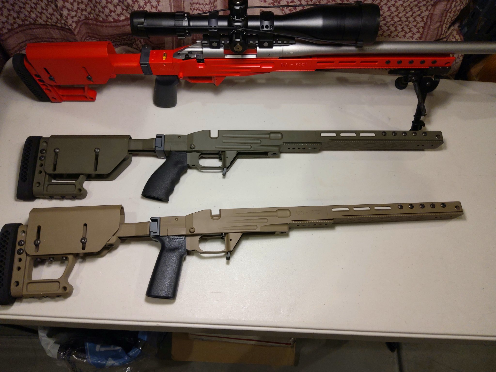

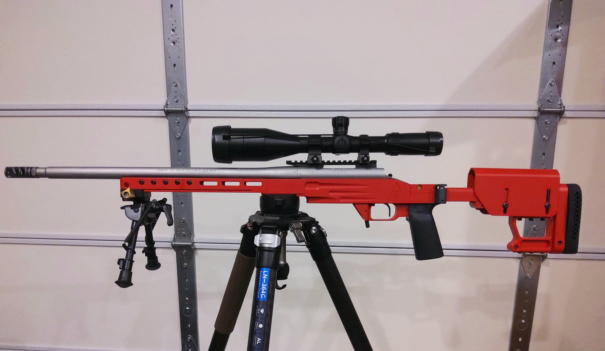

Bought this for the wife but she likes the Ruger 22LR better.. Rem700 5R stainless .223. Will pay for itself with ammo savings over the 6/6.5. Longer barrel life as well.. With a 5LB chassis and a brake, very easy shooter.
