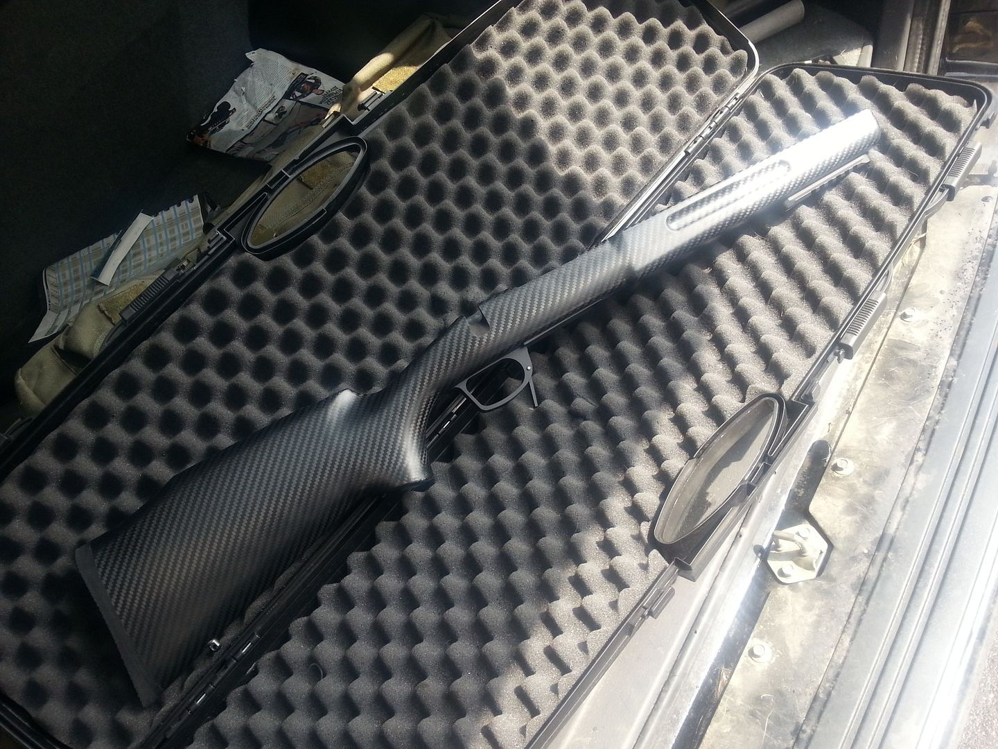

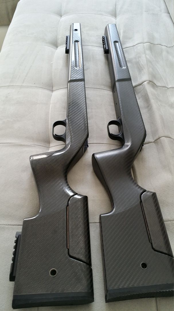

I just got a manners t6a elite carbon, tikka t3, benchmark fluted rem varmint and a leupold mk6 in 6.5x47. Should be fairly light for a match rifle and still fully capable. It'll be done in a couple weeks. I'll let you know the end weight and how it is in a match.
