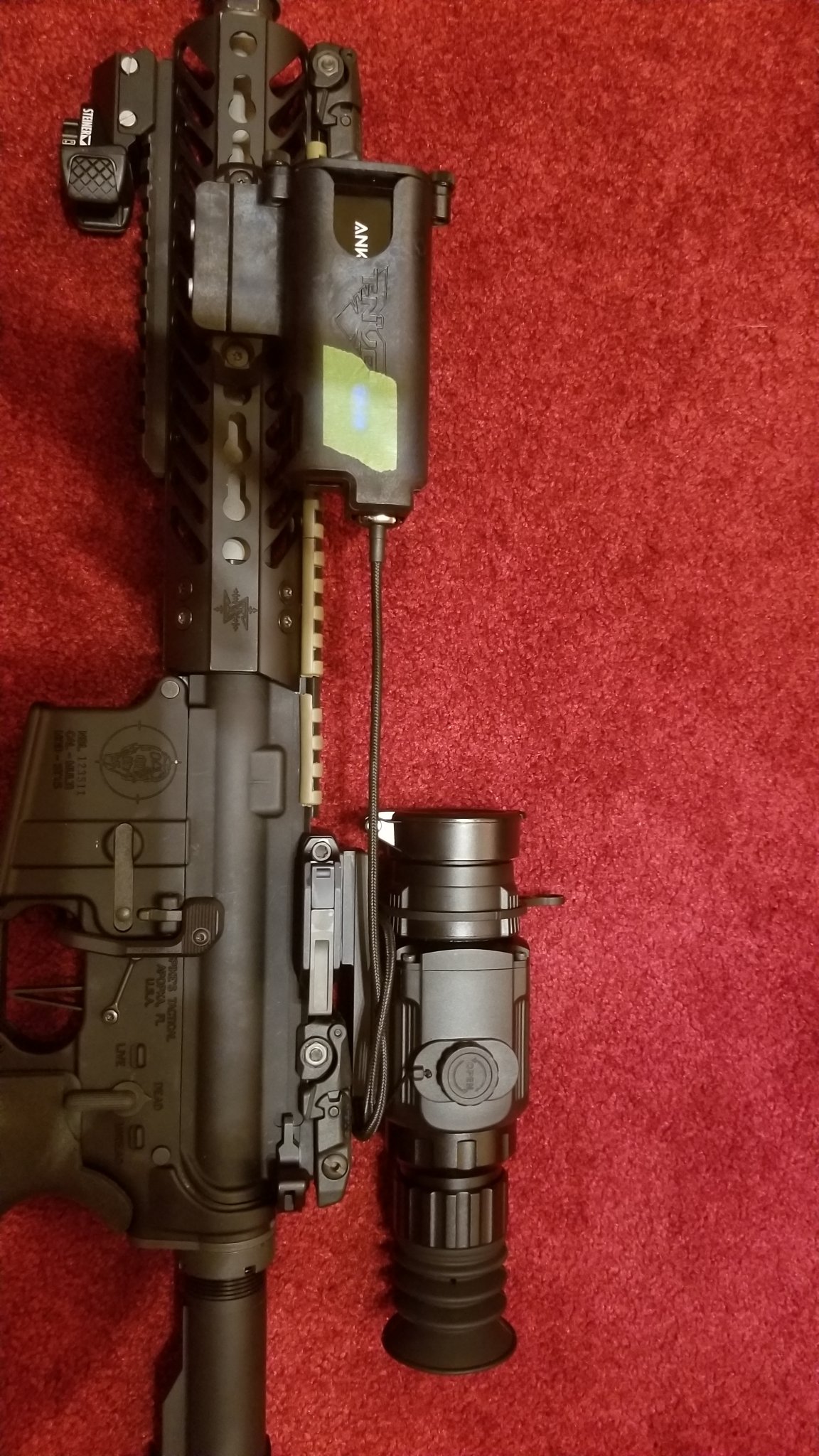

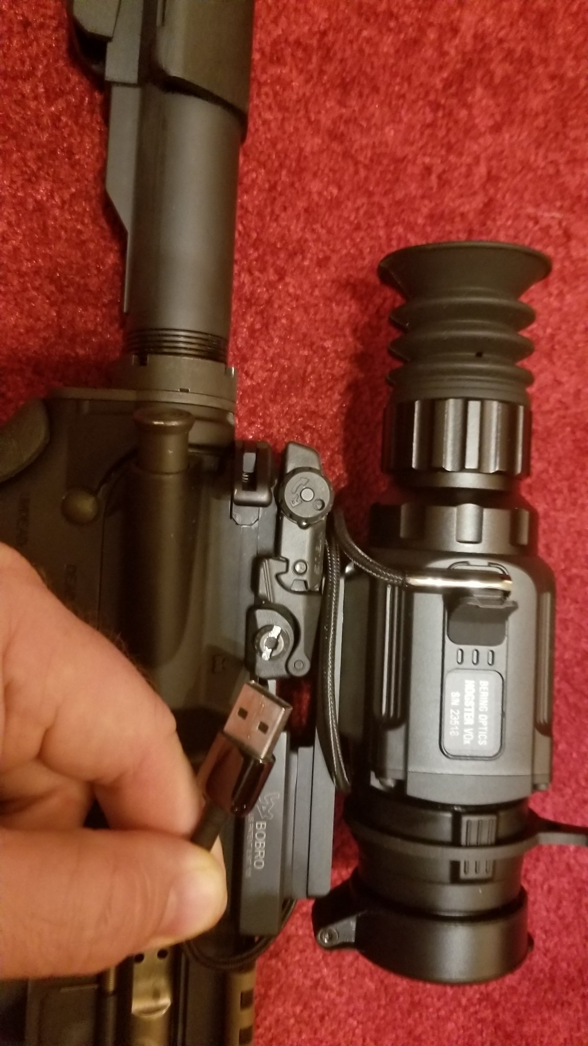

They can use any external battery.
This is setup with a battery attached, but I also have a clip-on and run with a 6ft cord and battery in my pocket.
If you turn the unit on from internal battery and then plug in external battery, it will stay on from internal battery if you discount the external one.
This way you can just unplug if you need to move quickly.
