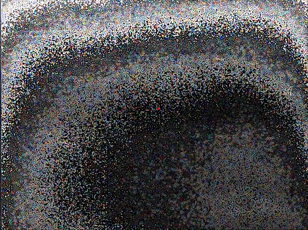

Last night the Yoter was performing as expected for most of the hunt, and then it did a normal auto-NUC after being recently powered up for a set. Maybe 3-4 nuc's in and it glitched just pre-NUC, it super pixelated the whole screen for a second or two prior to the NUC, the nuc (I have typed NUC a few times now and my computers autocorrect really doesn't like it) seemed to clear it back up but the picture did appear to not be as clear as it was before the glitch.
I was hoping it was a one time deal, but it proceeded to occur randomly for the rest of the night. It did get down to 4°F for a while, and in attempt to confirm it wasn't the cold (well above listed min temp) I left the rig outside today for a couple hours in about 25°, fired it up and it glitch once in about 7-10 NUC's.

One thing to try is once it happens, try a quick manual NUC. Hold down the two buttons closest to you. If it clears it up the image, great. If it doesn't close the end cap, hold down the first two buttons with a long push (3 seconds or more), and keep holding until the graphic to close the end cap goes away. This is a background NUC. If the first doesn't clear it up, the 2nd should. As I mentioned before, I would recommend sending a message to Bering ([email protected] or [email protected]) for anyone experiencing this, so they know it is happening to more units.

Mine were only a split second longer that a normal nuc. It wasnt a problem unless it happened right when i shoot.
It is associated with the NUC, so if your count-down timer (5 seconds) is not showing in the corner, you should be good.
Mine is back at Bering for them to look at for this issue.
I will say mine would do this even with auto-nuc disabled. I don't like auto-nuc since my luck makes it happen when I want to shoot!
I suppose my issue could be different as my screen would display the static for 1-2 seconds and THEN I would hear the auto-nuc shutter close and it would nuc without any I put from me. Struck me as the firmware recognizing and error had occurred and was correcting it.
It would do this every 10-15 minutes for about an hour. Made me think it had something to do with the scope coming down to ambient temps, solder joint and case shrinkage kind of issue related to temperature change.

I issue occurred twice that I noticed, this is post factory reset that Bering advised trying.

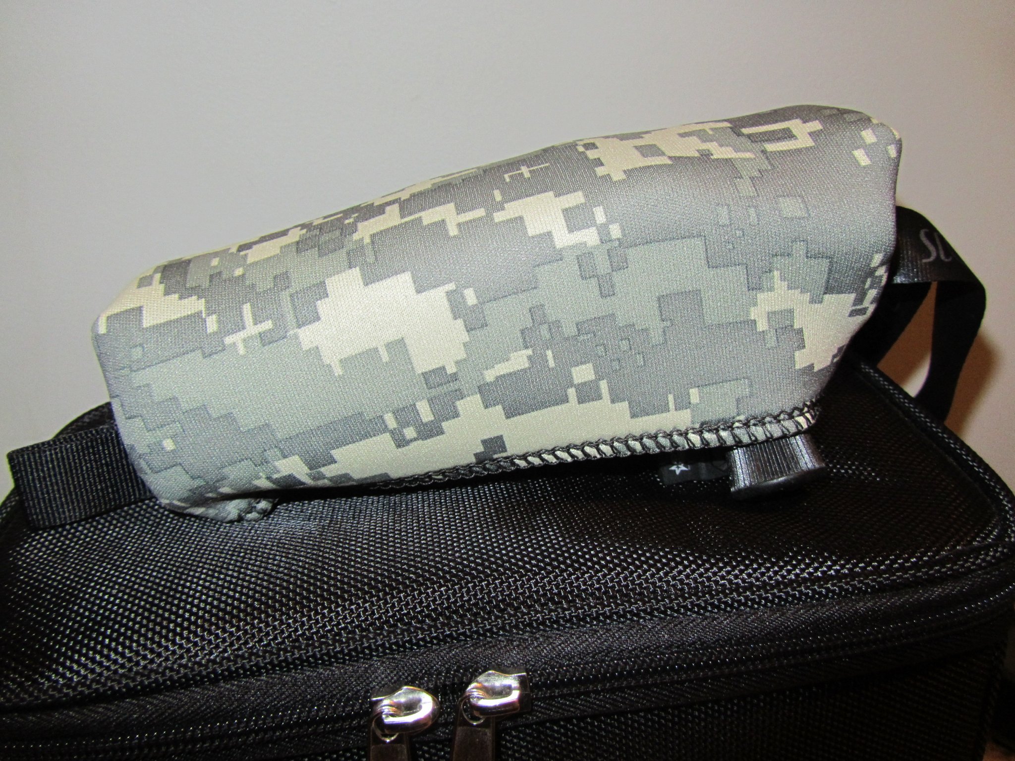

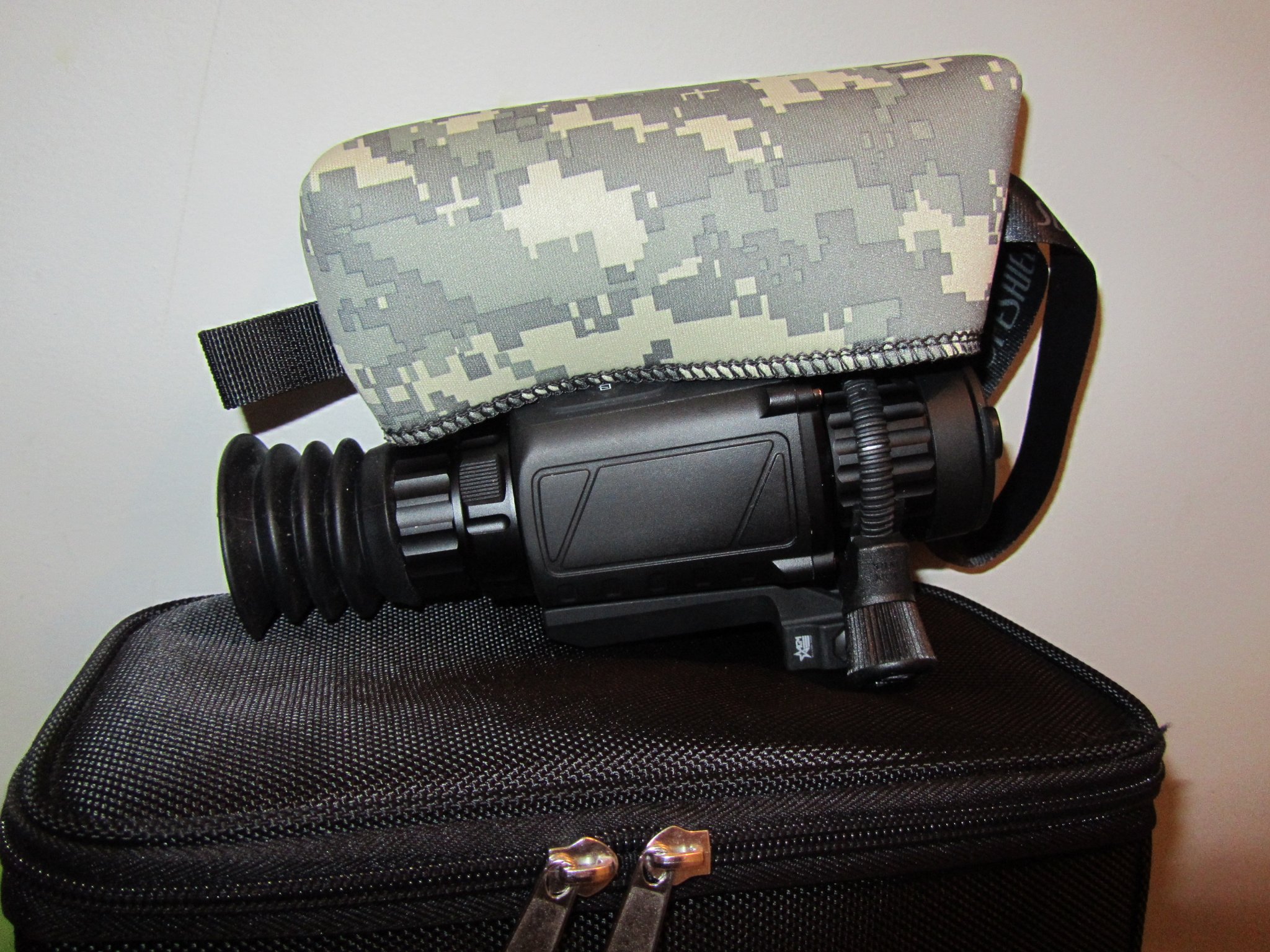

I would try insulating around the eyepiece with some closed cell pipe insulation or get some type of neoprene scope cover to try and keep the display from freezing.
I always have a scopeslicker cover on my Thermion while it's sitting idle or in transit and if you look at the scope with another thermal, it has a hotter heat signature while it's covered.
It's made for a tube style scope.
I have a scopecoat on my Rattler 25.
While I haven't done any severe cold weather testing with it yet and being it has an OLED display, I'm sure it'll have the same lag as my taipan spotter if left out in the severe cold.
Both of the covers are easily removed and have have some sort of tether.
I don't know if a neoprene cover will solve the issue, but it's a cheap way to find out.
The issue SuperYoter and others are described is not scope lag. It is something happening to the sensor/shutter NUC process as shown in my image earlier in this thread. I have sent samples to Bering and have recommended people send an email to [email protected] or [email protected] to report it. I have not heard if Bering has found a solution to it yet.
It simply acts like a longer NUC. If the display didn't get artifact looking, most people would never know it happened. It clears itself up, with some users reporting a minor reduction in image quality right after. Close the end cap, and hold the two buttons closest to you until the "close end cap image disappears". This should help the image quality. Hopefully, Bering will find an answer or solution to this, but the scope is totally useable this way. 250+ coyotes this winter have already found out how deadly the Super Yoter is by me personally.

On last nights hunt I only noticed the “stained-glass” screen once, but I did notice an extra long NUC without the crazy screen and it appeared that the picture was darker after that NUC. On a previous hunt it occurred 4-5 times on a single stand, so maybe 30 minutes of run time. So it is a little hard to point fingers as to what is causing it.

Well, still does it.
If anything it's worse.
Before it only lasted a moment and would auto-nuc to clear itself. Now there's no auto-nuc and I have to manually clear it.
It's definitely something related to the display as everything on the display was garbled, even the menu.
Out of curiosity, do these match yalls? I'll try and get a picture of the static screen next time it does it.

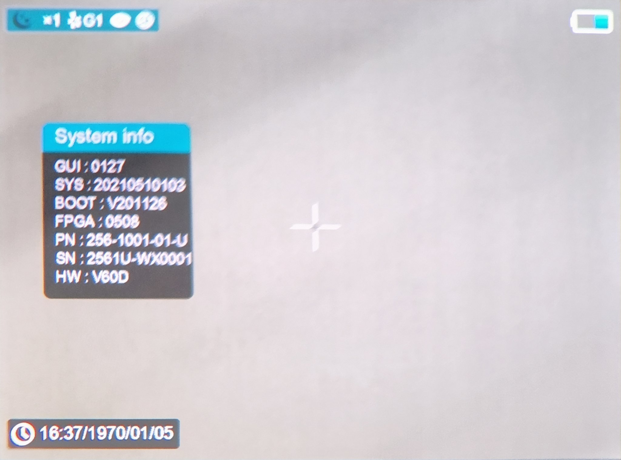

Well shit, I was hoping that Bering would have handled it on the first attempt. One of the reasons I went with the yoter was the reports from multiple sources that Bering had good CS.
I’ll take a look at my units version info in a few.
Thanks for the update.
